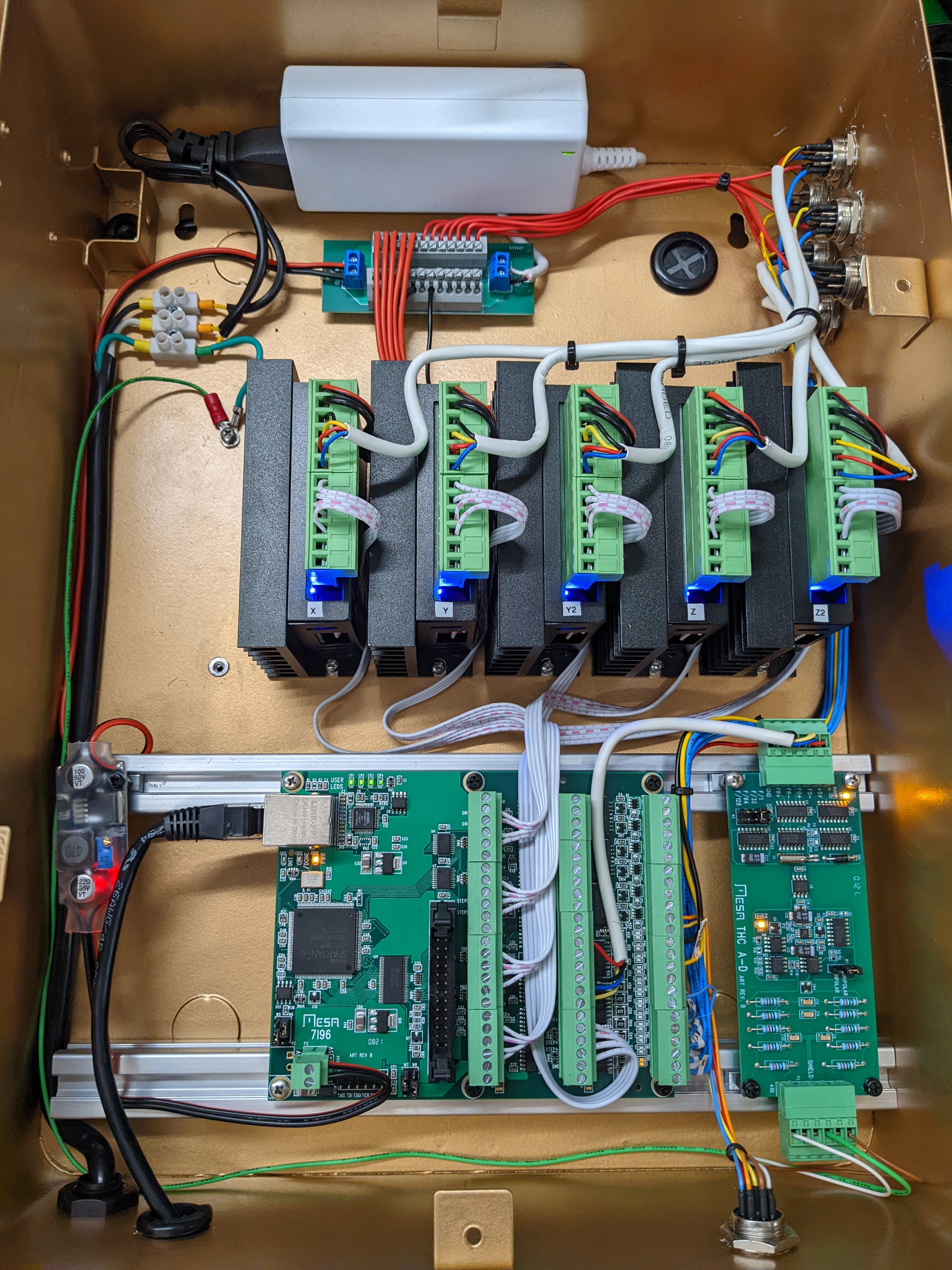

Pretty lights…and back in business. Motors are spinning and limit/homing switches work!
Might have to do a torch test.
Looking clean!
What power supply is that? And what’s that component on the far left? (Edit) oh that’s a dc step down for the 7i96
24v 2A, we’ll see how it does.
looks like I can’t test the dual axis without homing them. I only soldered up one pigtail so those are going to have to wait. Everything seems to be functional, and setup is a little easier now than the instructions you wrote, the thc-ad now has a calc built in.

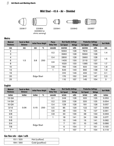

Are there any cut charts for your plasma machine?
For a frame of reference my hypertherm powermax 45xp cuts at between 128 and 157 volts. But the real thin stuff cuts around 70 to 80 volts.
Oh, so I put in the scaling numbers and the display is doing the math and showing the real volts not the actual input? That sounds right then. The charts I have do not have that much detail.
