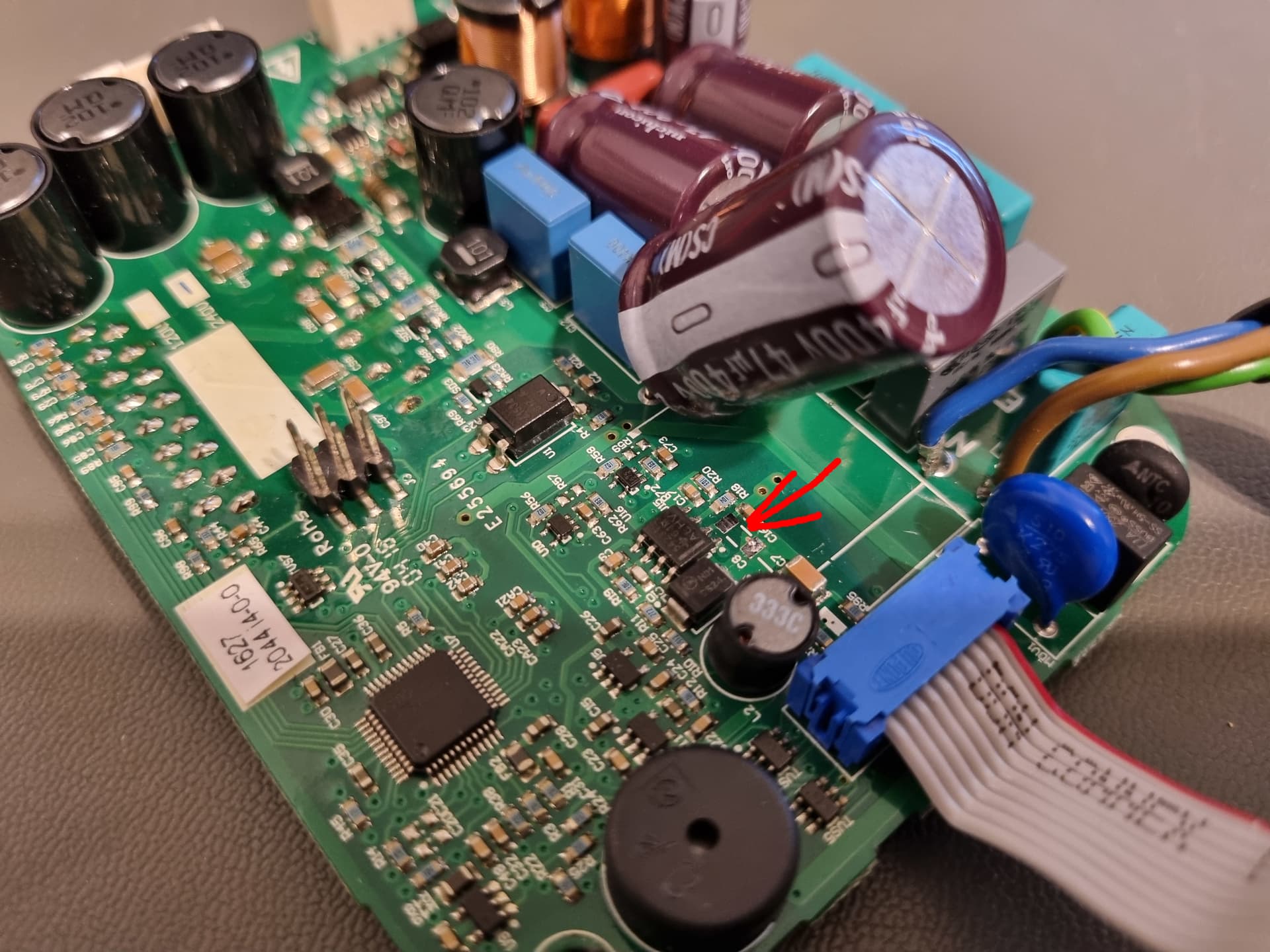

So, @bitingmidge sent me the controller and it arrived late last week. I spent a bit of time looking over the board and probing around at things. What I thought looked like a dead FET and diode in the photo was actually just the red glue-spots from the components being mounted on the bottom side. Both the FET and diode tested fine on a diode range, as did all the other discrete diodes, the bridge rectifier, the fuse, the NTC inrush resistor, the MOV, etc. Just to put everyone’s mind at ease, I checked the electrolytic caps closely and with an LCR meter. All 4 showed the correct capacitance and reasonable ESR values, which was somewhat of a surprise given I was measuring them in circuit. Either way, I can’t see anything that would indicate that these caps are getting any reasonable amount of ripple current and they’re long-life 105degC caps so wouldn’t expect an issue there.
During the probing around, I couldn’t find a continuous trace from the phase input to the bridge rectifier. It turns out the incoming phase runs to the fan’s motor connector and back, presumably so it can go through a thermal fuse/cutout of some kind. I just bridged across that with a piece of solid-core hookup wire.
I ganged up a couple of bench power supplies and applied 60V to it with no noteworthy result. The DC link came up as expected but it wasn’t enough to start it switching.
I then tried running it on 230V via an isolation transformer (critically important if you’re going to be poking around at mains voltage electronics, in my opinion). It started making the periodic clicking noise that’s common when power supplies fail to start and go into ‘hiccup’ mode. An isolated HV probe on the FET showed that it was switching cleanly for a few hundred us every half a second or so. I probed around a bit more and found what was likely the extra-low voltage supply connection. It showed a few hundred mV rise on every hiccup but nothing more which led me to conclude that something was likely shorting out the ELV supply.

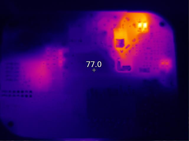

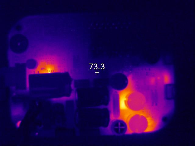

I grabbed the thermal camera and had a look around. Spotted a single hot spot that was separate from the part of the board with the switch-mode power supply on.
IR_00231
The lower right is where the SMPS components are. The upper left is the unexpected hot-spot. Ignore the temperature datum in the middle, I forgot to turn it off and it’s in Fahrenheit… Blech.

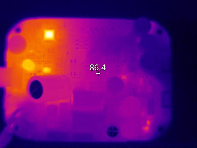

IR_00234
Underside of the board showing the SMPS in the top right with the hottest components being the MELF shunt resistors for the switching path. The bottom left hot spot is the the warm part of the plane under the unexpected hot spot.

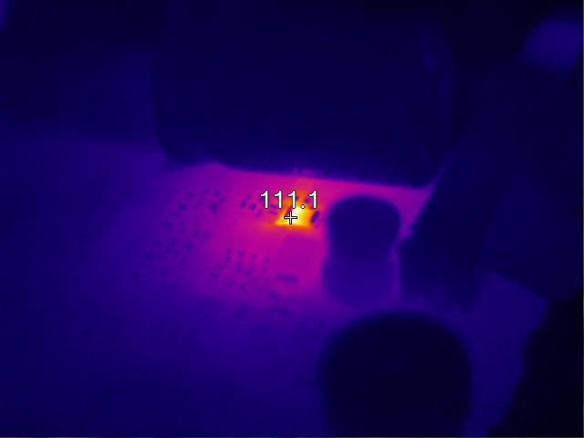

IR_00232

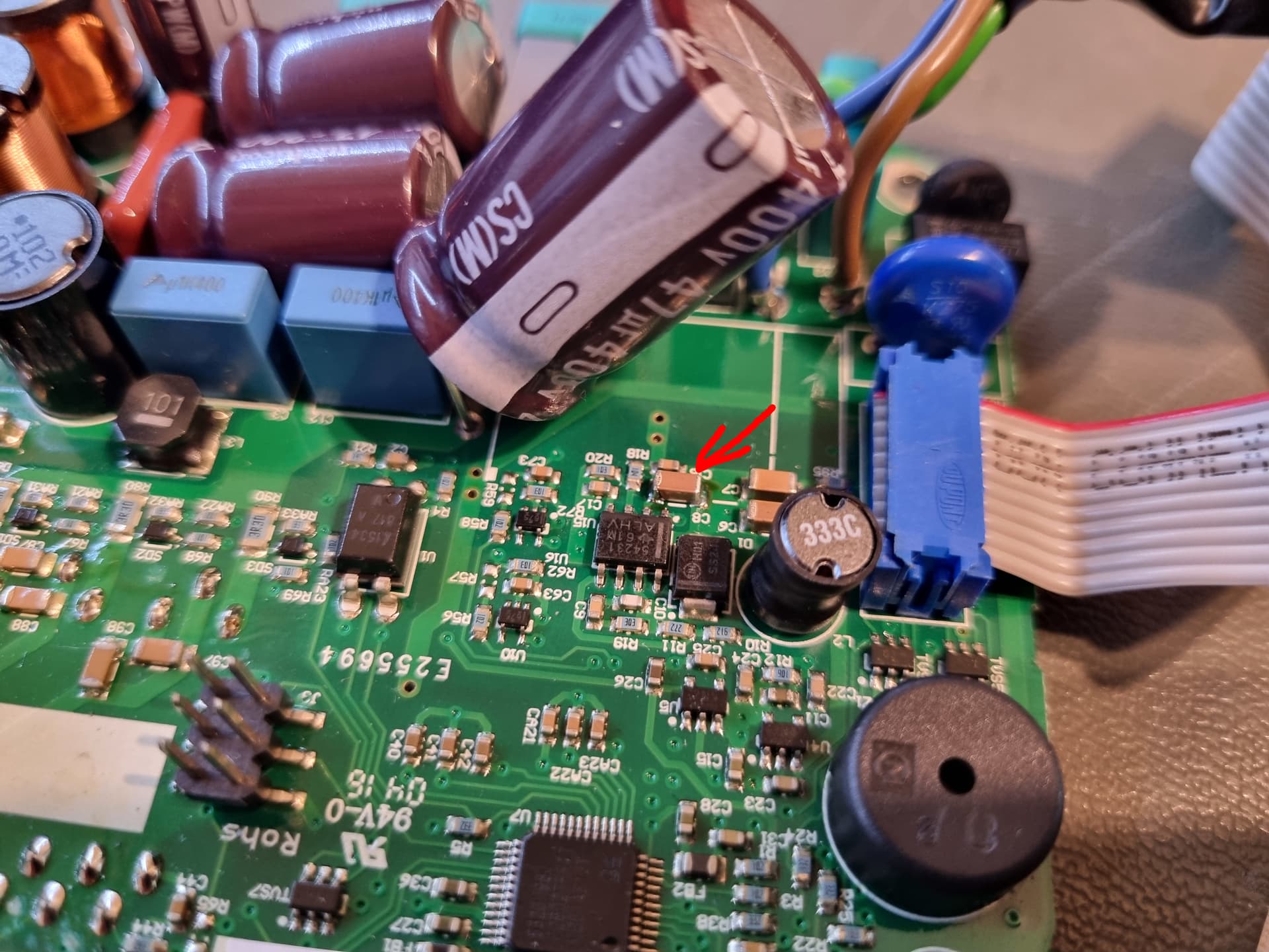

On closer inspection it was a large ceramic cap, connected between a large trace and a copper pour. The heat is localized enough that it’s definitely the cap getting warm, not something else around it.
I probed the connections either side and found a bunch of common connections to other parts of the board, as well as a smaller cap next to it leading me to conclude that it was probably just a voltage rail storage cap.
I moved the big electrolytic out of the way and removed the cap. The red arrow shows where it was, didn’t grab a before photo.

I powered it back up and the board beeped once, no more hiccup noises and the thermal camera shows lots of other parts of the board getting warm as expected. You can see the controller for the secondary step-down circuit, a choke and the microcontroller as the warm spots in the top left. They show up pretty bright but in reality they’re at around 35-40 degrees C, so about where I’d expect them. I probed the pads from where I had removed the cap and there was +24V stable there, as expected.
I powered everything down, discharged the DC link cap through a resistor and then replaced the ceramic cap with a 10uF 35V X7R from my inventory. Powered it up again, made sure everything still looked fine. Powered it down, removed the soldered link on the fan supply connector, cleaned up the tops of the components that were mounted to the heat spreader plate, gave the thermal pads a check over and quick clean and then reassembled the whole thing. Ready to go back for testing!
