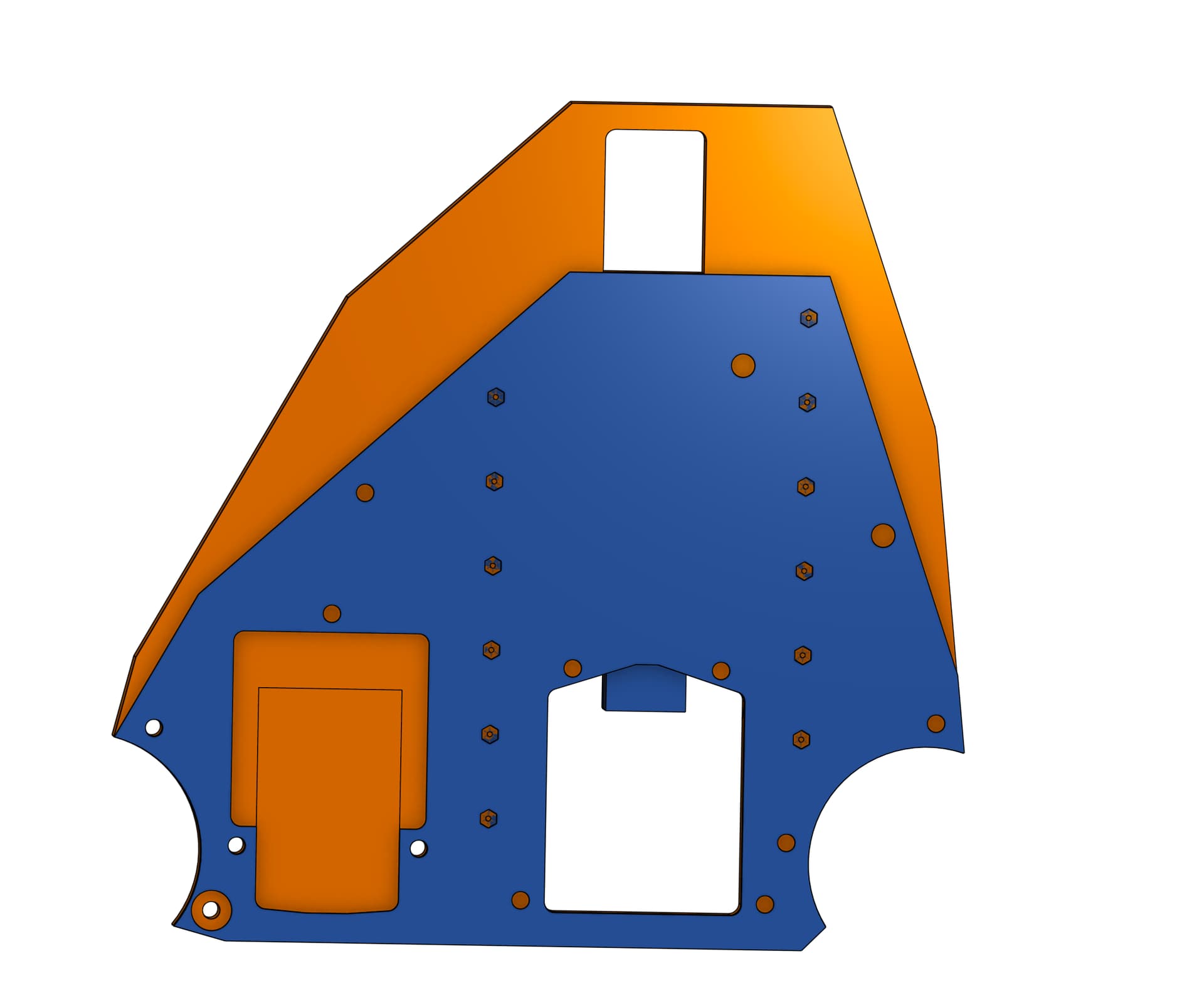

I’ve done my best to provide file sets for a variety of stock and tall YZ plates, plus the same in combination with my Hidden Belts Mod, plus the same but for “mirrored” LR3 machines like mine. Here’s a list of the file sets provided:
- Fenders, Hidden Belts Mod, stock YZ Plates (see 19mm notes)
- Fenders, Mirrored LR3, Hidden Belts Mod, stock YZ Plates
- Fenders for DougDan Tall YZ Plates
- Fenders for DougDanTall for Hidden Belts Mod
- Fenders, Mirrored LR3, for DougDanTall for Hidden Belts Mod
- Fenders for Dan Tall YZ Plates
- Fenders for Dan Tall for Hidden Belts Mod
- Fenders, Mirrored LR3, for Dan Tall for Hidden Belts Mod
- CLIP SPACERS for DanTall & DougDanTall YZ Plate Fenders
- CLIP SPACERS, set of front clips for Hidden Belts Mod
- CLIP SPACERS, set of Y-extend clips for Hidden Belts Mod
Peter’s “Clip Spacers” are included to make the fenders adjustable for a variety of thicknesses of YZ plates. Note that for the Hidden Belts Mod, the front spacer has to be 25mm shorter. There is a set of these shorter spacers provided for those doing the Hidden Belts Mod.
Hi doug, i have the normal size but with the hiden Belt mod Will
Here’s a quote from the Printables listing:
MIX AND MATCH OPTION:
I’m fairly confident that a LowRider with regular-sized YZ plates (not the taller ones) and also having the Hidden Belts Mod in place, could mix and match the normal top fenders from Peter’s original listing, plus the bottom fender and front (aka outrigger) fender from this listing, and get a working set. The mount clips would need to be from this set. For the Hidden Belts Mod, if the clip spacers are needed, then the back clip spacer is normal, while the front clip spacer has to be 25mm shorter. There is a set of these shorter spacers provided for those doing the Hidden Belts Mod. If any problems are encountered, let me know.
It’s definitely doable, and you try and run into issues, you can let me know and I can focus attention on it.
I don’t think that will work Doug depending of course on the profile of the plate.
My standard top part is OK, but your bottom profile is completely different because of the shape of the plate. I don’t think it would be difficult for you to modify my stock bottom though.
then your clips will work as well.
Seeing your contrast / compare image, I can see that the Y-extend fender (the “outrigger” one) will stick out too much at the front to get a perfect match. So I would need to do a remix there. Will work on it.
