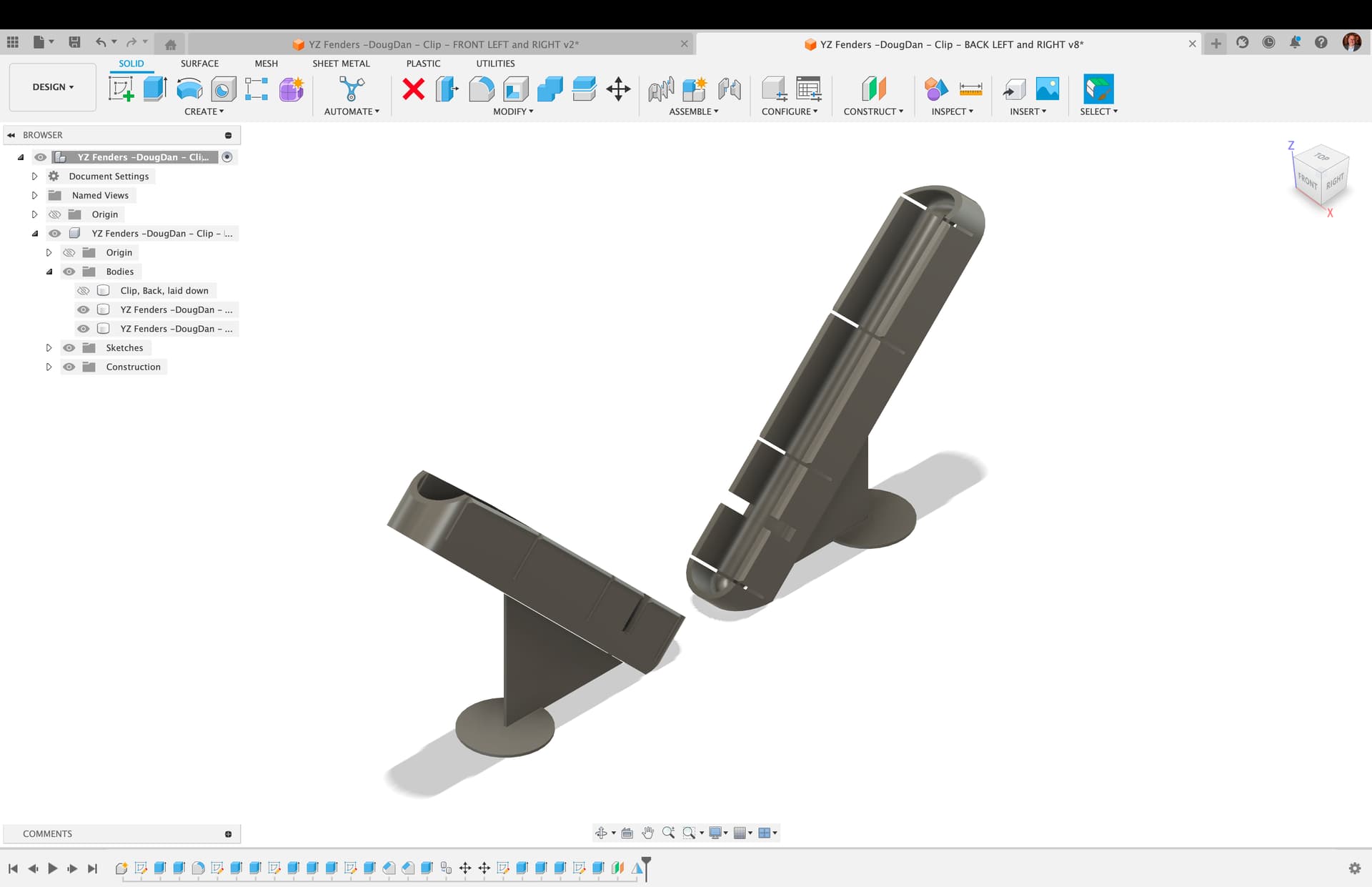

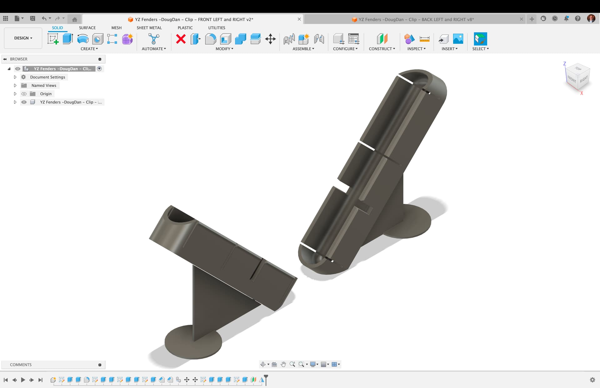

Attached is a zip file containing 45-degree printable clip files for my set (the DougDan Tall YZ Plate version for Hidden Belts Mod):
DougDan Tall YZ Plate - 45-degree printable clips.zip (657.9 KB)
Peter, I will send you my editable source for these files in a private message. They were created in Fusion 360.
:rofl: :rofl: :rofl: See, I told you! Thanks so much for this - whenever my Covid brain disappears for a bit I’m so distracted with other things at the moment that I don’t know who I am anyway! :smiley: I’m sorry to be holding you up.
I am going to add another d20mm or so to the fins just to give a little more leeway with printers that aren’t set up as well as yours and mine may be, but the “snap off” works beautifully.
You’re awesome and not holding me up. I’m just trying to help lighten the load.
That sounds great. I just completed a print of the first one, and the break-away fin does break off wonderfully.
Two tips for printing success with models like these diagonal clips that are tall and have a smallish footprint:
  1. A mist of hair spray on the print bed helps with adhesion.
  2. Printing only one item at a time reduces chances of the print head knocking an item loose from its footing on the bed. Most modern slicers, when slicing for only one item, minimize travel moves outside the item, as that would require travel moves back into the item’s profile, and those “enter the profile” moves are the ones that can bump a part loose from the bed.

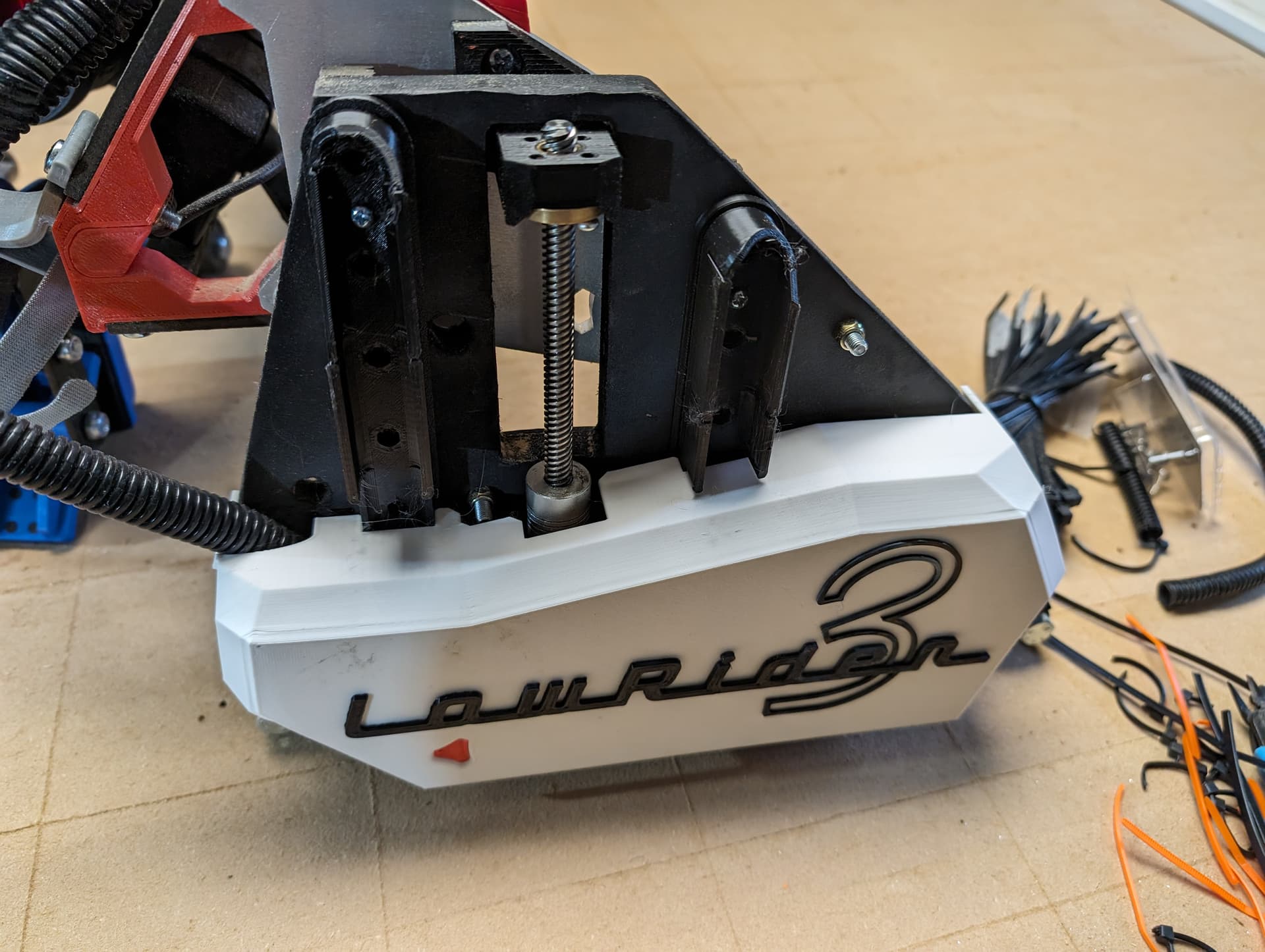

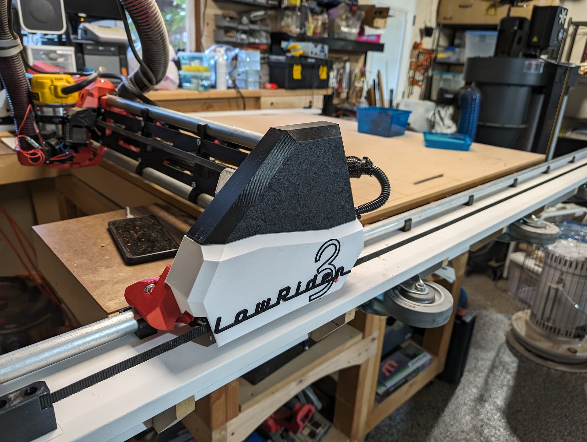

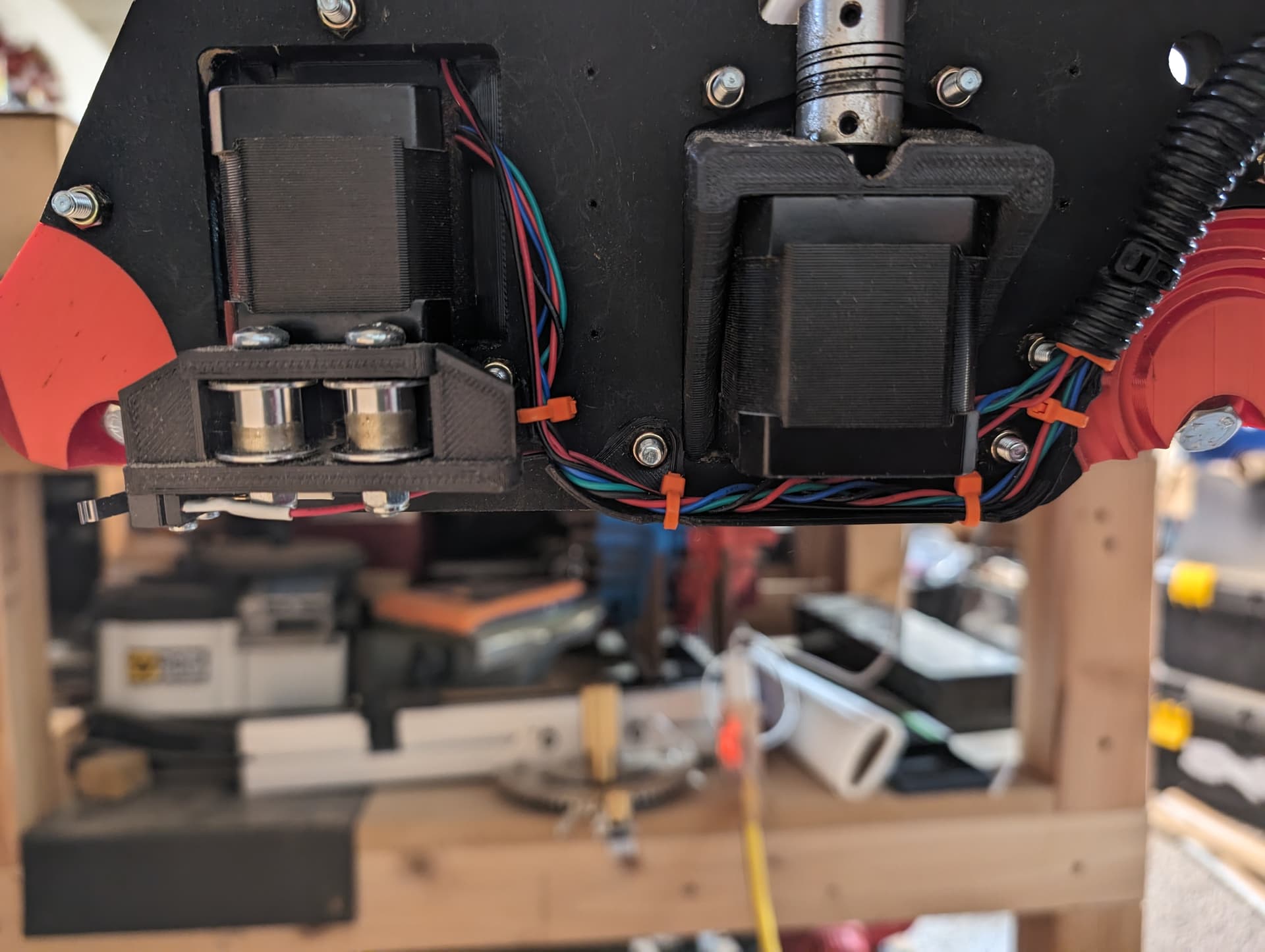

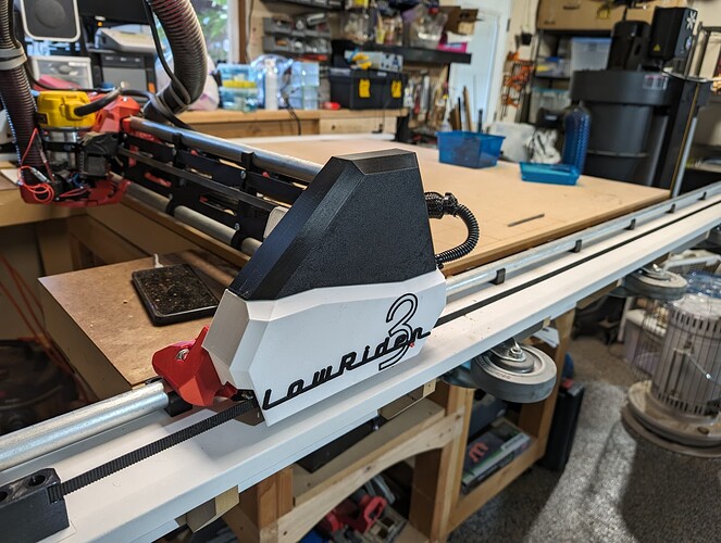

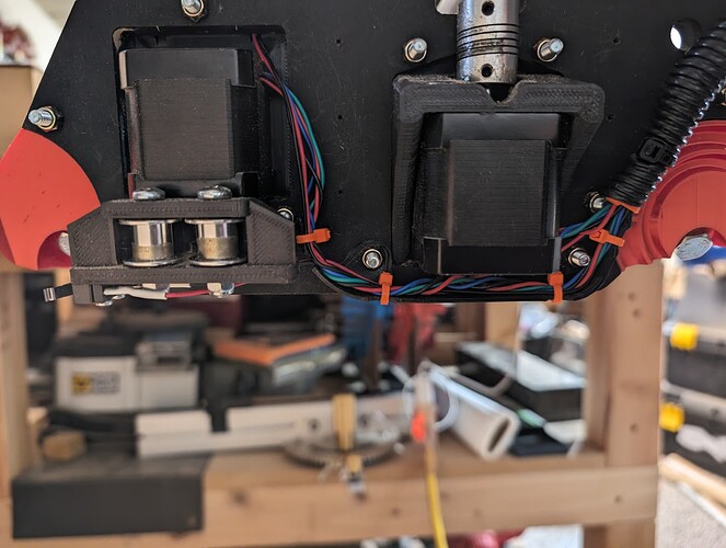

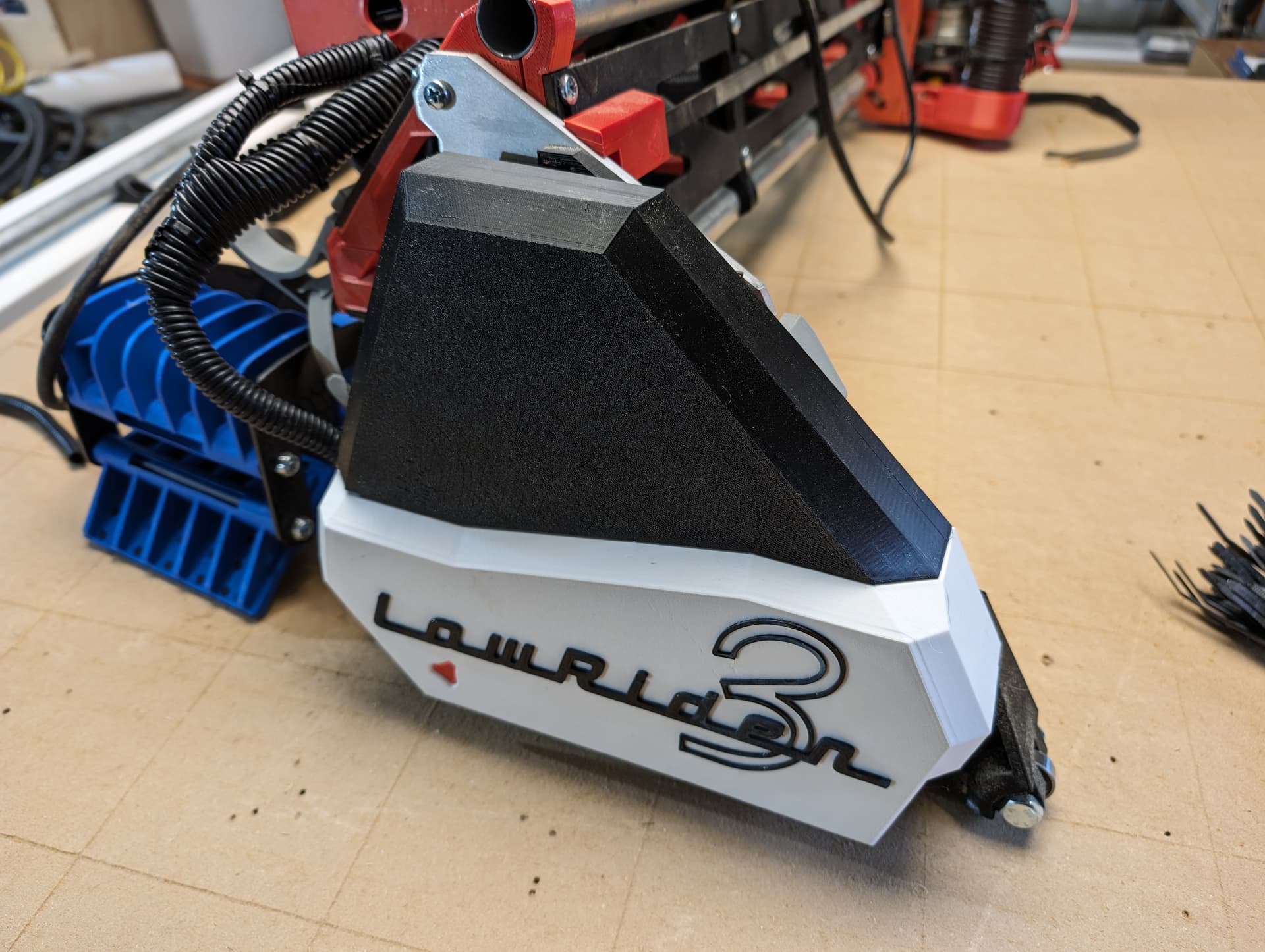

Everything in PETG. I did lose a few tabs but everything still holds solidly. Might reprint with Doug’s 45 degree action.
Posted my makes on printables.
My LR3 is finally “done” for now! Letting the chips fly in celebration…

OOOOOHHHHHH yes!!!
The cable tray and the fenders are top notch!
