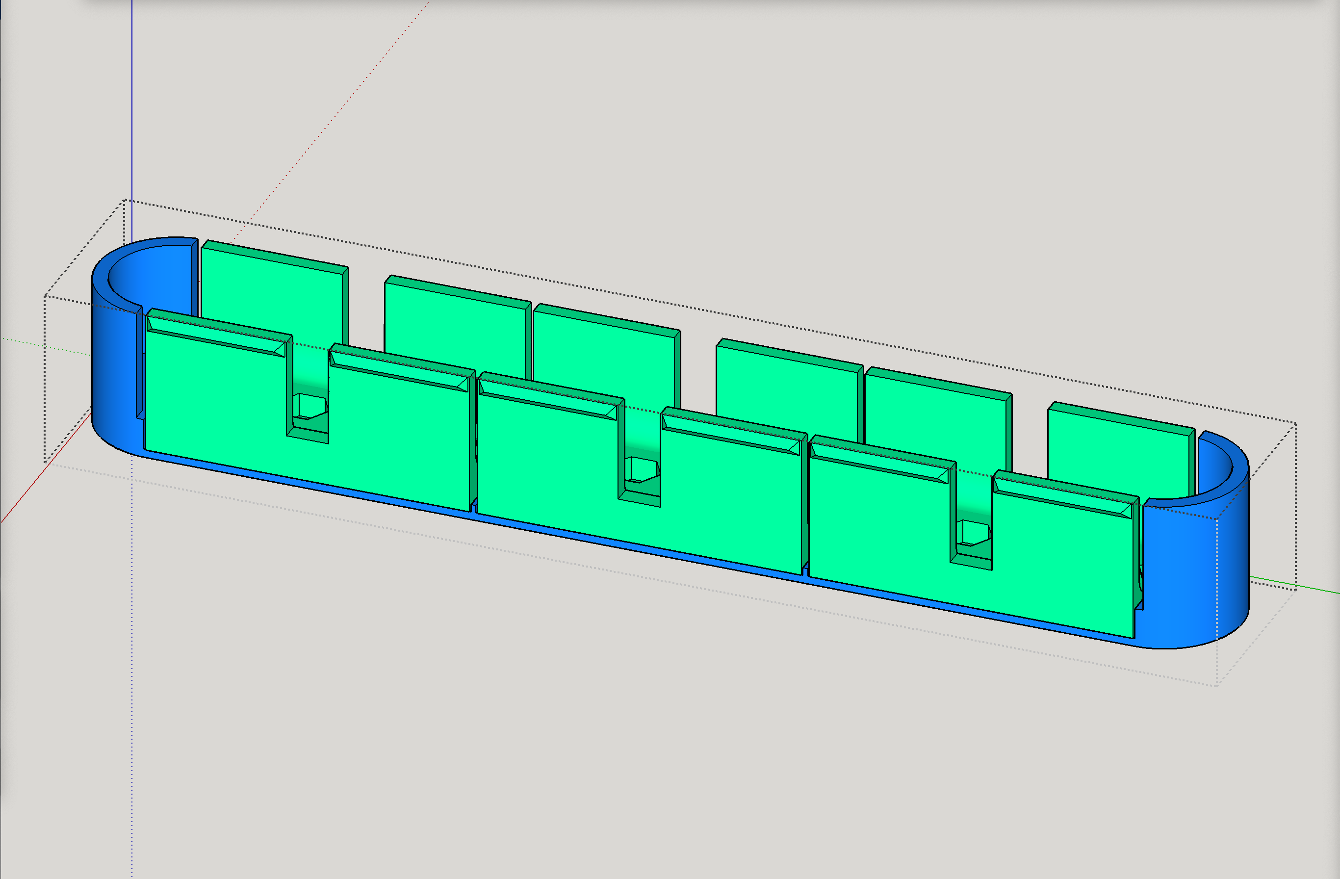

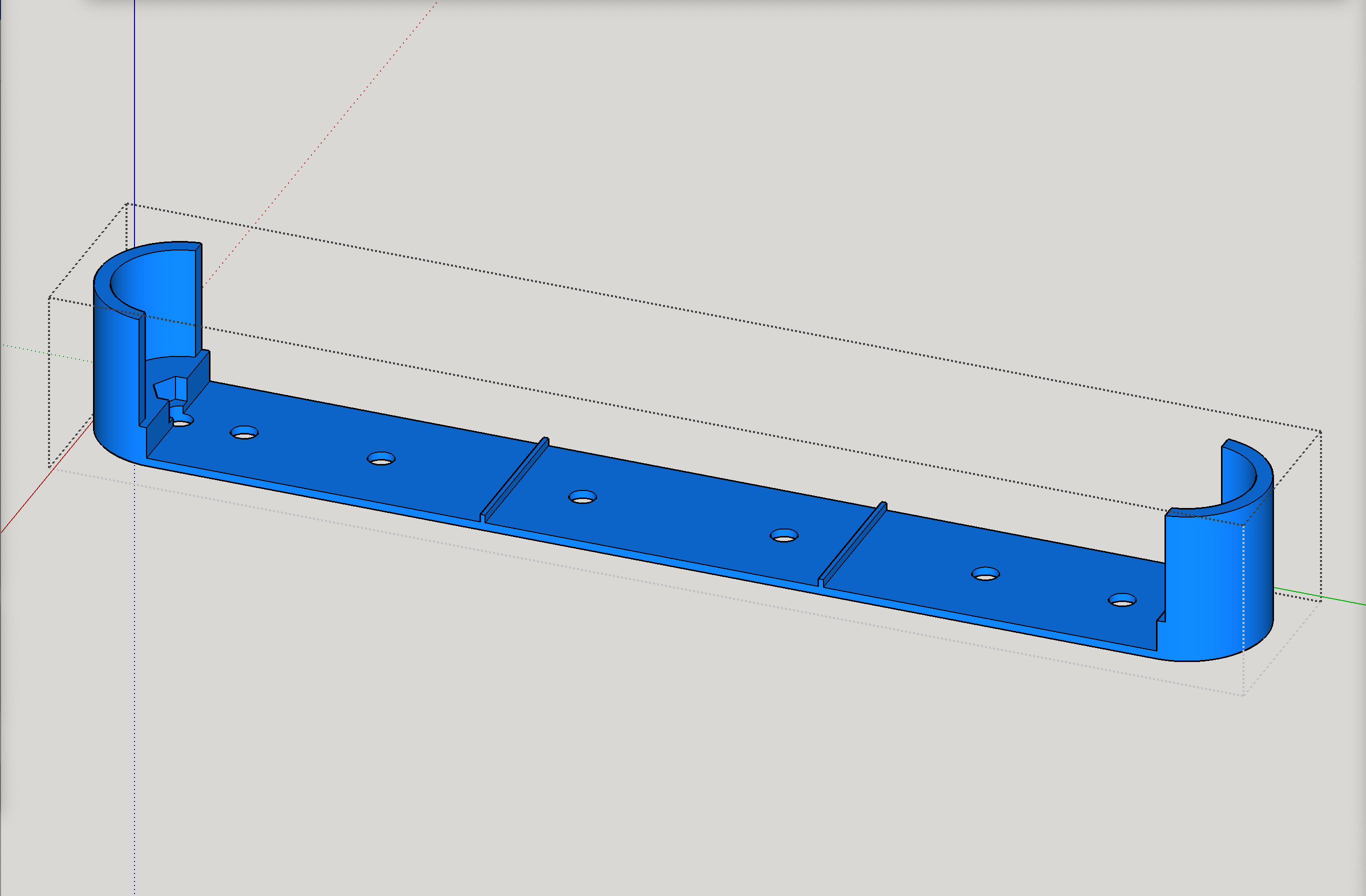

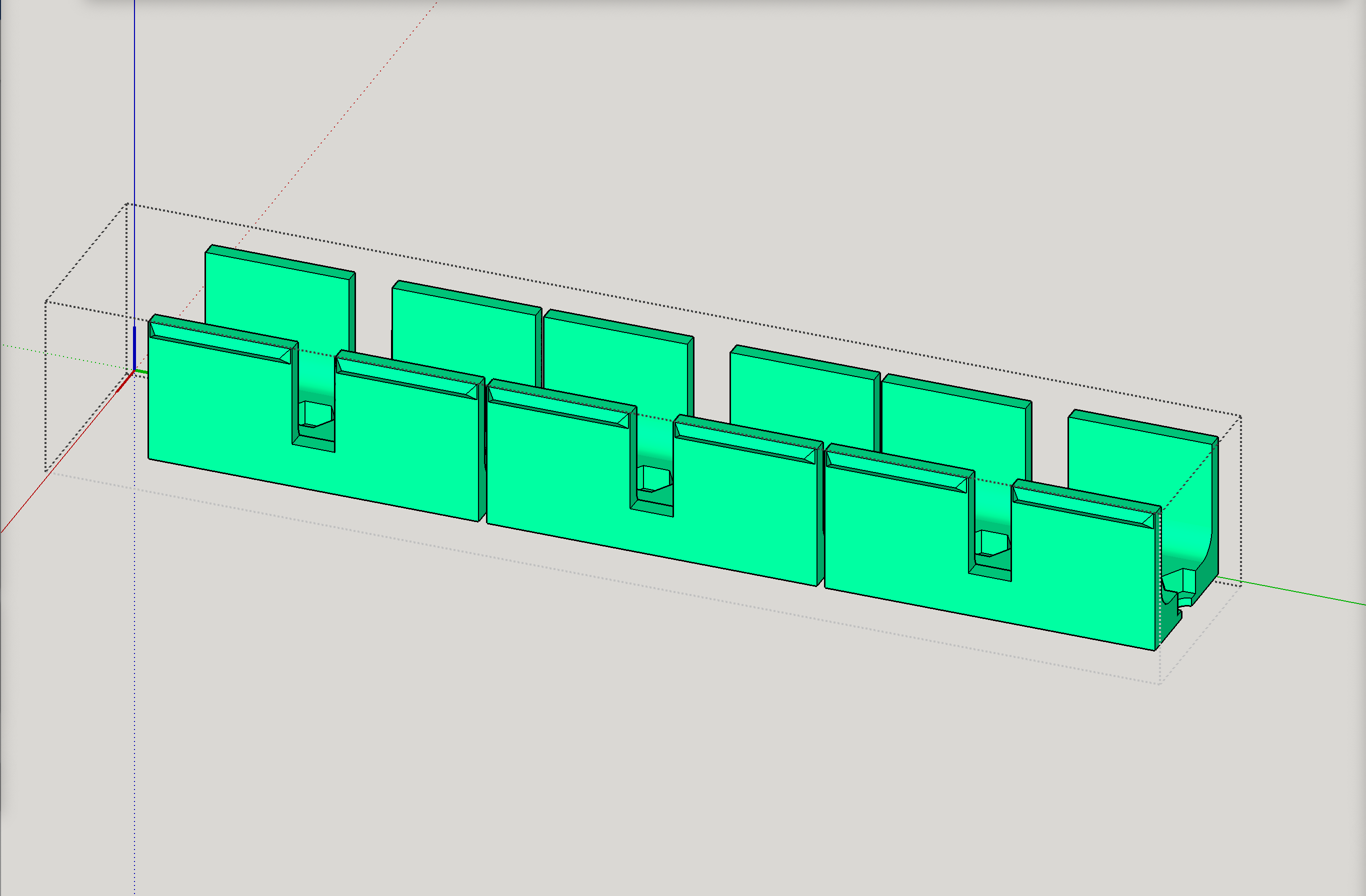

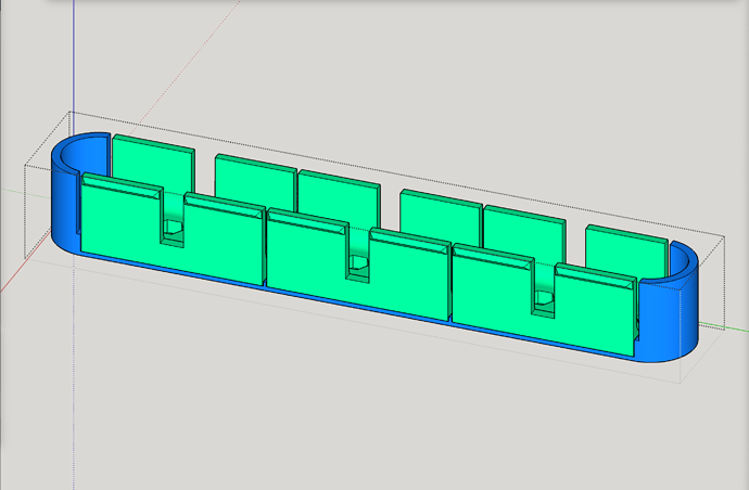

The mixed layer line version I came up with looks like this:
The blue is a base printed as shown…
…and the 3 green fin parts would get printed not like this, but rather standing up, then laid down like this when glued to the base.
It would perhaps be a little much to explain.

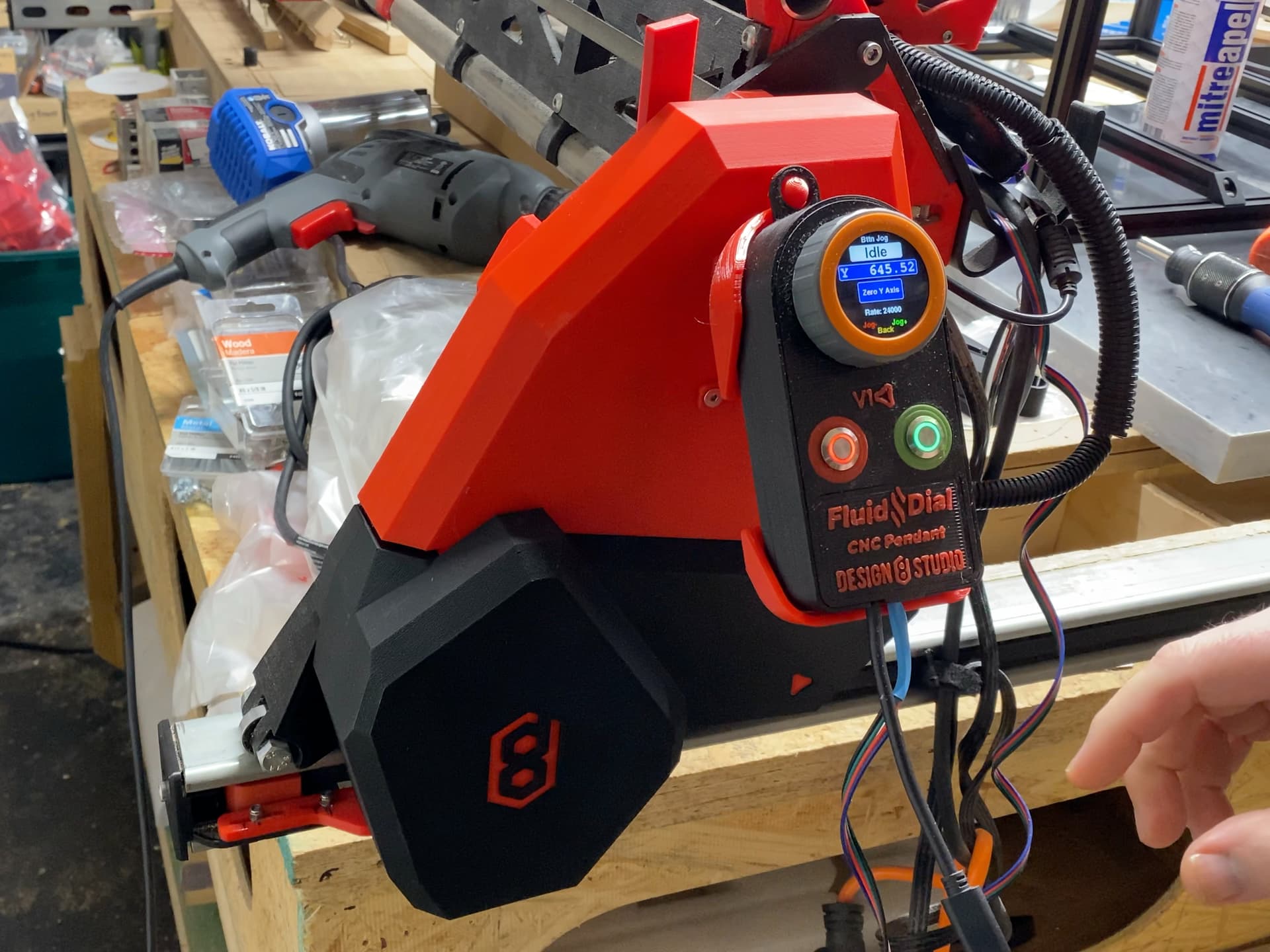

Peter, @bitingmidge, I have cobbled together a video documenting my experience making and installing these wonderful fenders. I will upload as “unlisted” and privately share it with you later today, when it finally gets processed by the servers. If you are OK with the video, I will make it public. In the meantime here are two screen grabs:
Dammit, it looked really nice. A more “professional” look I would say

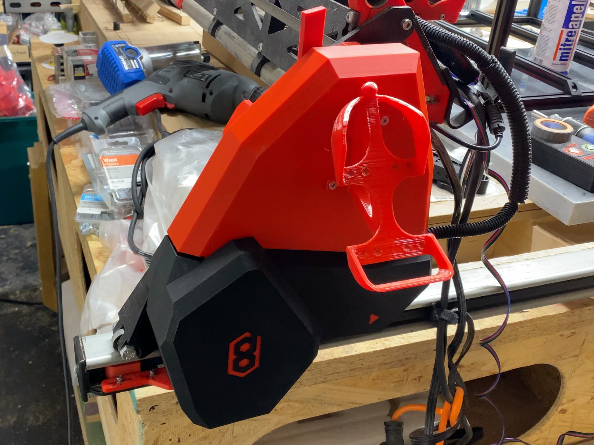

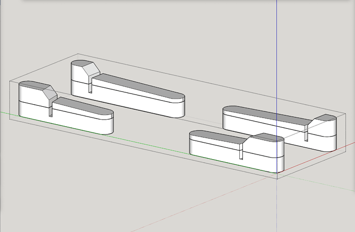

The clips in the video were printed in PLA, sliced laying down which meant the layer line adhesion weakness is an issue. I get no vibration. They work just fine, with the only caveat being, they don’t survive removal and reinstallation well. For that, I think some mixture of the following ideas:
  • Print at an angle (45 degrees) like you suggested, with minimal organic support or a break-away fin for support.
  • Print in TPU or PETG for more flex capability.
Alternatively:
  • Print my (not yet published or tested) design that has the base printed laying down, but the “fin” segments printed vertically, and glued to the base laying down. This should mean that PLA could be fine.

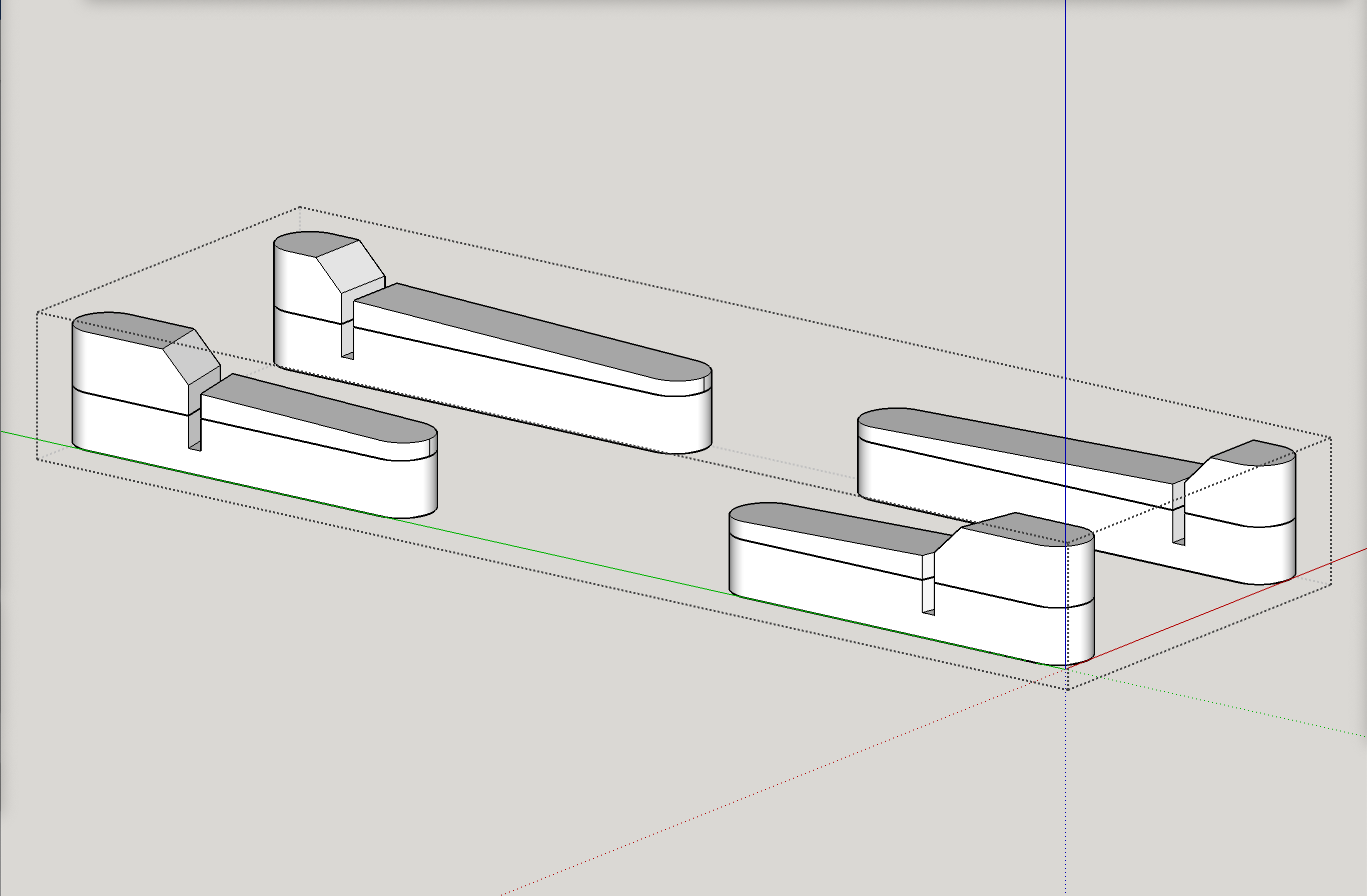

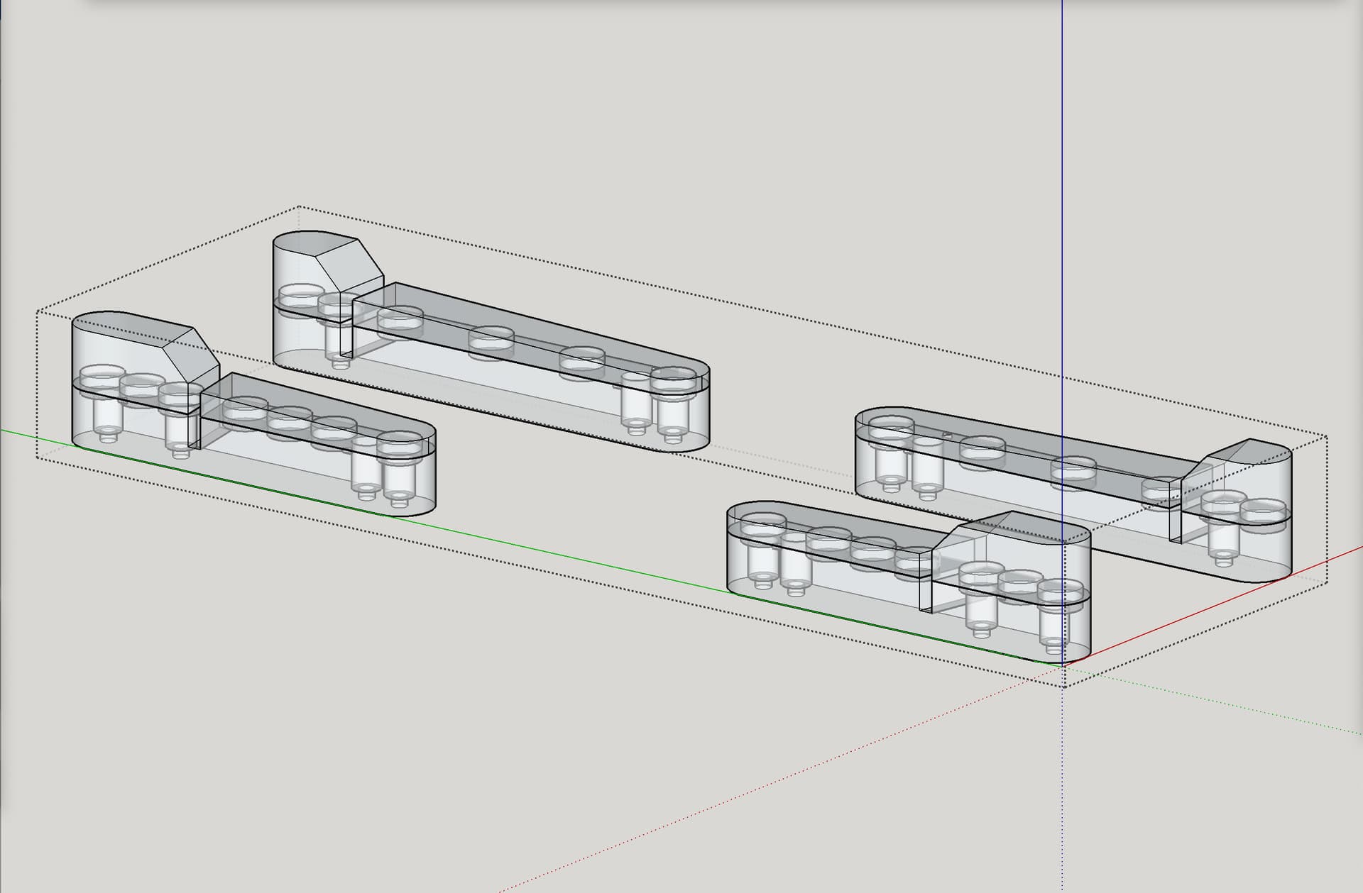

Just for doing it, I have worked up a design for new “MagClips” - and I’m printing it now for testing.
Designed for use of round 12mm x 3mm magnets, same ones I used on my Plasma LR3 “floating Z break-away” torch mount.
I currently have it designed for more magnet slots than I think will be needed, as after testing I can adjust to remove some slots, but leaving the option to add magnets during testing just in case.
These are designed to be backward compatible with the existing fender design — however, currently it’s for the set of fenders I have for “Hidden Belts Mod.” If the idea works well and it seems good, I can modify it for use with other “main line” fenders.

I just installed the printed ones in the modeling screen shots I showed above, and even though they had no nubs on them for interfacing with the recesses in the existing fender, I had to use a dead blow hammer in combination with a small socket driver, to firmly seat them into place. No glue was needed, and I seriously doubt anything can get them out without destroying the whole shooting match. If these don’t work, I would need to print another fender! I’m fairly confident they will work.
OK, so having now tried both the original design by Peter (“clips with nubs fitting into recesses”) and my attempt at magnets, although my mag-clip approach worked, I think I can say that Peter’s original approach is easiest and best, with the proviso that I would encourage printing the clips on a 45 degree angle with either some minimal organic support or a break-away fin for support, so the layer line adhesion weakness issue is not working against you letting fins break off easily. That said, I won’t be redoing the side I did with magnets. I will continue on like I am, with mixed methods, unless and until it becomes a problem. I did try one test of removal and replacement, on the mag-clip side, which worked, even if it was tough to get the top fender off. Honestly, I think the 0.1 mm clearance on the part that gets “inserted” into the fender, means it would have worked even if there were no magnets. :slight_smile:

I now have a test print of the 45° version - I can’t test install them because my covers are slightly different and at the moment I don’t have time to reprint.
I can say that even with only two perimeters they are noticeably better. I have only printed one - with a snap off fin and it worked perfectly with no other support. PrusaSlicer did throw up a warning that I needed more footprint so I’ll extend the fin for the share version. It snapped off perfectly cleanly with no effort with only three 0.2mm thick x 1mm wide tabs.
They are REALLY stiff so might need some effort to get them off, or maybe they are well suited to PETG, but I can deflect them by the thickness of the “clip overhang” and they show no sign of snapping.
