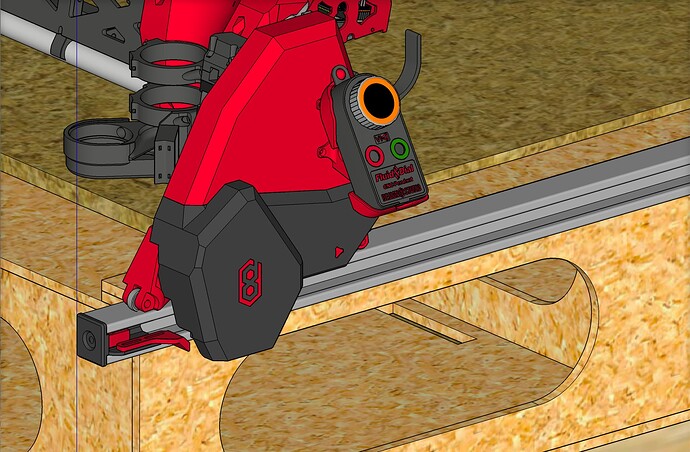

Parametric Fenders for the LR3 now on Printables!

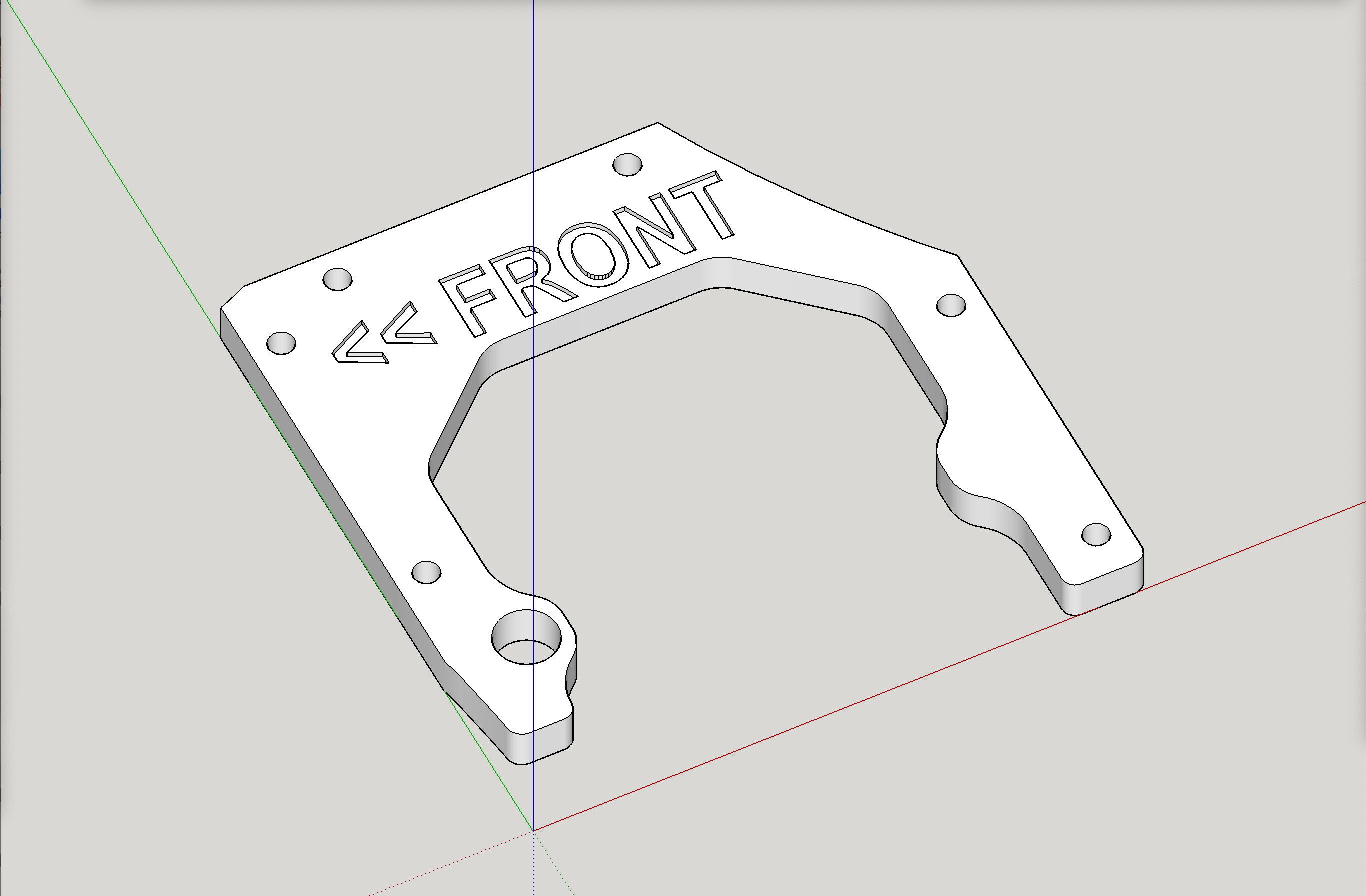

12.5mm
I’m reserving the right to make extended Z plates in the future!

Doug that looks amazing - it really takes your machine to the next level!

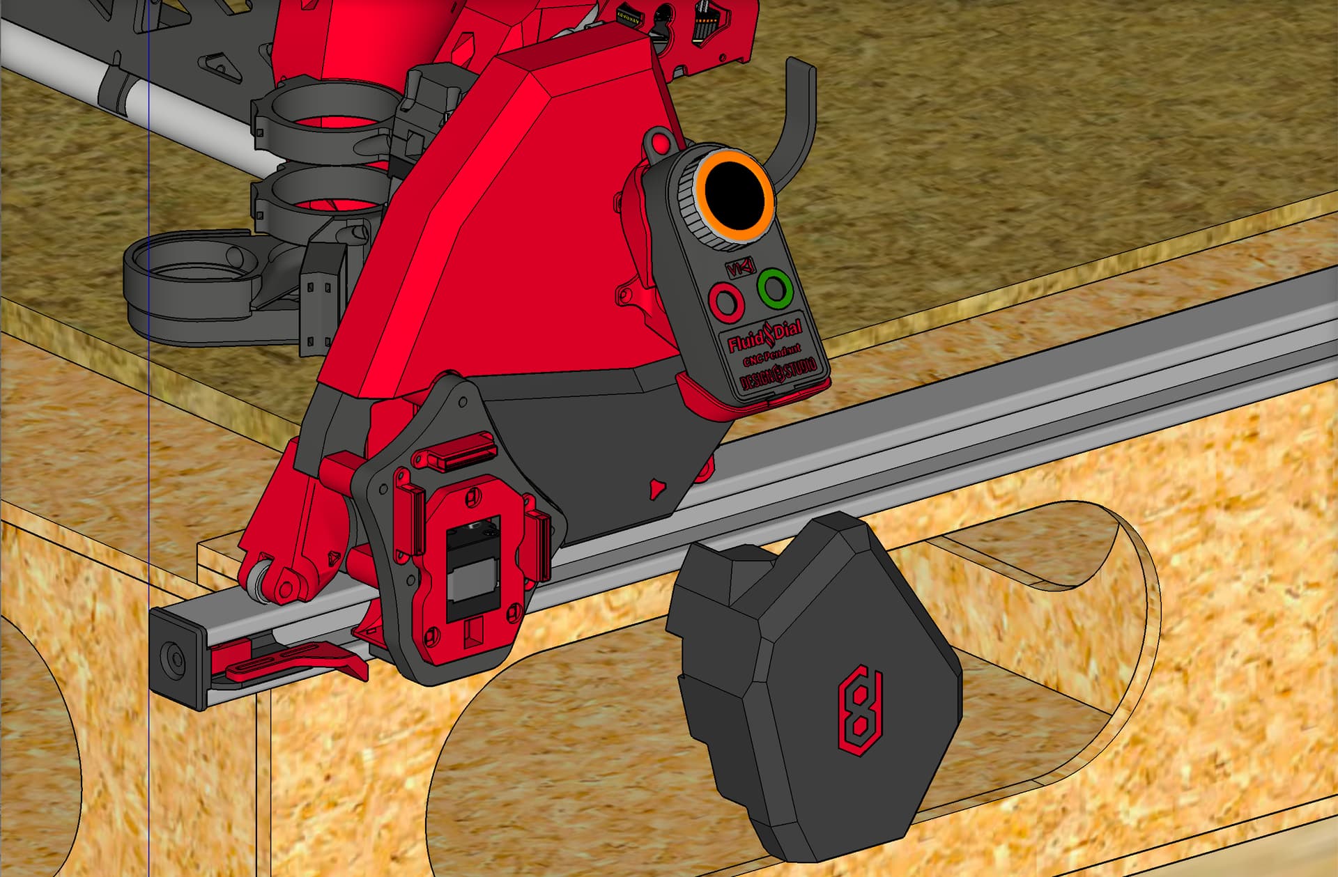

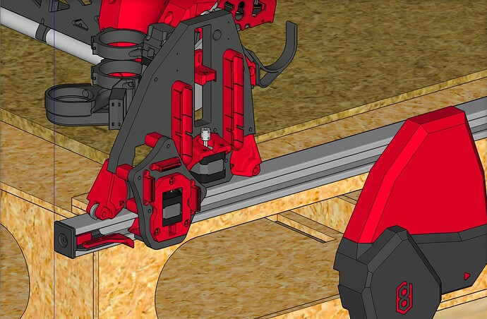

Absolutely. one thing to note: the new add-on fender for the Y Extend plate, now does double duty in also filling in where the bottom fender used to cover the front. The bottom is now shorter, only coming over to meet the new add-on fender. The main front clip also got shortened by 25 mm.
All clips for both the left and right sides, including new mini clips for the add on fender for Y extend plate:
Both bottom fenders for both sides. Note they are shortened:
Left side, new add-on fender for Y extend plate:
Same, but no Design8Studio icon:
Left side, top fender:
Right side, new add-on fender for Y extend plate:
Right side, top fender:
