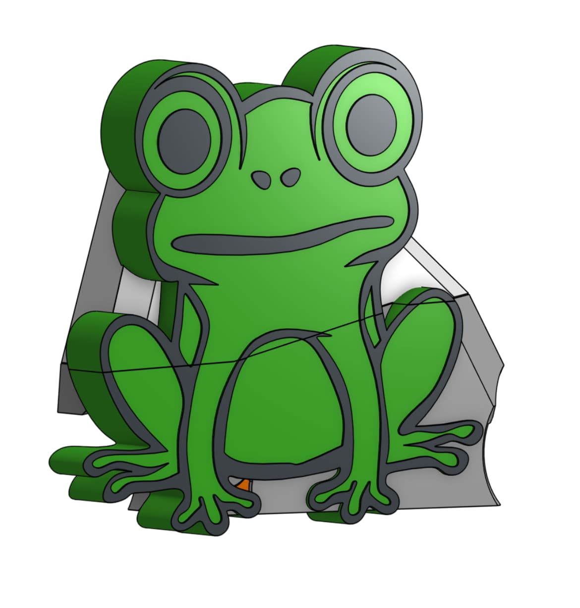

This is how things get out of hand. It started as a joke, and then I realised how easy it would be to do, and then I thought someone clever could make the eyes blink so he looked startled every time Y direction changed.
(This is just for @Tokoloshe - please don’t let it get out of hand… even though before my “Enterprise” scheme I was having visions of a Vader Helment. :rofl:
