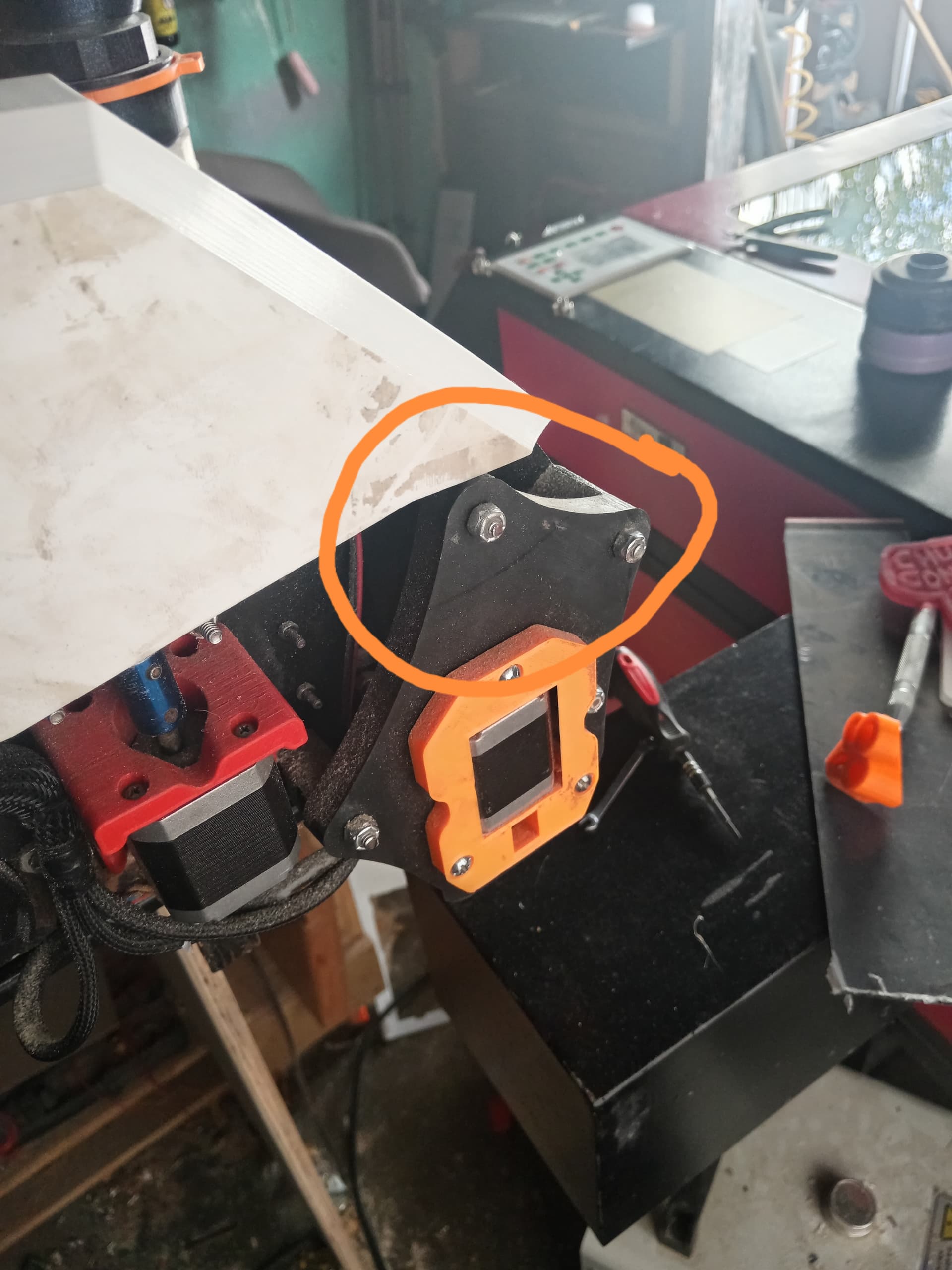

Hi doug i was trying to fix the upper cover but
This is on the way
And my LR3 is normal size with hiden Belt mod
Im working on remix for it
Sorry, I forgot about that little notch being needed. To save from having to reprint the top fender, you could cut out a small notch there for that. I will need to revisit some of my remixes to make sure I account for that!
Humblest apologies. On all the recently posted remixes for the combination of fenders and Hidden Belts Mod, I forgot to put in a notch that is needed on the “Fender - TOP” parts. I am working to fix it. In the meantime, if you have not printed it yet, let me fix it. Or if you already printed, you could manually cut the notch to allow the top fender to not be hindered by the upper standoff of your Y-Extend plates.

Also, I’m aware that my LowRider is mirrored from the normal orientation, so, because the “Y-Extend” fenders are not bi-directional, I am endeavoring to tweak these files so makers with normal LowRiders will be able to use the files as is. Until I get some progress there, it would be advisable to use caution in using the files.
In fact, until I get things sorted out better, I’m going to put the listing in draft status. Sorry, will try to get it all fixed soon.
