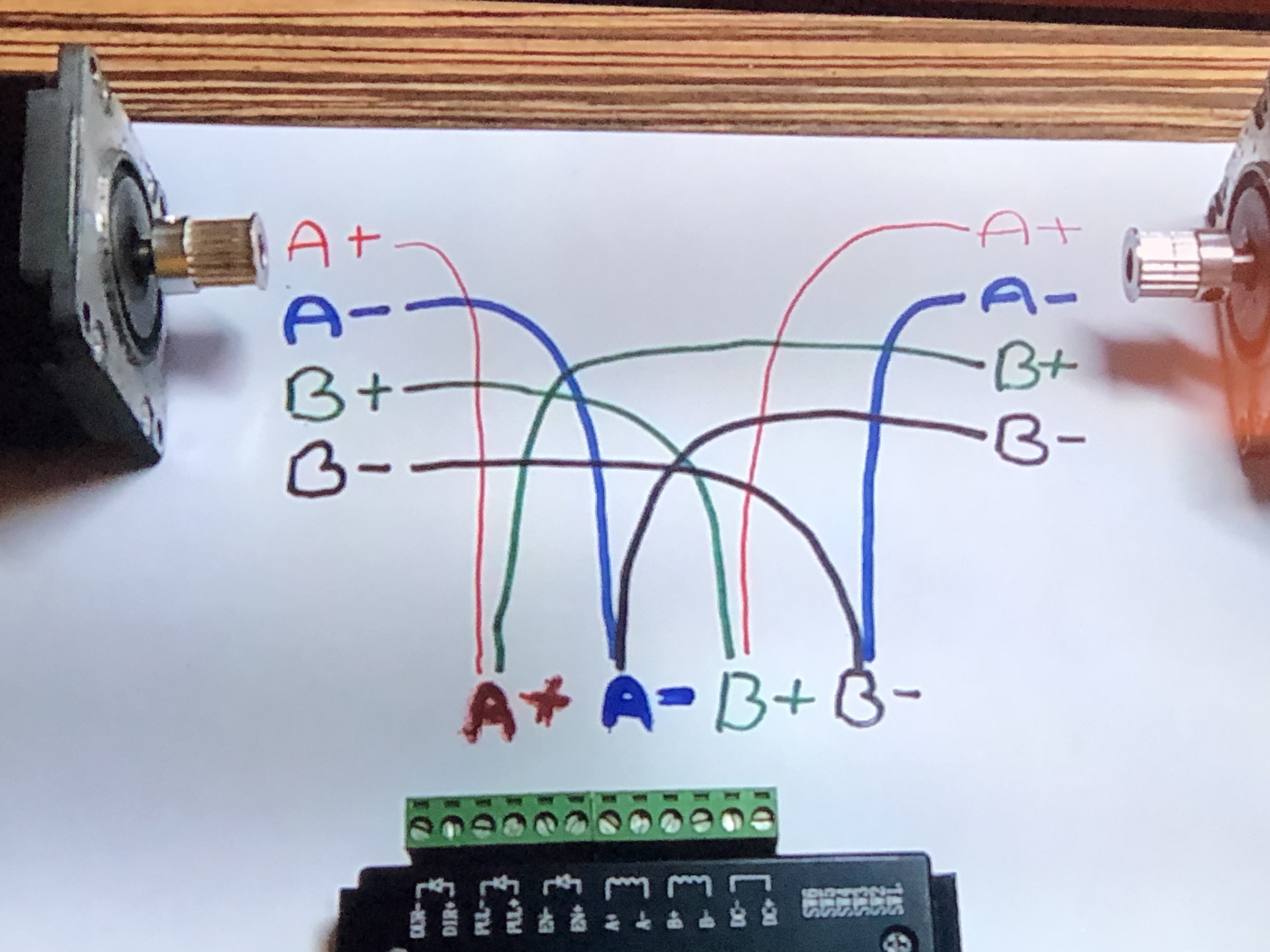

Need a bit of help with the X & Y stepper wiring, I have wired them up as per the serial diagram on this site, but as expected they both turn the same direction therefore, obviously as they are opposite each other they both also need to turn in opposite directions, does anybody have an updated wiring diagram showing the correct wiring combination. Thank you in advance

Stepper A
Black (straight through)
Blue (straight through)
Stepper B
Red (straight through)
Green (straight through)
Joins
Green (A) - Black (B)
Red (A) - Blue (B)
My question is and what would the colour arrangement be to reverse a single motor

As per the attached photo from the wiring section, could somebody just explain to me which wires (colours) I would need to alter in order to get them running in opposite rotation.
Thanks
The simplest way to “flip one over” would be to take the red & blue wires (in the picture) on the right stepper and switch them with the green & black wires (also on the right stepper.) Based on your connections, it looks like you would take the stepper A red and green and switch them with stepper A black and blue.
Stepper wire colors don’t mean anything other than to help us differentiate them. There’s no code or standard to what color belongs to what pair. They could even change order from the same manufacturer. Like Ryan said, if one is running backwards, just flip the connector for that stepper over.
Hi, I understand the wire colours are irrelevant and just helpful for indication, I must be missing something but after re-wiring the steppers now seem to attempt to move but don’t. almost as if they are trying to move both ways at once.

Two thoughts:
  1. You have a connection issue where one of your connections is loose when you remade them.
  2. Check that you have the pairs identified correctly. To do this, I hold two leads together and then try to rotate the shaft. If the shaft is difficult to rotate, then the two leads form a pair. If the shaft rotates easily, then the two leads aren't part of a pair and I exchange one of the leads for one of the remaining leads and try again. One of the pairs will be the equivalent of the red & blue in the diagram while the other pair will be the green & black.
[attachment file=77565]
We are using 1, 3, 4, 6 on the nema 17 stepper as in the bipolar drive series connection. Note that 1,3 and 4,6 are paired. When you reverse a connection you are using 4,6 and 1,3 instead. 1,3 and 3,1 are the same thing…
Perfect, thankyou all working now
