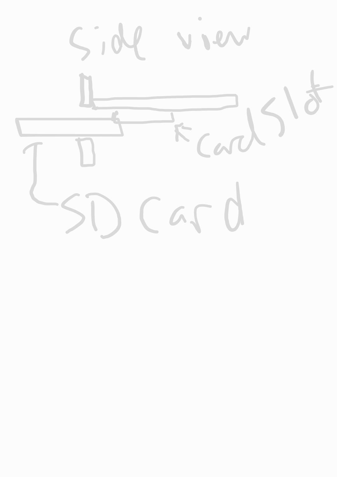

  4. After saving the file to the sd card. Put it im the lcd, remember it goes in upside down(contacts facing up).

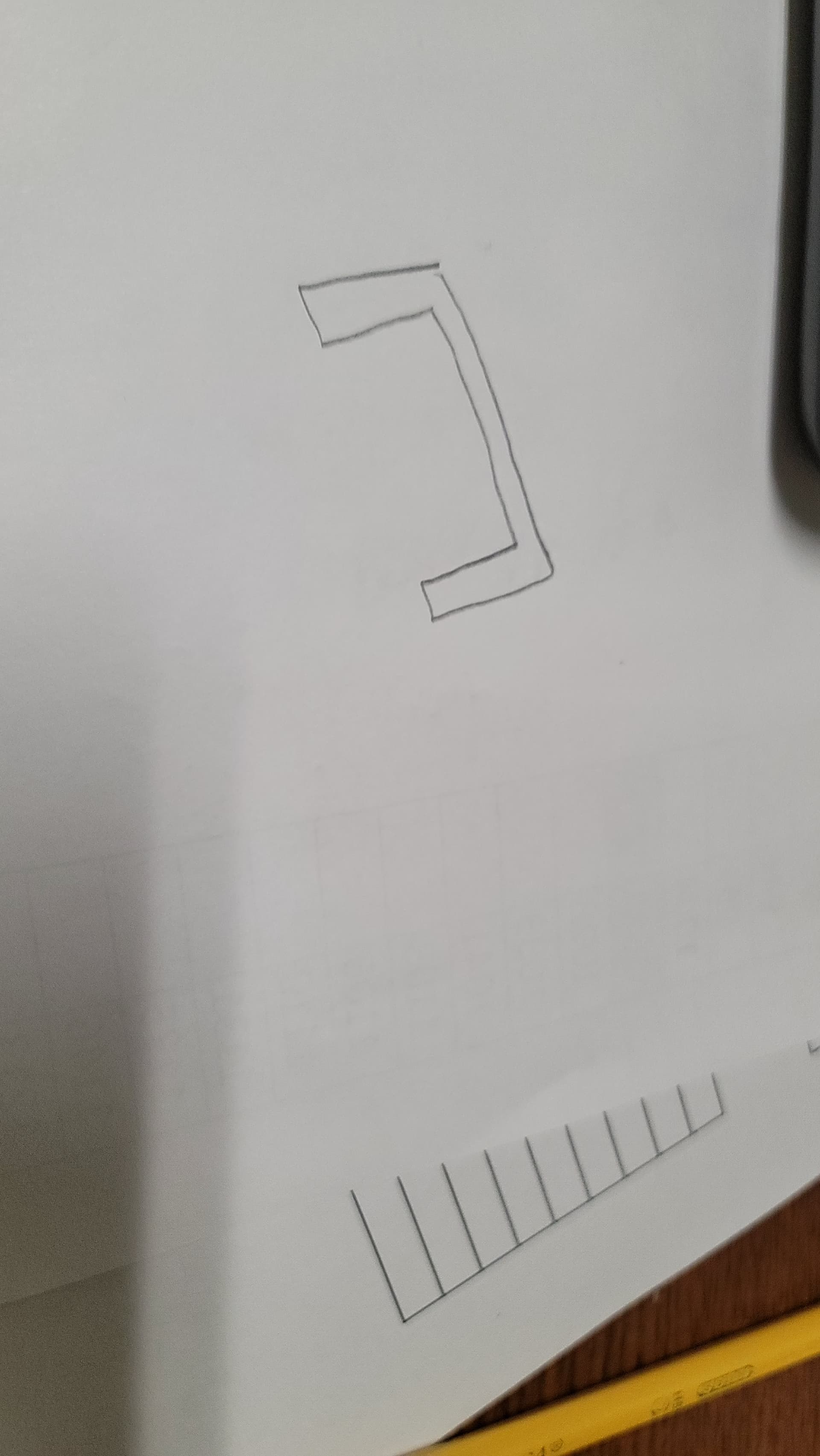

  5. The next step is a little tricky because it comes down to if you have end stops or a touch plate. I didnt have end stops for the longest time. So made and cut somethings that looked like this
    So i could quickly slap them on the conduit push and be square. After slapping them on go into motion,move x or y, and move .01 so the motors would engage and it wouldnt move when setting they Y axis.if you have end stops go into motion and home x and y

I know this is silly, but are you putting the sd card in the wrong way. Because there is just enough space for the sd card to miss the metal slide/catcher
