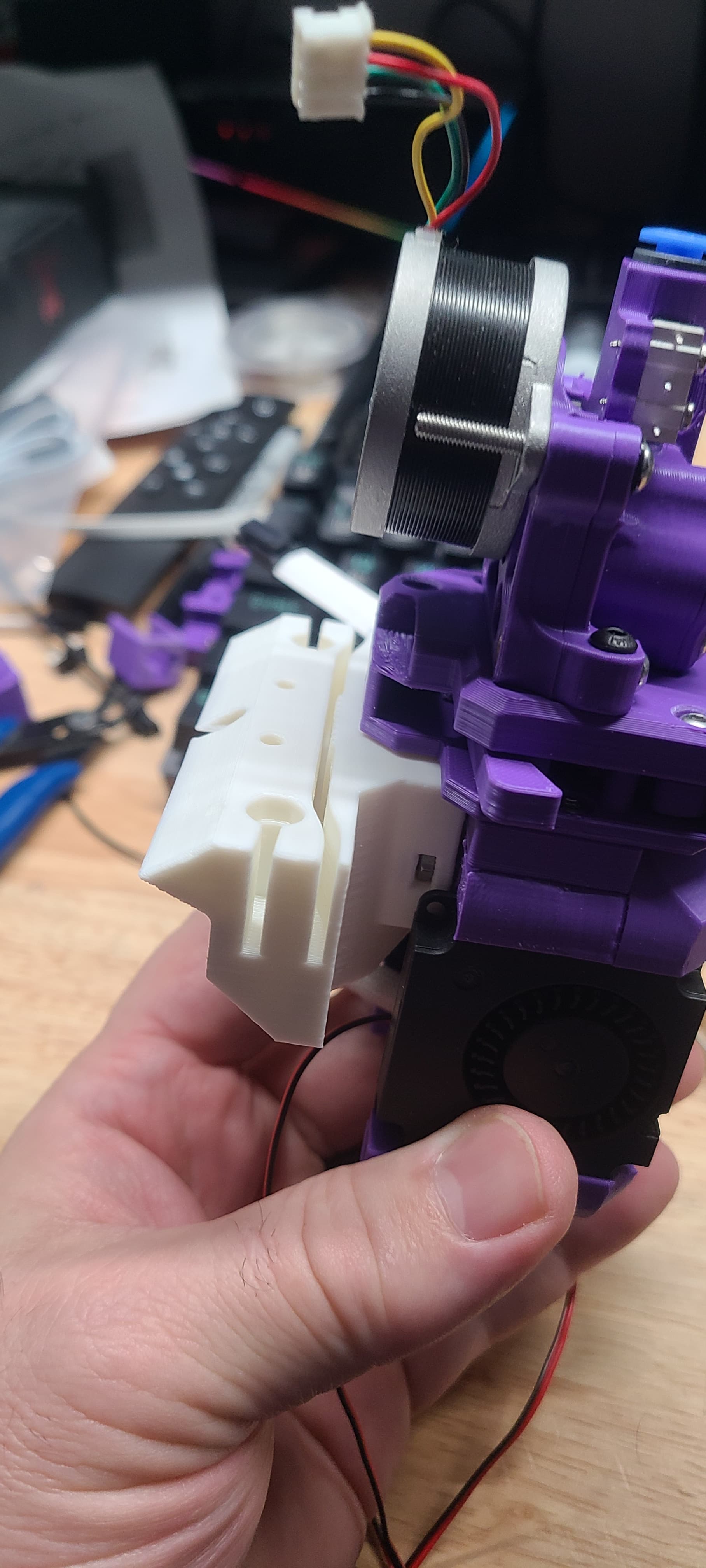

I don’t know if there is a version with a metal frame and a runout switch.
It is very small. This is my first experience with it also. I picked it because it used the same gear set as the Clockwork 2 that I had already built.
The MMU situation is why I am working on this. I wanted a filament cutter and the Filametrix Stealthburner cutter was out there. I then discovered the Dragon burner and its mount is way easier than the Stealth to adapt to our uses. Then I found the DragonCutter. It also has a filament sensor and according to all that I have read the Happy Hare software is really happy if it has a sensor before the extruder and between the extruder and the hotend. This fits all the requirements and is lighter and better cooling (I have read).
The other upside is that all the Chirpy toolheads mount to the same mount so you can build any of them and use them.

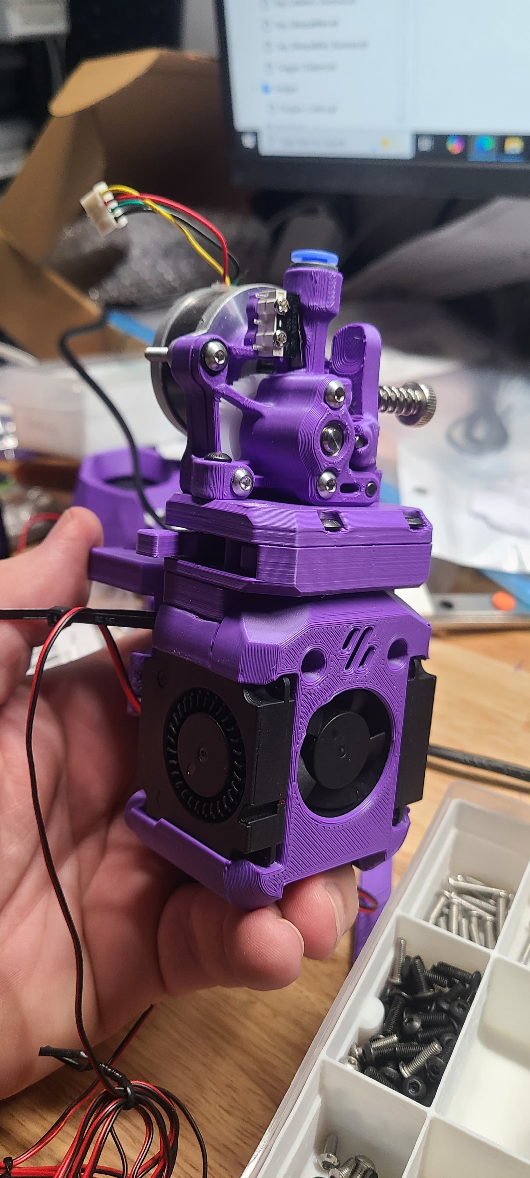

Dragon Burner with Revo Voron hotend, Dragon Cutter and Sherpa Mini with runout sensors above than below the extruder.
Parts are missing inside as they get delivered over the next couple days. Just wanted to put it all together and see how it looked.
At this point it weighs 272g with the mount. 253 without it. I have not done the Probe mount but expect that will not add more than about 30g total. Also there will be a EBB36 on it.
That looks really fantastic. I can’t wait to see your assembled toolhead on your printer.
Yeah… I have to build it now…
