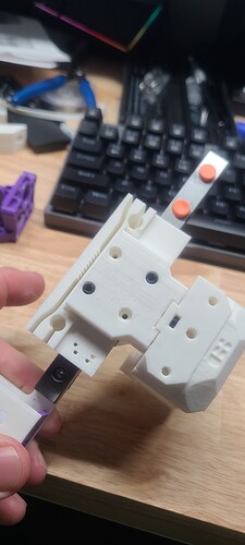

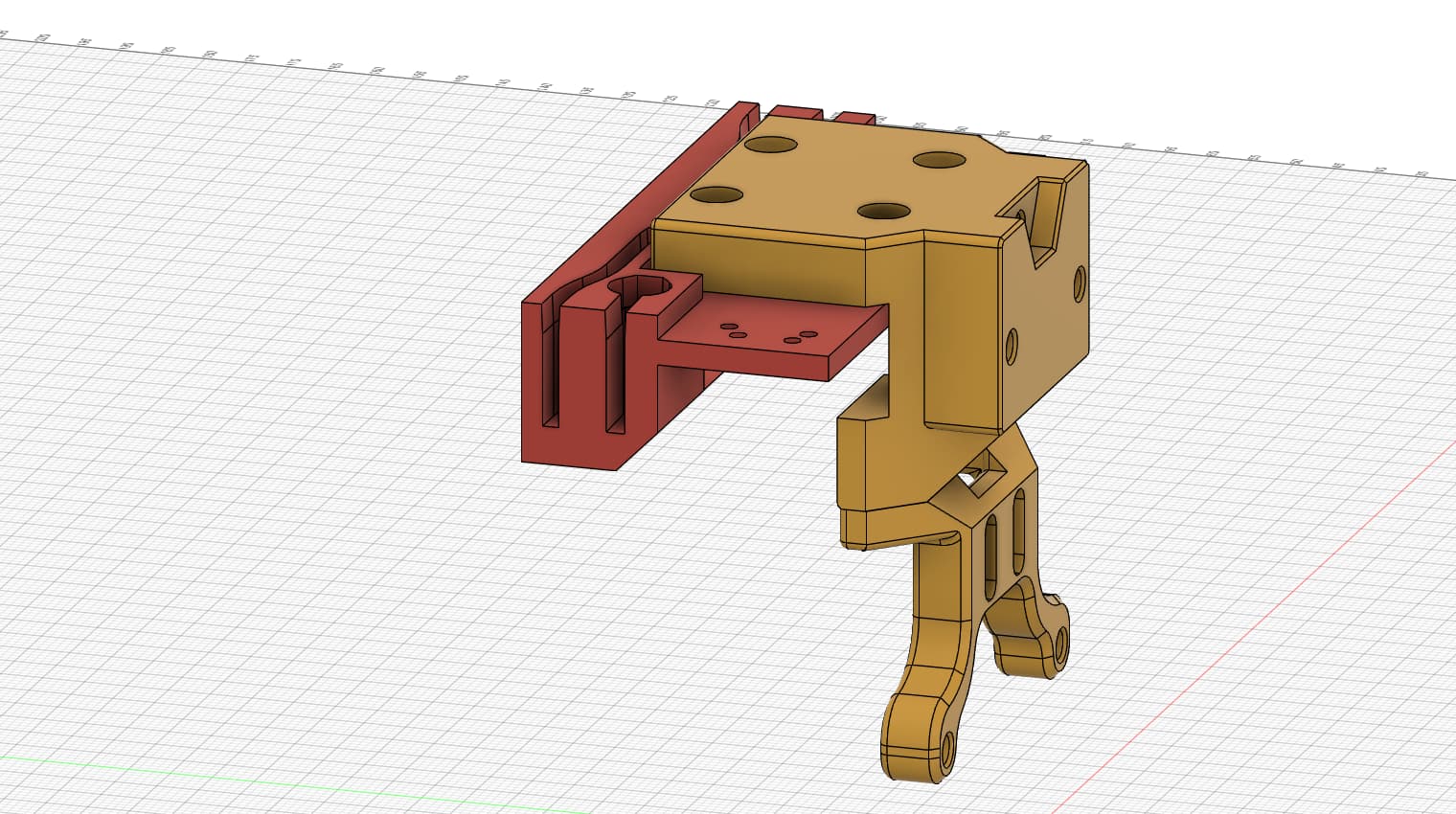

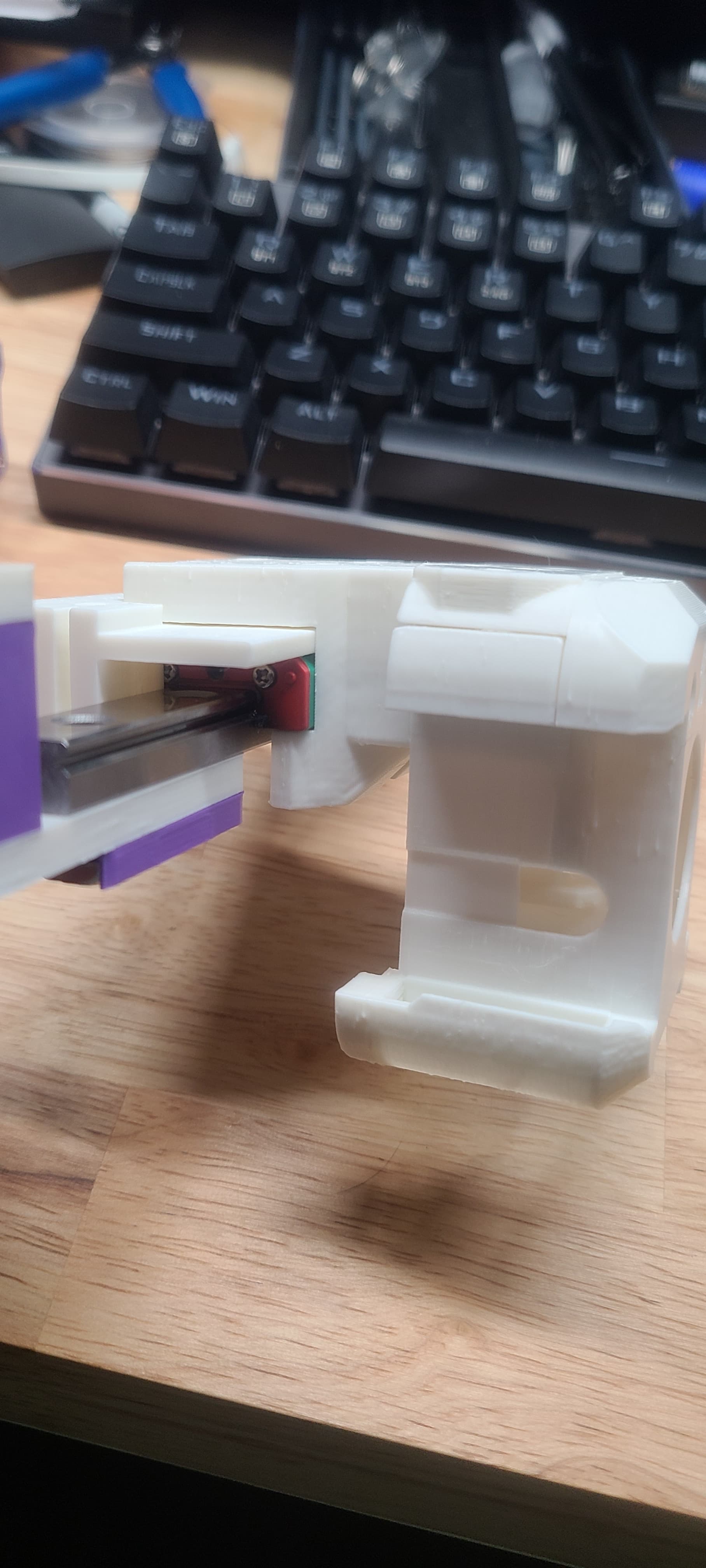

This is where I am now. This set up for reversing the x axis end for end. It is based on the Dragon burner mount and should fit all of the toolheads from the above link. I am printing a Sherpa extruder to use with it as I have the BMG gears from the Clockwork 2.
Can bus options are the EBB36 mounted on the back of the pancake extruder motor.
These toolheads are super customizable and there IS a filament cutter add on for the dragonburner at least. it has filament sensing at the cutter so that checks the boxes I was looking for.

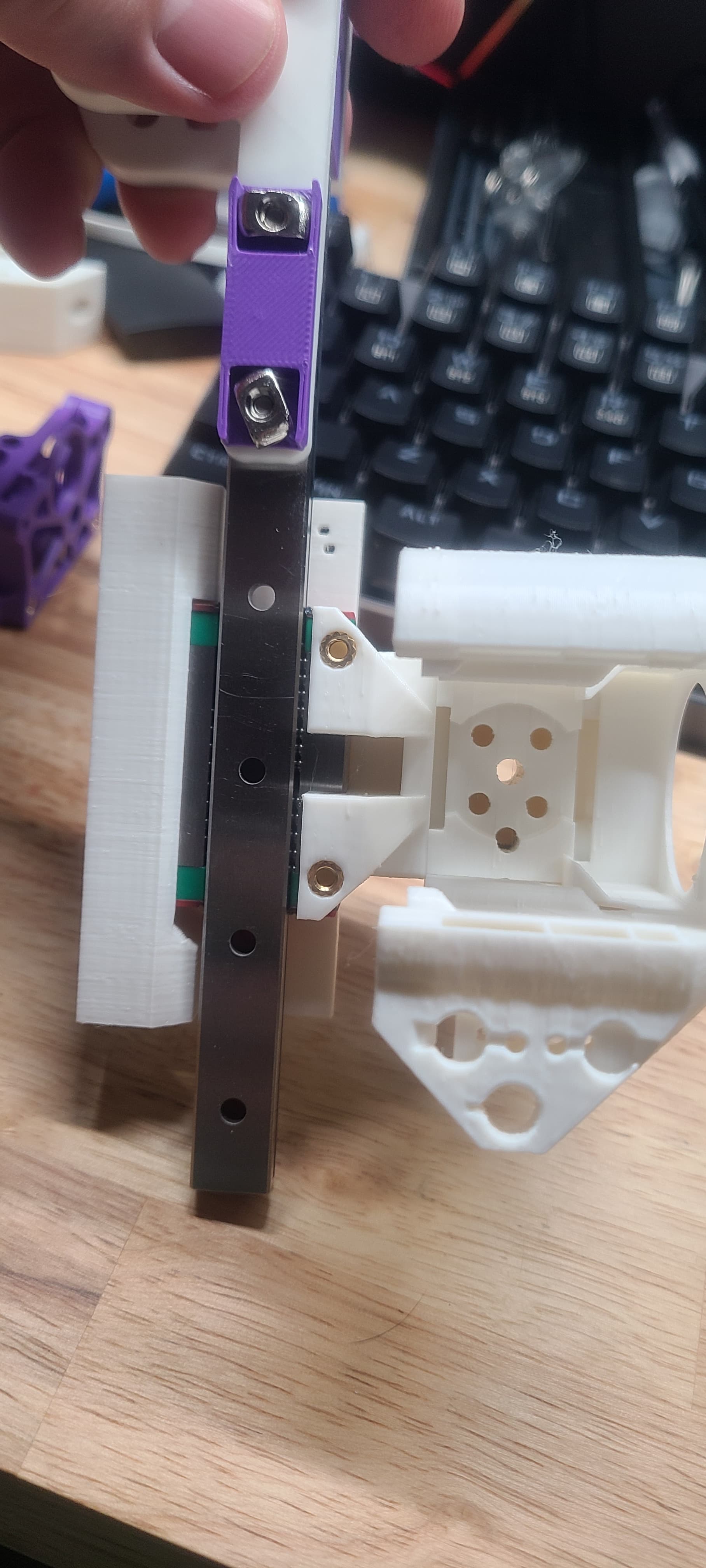

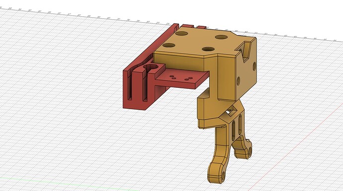

I THINK that the nozzle will be 37mm from the center of the rail (rough caliper eyeball look). I feel like that is closer than the H2 on the stock carriage.
The face of the shroud will be 55mm forward of the front edge of the truck. near as I can tell you will need to add about 25mm to the front to back 2020 extrusions to account for this. It can be as small as 5mm if you just want to keep it in the outside envelope of the frame.
More as I get time and parts to mock up
Quick note, I do not plan to use the housing that is mounted right now. Yhe carriage mount has a lower section that holds the probe mount. I will be makihg a microprobe mount for it.
Another option is the ā€œPeckā€ experimental unit on yhe link above.

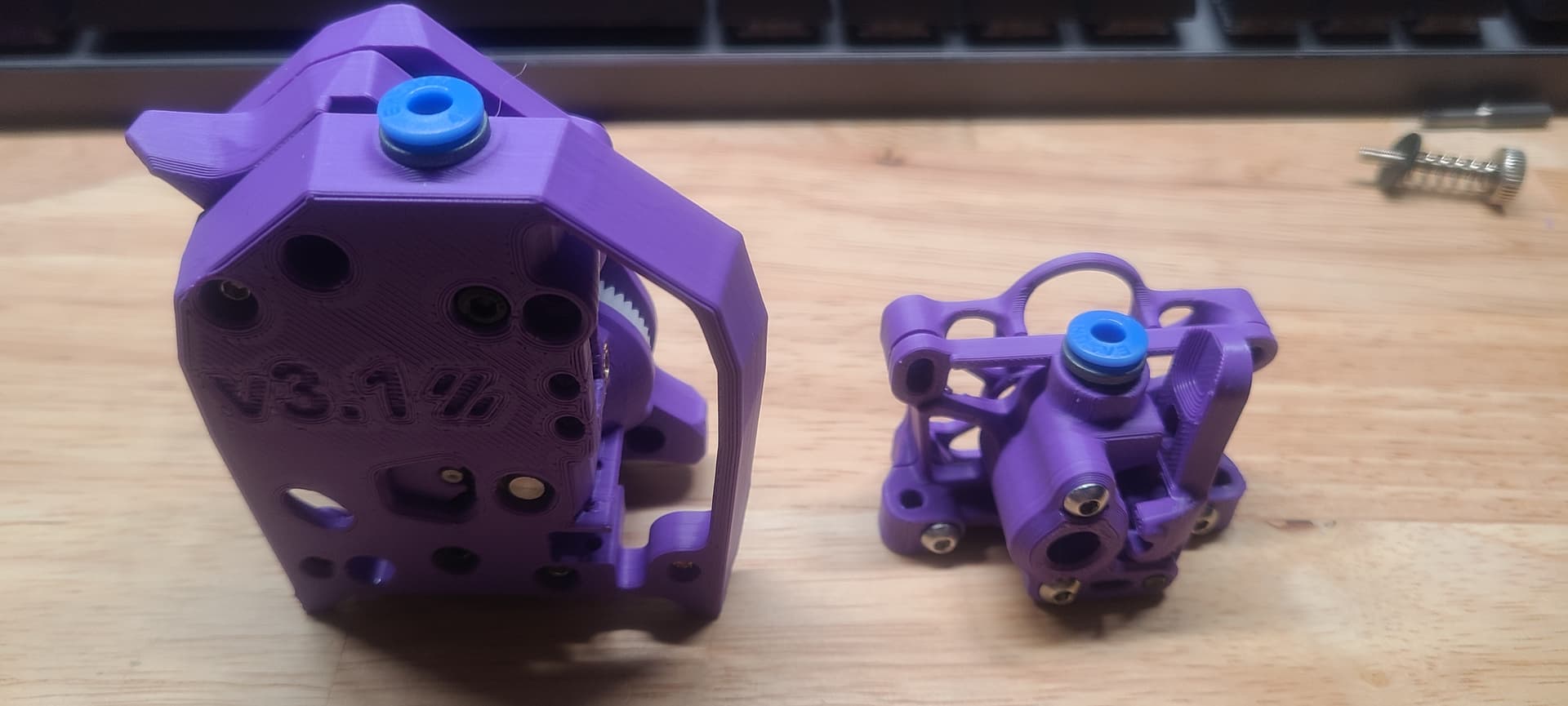

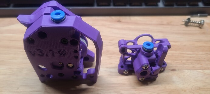

Just an interesting comparison. on the left is the Clockwork2 extruder for a Stealthburner, the right is the Sherpa Mini extruder. Both use the same gearsets, bearings and shafts. I will be using the Sherpa on the Dragon Burner.
It is to be noted that the stealthburner can have other extruders on it. I actually ran across an installation with the H2V2S Lite adapted to it
I have a sherpa, I never thought about using the gears to make my own…that could be super fun.

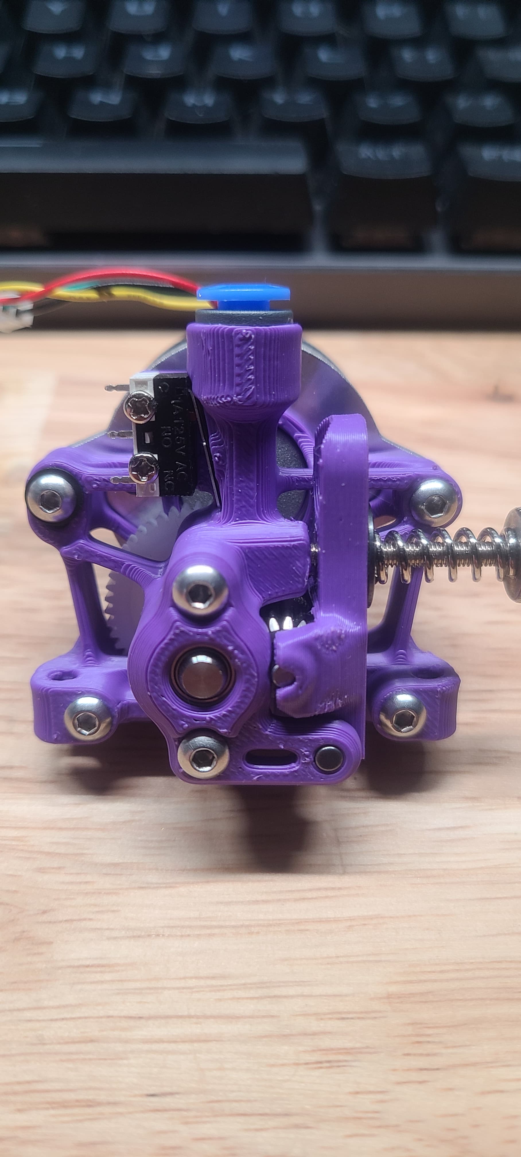

For your viewing pleasure. Sherpa Mini with ECAS and filament runout sensor.
I keep finding parts that I want to use but you cannot really reclaim the heat set inserts… I may need to buy some more!
That is small!
I don’t know a heck of a lot about the Sherpa Mini. Is the runout sensor the reason to go with the printed frame rather than a metal unit?
How well do they handle feeding from a multi-material unit and feeding of flexibles?
