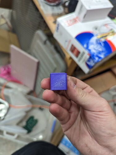

It’s alive! Best first print I’ve ever had.
Completely untuned in s3d. I took my existing printer profile and just changed the startup commands to do the bed leveling.
The calipers show the dimensions are just about perfect. I did not test for squareness.
I have a video uploading to youtube complete with a bed drop at the end when the steppers shut off.
Here’s the first print pictures. I’m really excited to get the printer finished now, calibrate it, and get appropriate speeds configured in my slicer.
