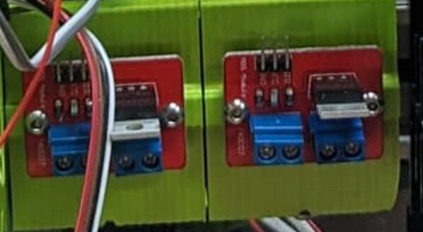

What are these things? Mosfet relays for fans or something else low current?
Exactly. One is for the exhaust fan. The other is for the chamber heater.
Both will be controlled by my octoprint plugin.

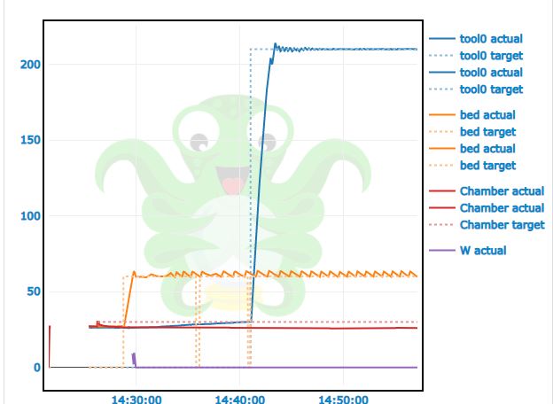

I really think I need to enable PID on the heated bed.
Ignore the fact I have duplicate temps on everything. I think my i2ctemp plugin is causing this.

I haven’t noticed any problems with Bed PID. I think it is just off by default because of really old hardware.
