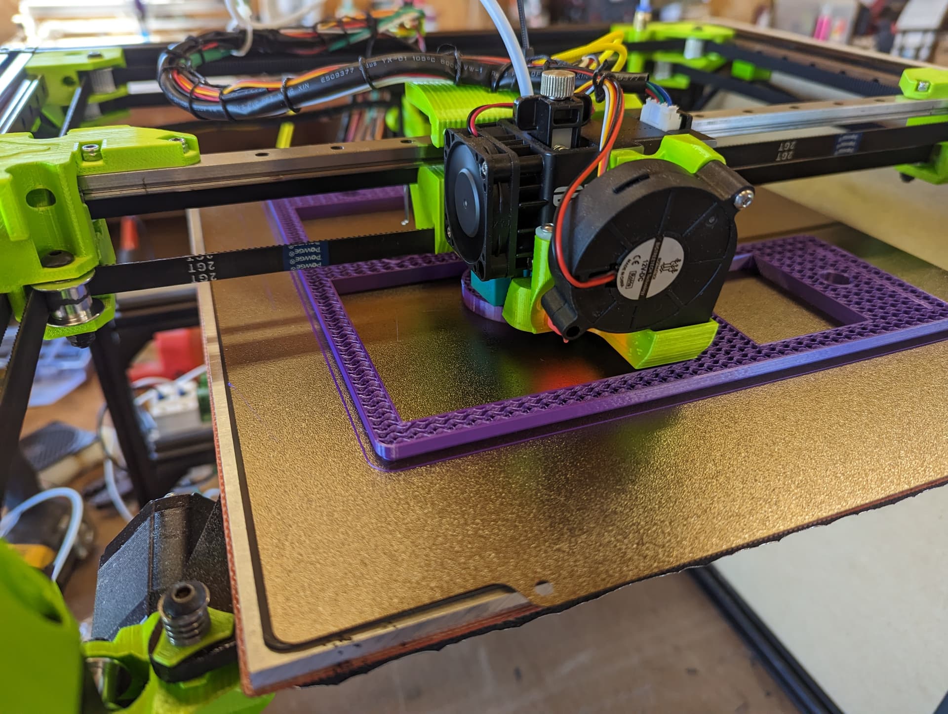

Trying out a big print. BTW, this is a really stupid design and is really inefficient. But it’ll get the job done.
It’s a right angle jig for the mpcnc so I can line up panels for cutting parts for the printw.

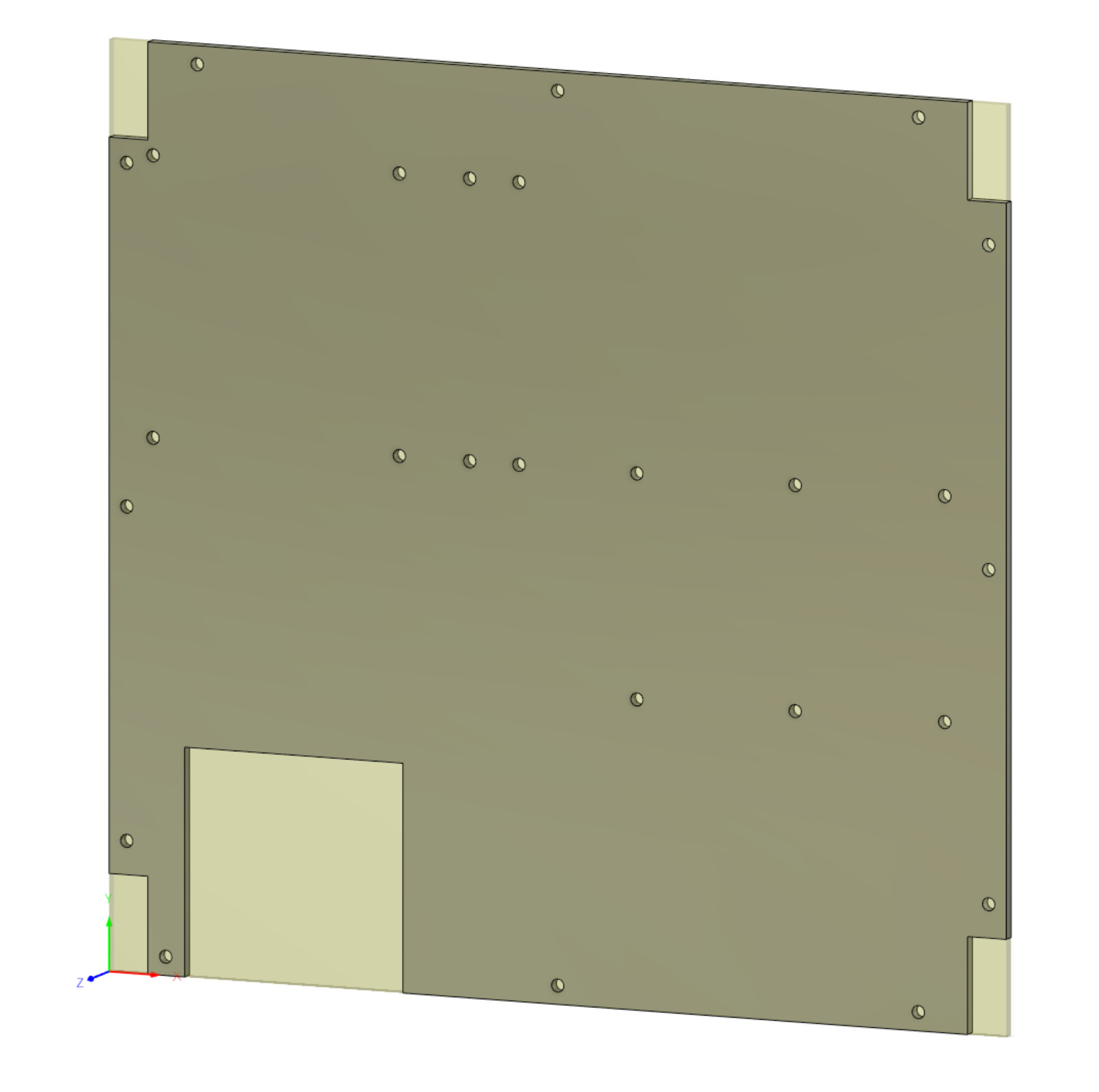

Taking bets on how accurate I have the holes placed on this for all the electronic stuff. I hope to try to cut it out tomorrow night.

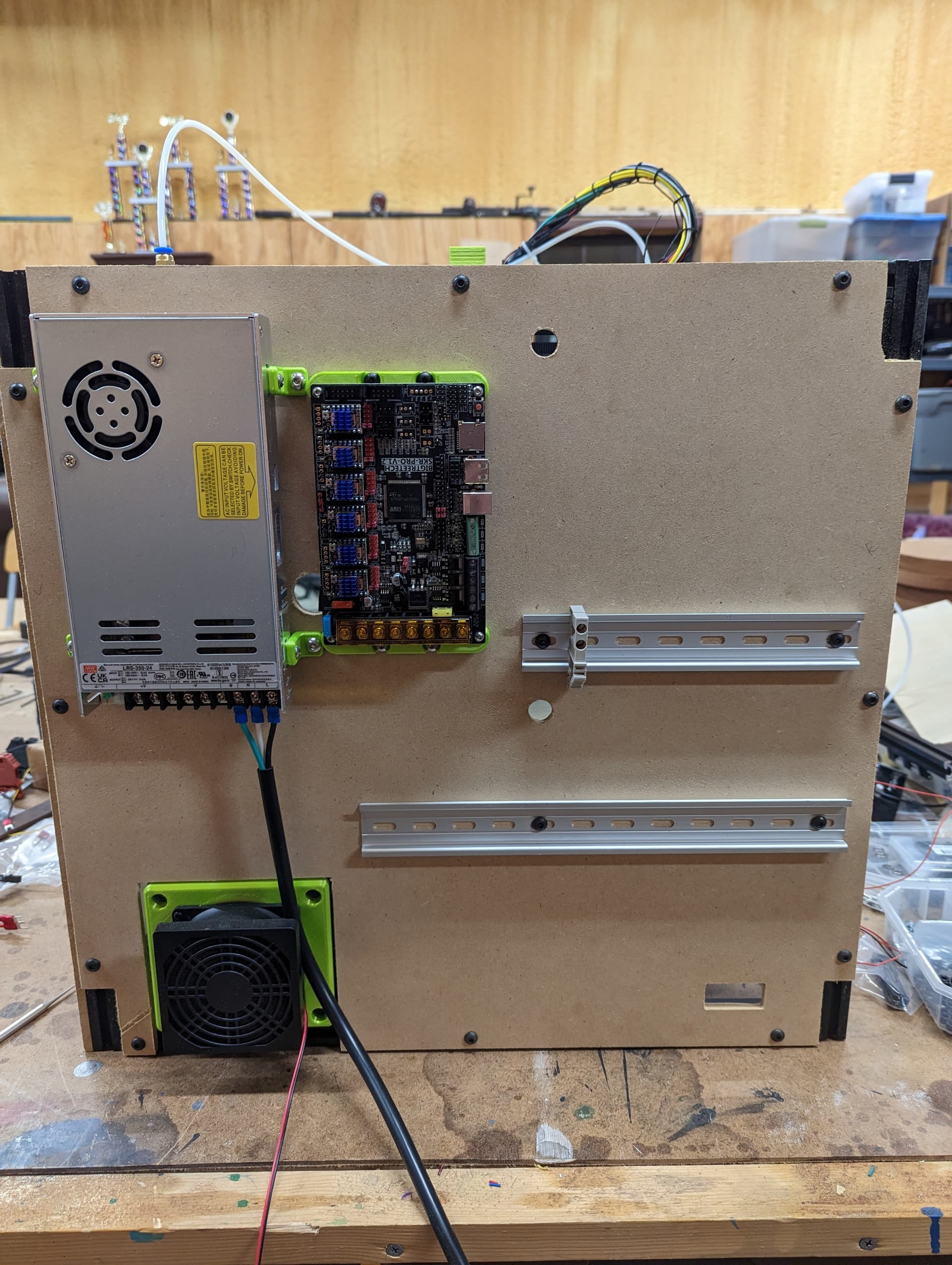

You’re braver than me. I gave up trying to figure out exact location for everything, ended up using DIN rail attached to Alu extrusion using Voron mounts. Voron Trident repo and Voron 2.4 repo have DIN mounts for everything, including LRS-350-24 and misc Controller boards.
The 6 holes on the right are for the din rails to mount to the extrusion.
The 8 holes on the left were taken from where the PS and controller are currently mounted.
I’m glad I’m talking about this. I just realized I forgot to put the holes for the cables to go through. There’s 4 holes missing.

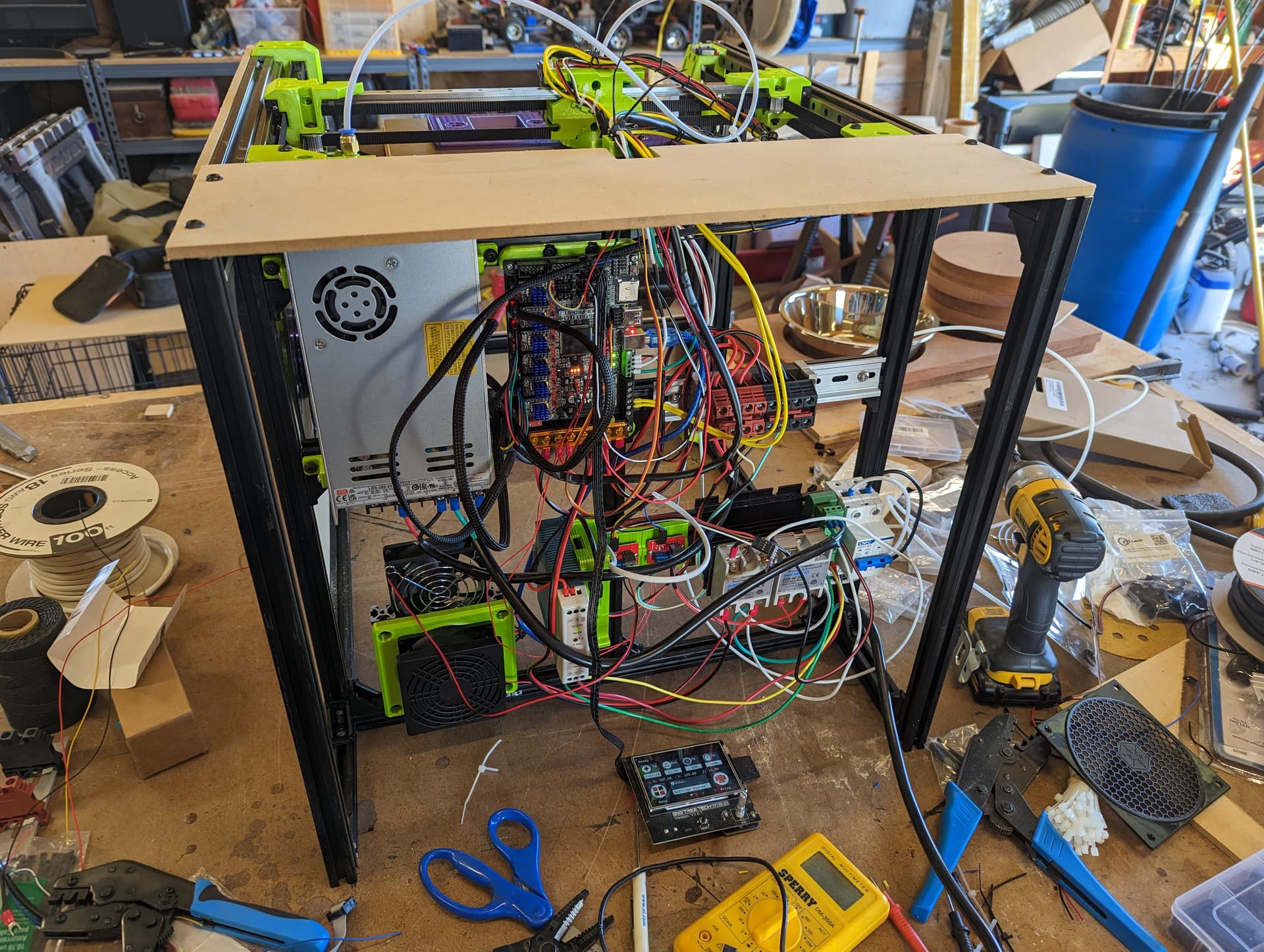

Guess what I did all evening…
LOL, rewiring and shuffling everything around, you’re not alone.
Am pretty much doing the same, also just finished 2nd attempt of cutting a bottom panel to help square up extrusion.
No shuffling, but I did just realize I forgot to put a hole for the heater in the board.

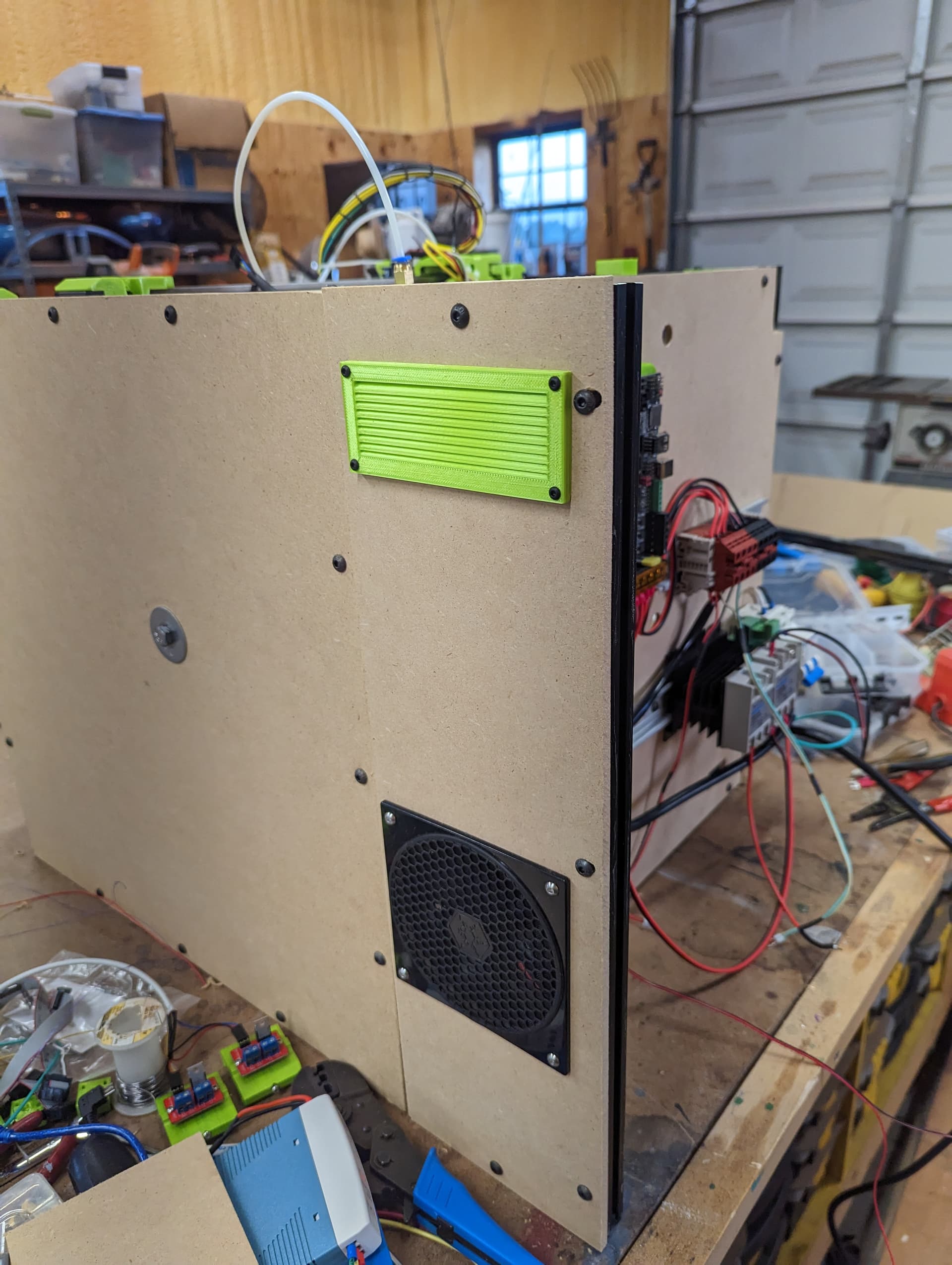

Minimal progress tonight. I have to recut the side panel for the electronics box.
The panel wasn’t square to the machine, so nothing lined up right. The vent is also too high up and doesn’t clear the corner braces.
The next panel I’m going to over cut and let the cnc cut the sides too.
