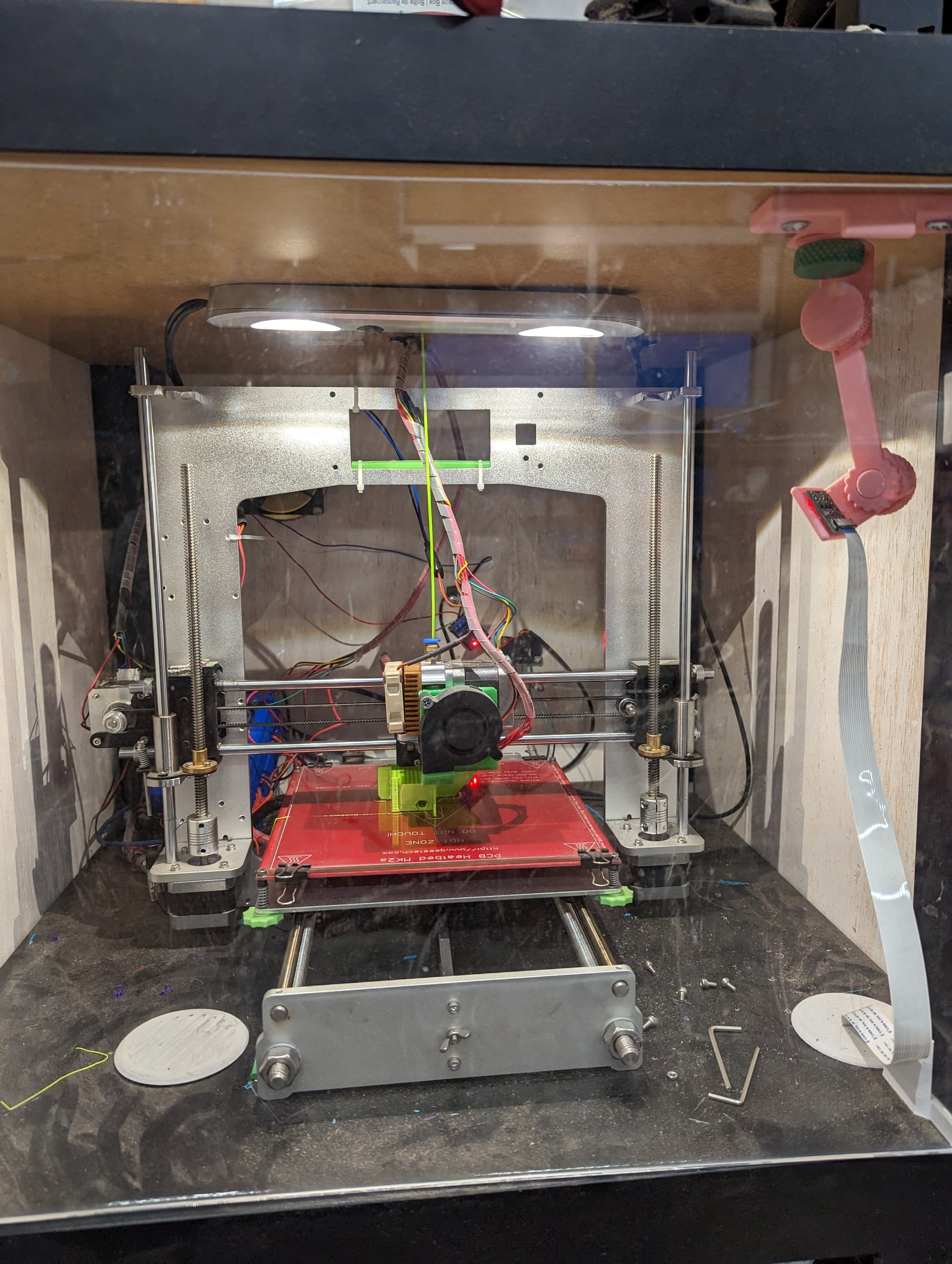

It dawned on me that I don’t think I’ve ever posted a picture of my current printer.
Geeetech aluminum i3… Slightly modified.

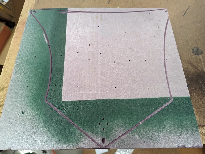

I also created the gcode for the build plate so I can cut it out of MDF. I might be able to do that Thursday evening.
Oh boy.
It’s been forever and a day since I’ve cut anything on the MPCNC (sorry). It looks like my speeds and feeds have disappeared from fusion360. I’ll have to run some test gcode before I cut my board. ESTLcam still has feeds in it from the last time I used it, but that was a really really long time ago and I’m not sure I ever went back and updated it after finding good speeds in fusion360.

On a sadder note, I did a test cut in foam and discovered I cut all my MDF blanks too small.
I guess I’ll have to pick up another sheet of MDF.

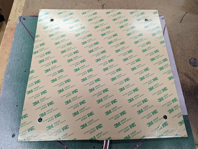

As a positive, though… The mounting holes line up perfectly with the bed heater. I had to do some math in my head for the holes. The heater is 310mm^2, but I’m leaving the print size as 300mm^2 because that’s what my aluminum plate is. I was worried I had the math wrong.
Did some air cutting before cutting the foam, just to make sure the machine still worked.
