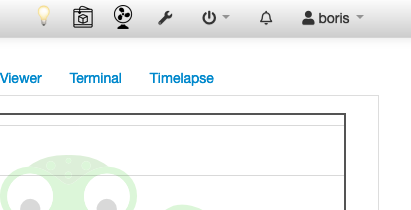

I saw the relay project, but I want to turn the fans on and off based on the temperature of the enclosure. There is an enclosure plugin that says it can do it, but it doesn’t load for me and it looks to have been abandoned.
My plan is to read a temp from an i2c device and turn either the fan or heater on in order to keep the temperature between a set range.
Marlin has the ability to control a chamber heater, but not an exhaust fan. Or, at least, not one that I could tell.
I did most of the skeleton for the plugin last night. I just need the relays and i2c device to come in so I can write that part. I need to figure out if I can trigger a function every X seconds in octoprint, otherwise my second option is to run my function every time octoprint receives the temperatures from marlin for the extruder and heated bed.
I plan on having a button you can use to prewarm the enclosure before starting a print. Scope creap has me wanting to do a tapered cool down at the end of the print, but I’ll probably just turn the heater off and turn the exhaust fan on.
My current enclosure control is a little arduino beetle. It only controls the exhaust fan. It has a physical switch that switches between pla and abs and only has a single set point for where it turns the fan on. For pla, the fan pretty much runs all the time except for in the winter. I use the heated bed to prewarm the enclosure in the winter. I just set it to 100c for 10-15 minutes before starting my print. I also have my power supply set up to blow the exhaust into the chamber and my controller is in the chamber.
I think I’m really just using this plugin as something to tinker with.

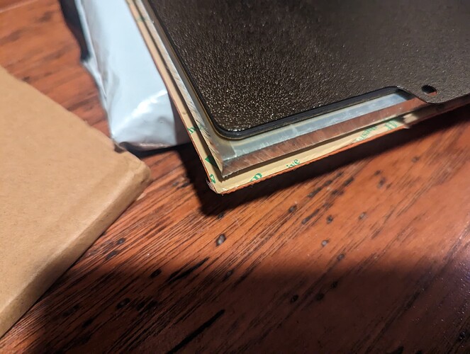

Hrm. This doesn’t look too bad. I wonder if I can just shave the extra 10mm off.
It’s just a mains voltage heat pad right :zipper_mouth_face: ? Or live with the overhang, or is there higher risk of peeling away over time?

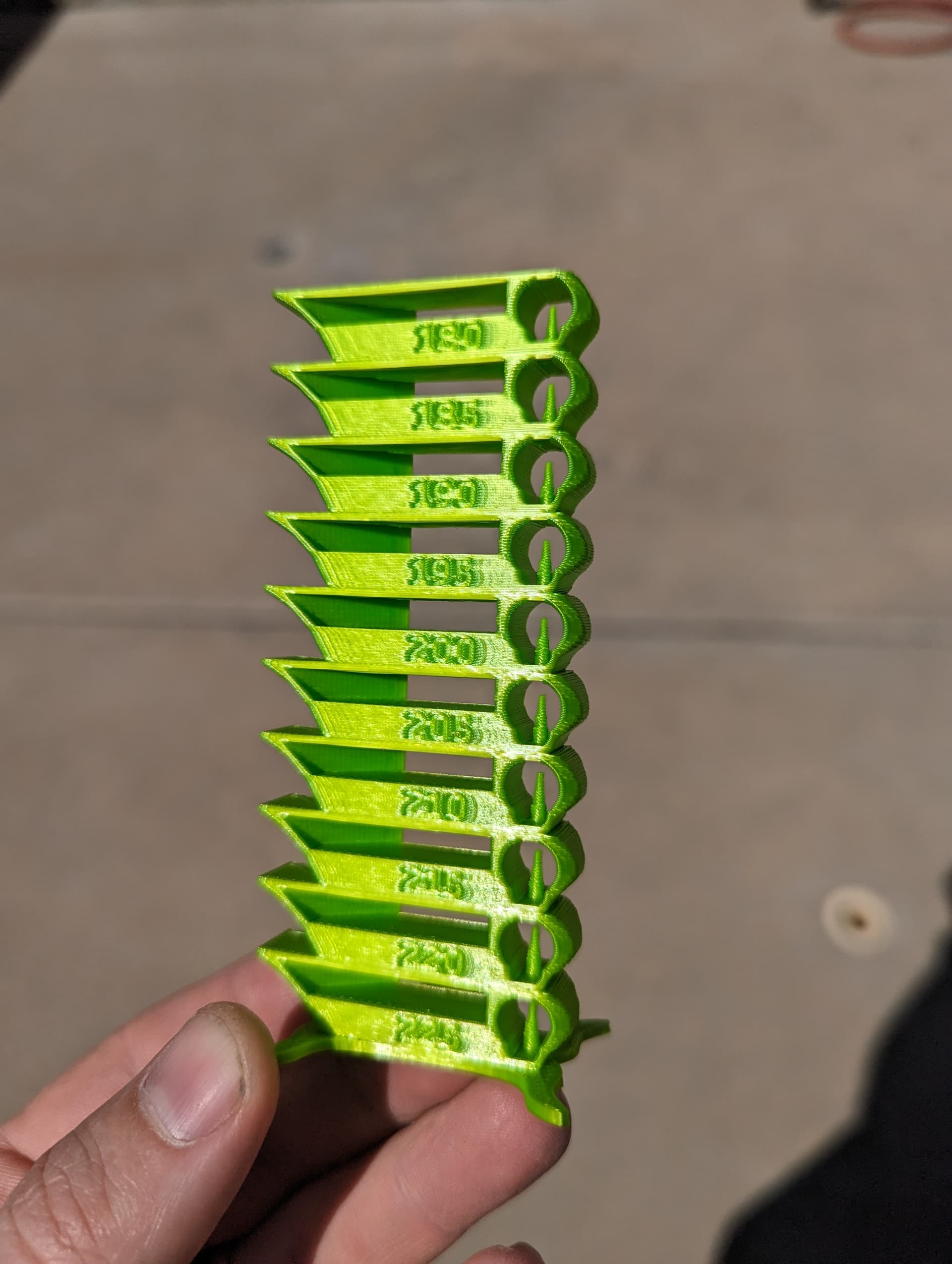

Ran a temperature tower on the new silk filament. Trying to decide what temperature to run.
I’ve already sliced all the files at 205, so not sure if it’s worth reslicing.
Here’s a video were I tried to get closer.
The only difference I see is on the outside of the circle on the right…maybe?
Personally, I’d be happy with most of the temps. Liked bridging for 210 and 215 over the rest. If quality is pretty much the same between them, would personally lean towards higher temp for better adhesion?
Is that much ringing normal, or worth tensioning belt(s), and/or placing printer on foam pads and concrete paver. So many ways, and even more info/videos discussing how, to reduce ringing effects. Too many variables!
I’m ignoring the ringing. The firmware on the current printer is an ancient version of repetier. It’s running a radds controller. I don’t think it’s worth trying to tune that out with the new printer on the way.
The only real difference I see between 205 and 210 is the small tower is a tad smoother at 210.
Alright. I decided to go with 210. I realized that my PLA settings was set to 205 for first layer and 200 for rest of the layers. 210 definitely looks better than 200 and is worth re-slicing everything.

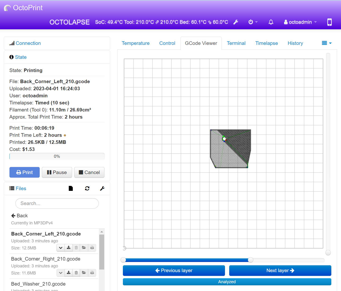

I’m only printing one part per print with the exception of the Z_Post, Tension blocks, washers, and Z belt holder.
Estimated total print time is ~39.5 hours. I should be through printing all the parts around May :smiley:
And so it begins…

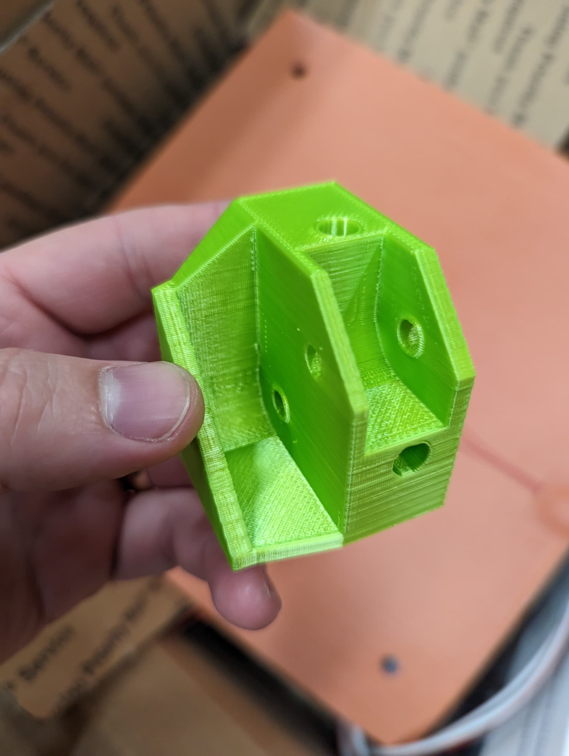

First part printed. I like the color. I think it will look slick with the black rails and white hdpe.
