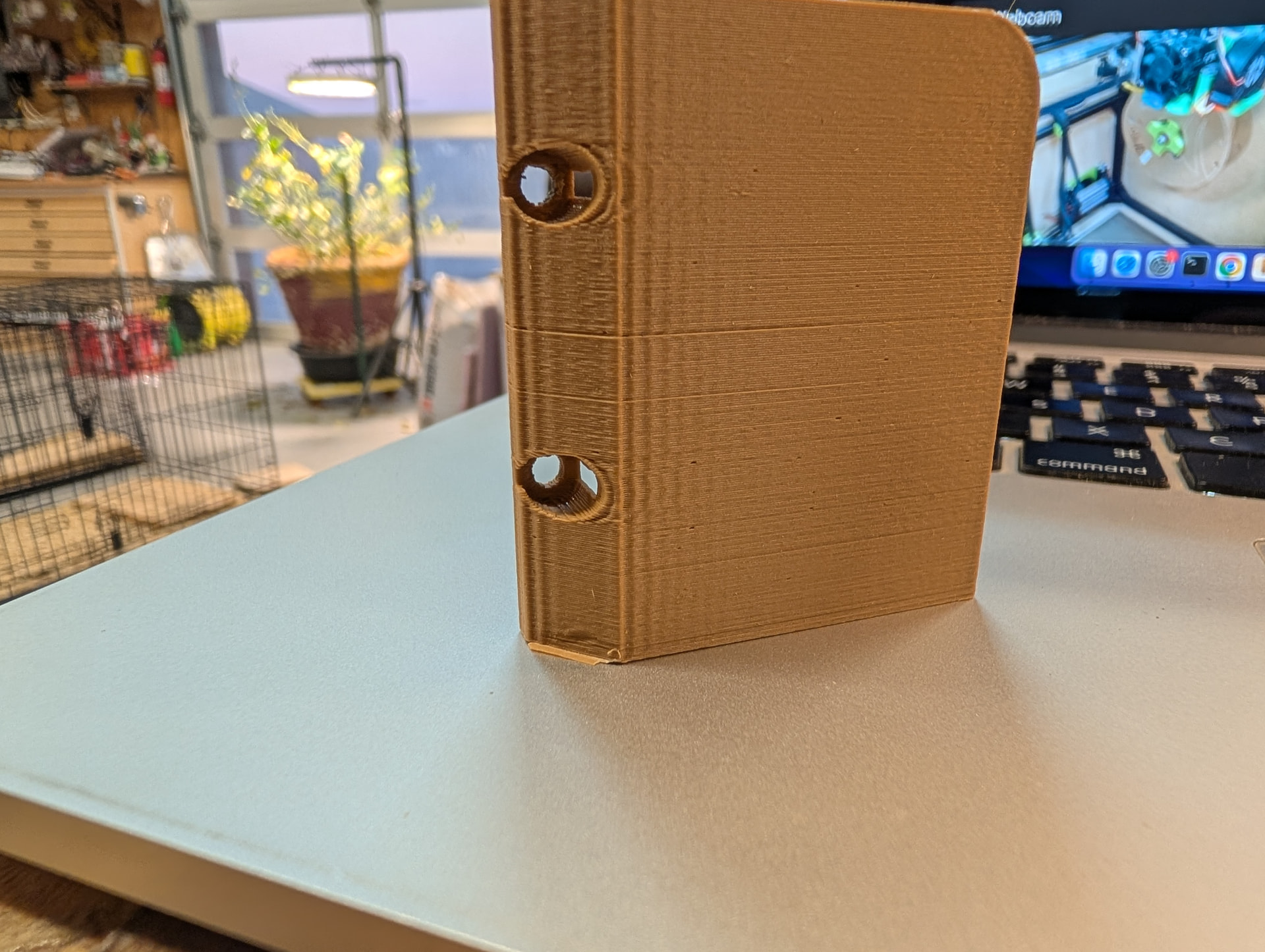

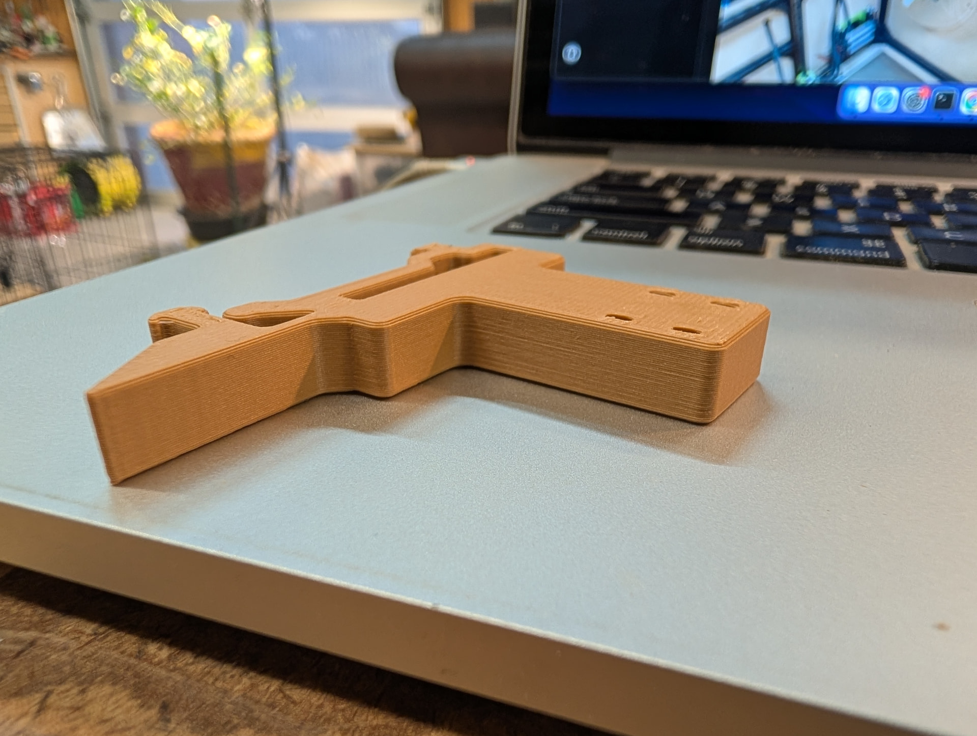

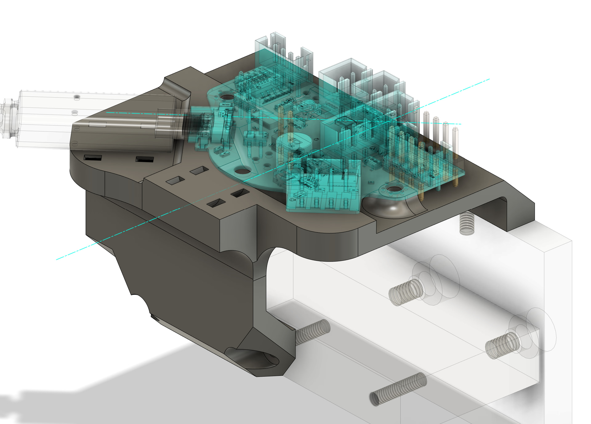

The fun part about using my own designed core is getting to design my own mounts for things.
I give you the over-complicated EBB36 mount. I wanted to try to support the EBB36 in as many places as possible without hitting any pins on the bottom. I also added some wire management for both the USB-C cable and the power wire I’ll be using.
I’ll work on getting this printed tomorrow. I printed a very un-complicated version of this today to make sure all the holes lined up. (Why wouldn’t they, it’s all done in CAD !?!?)
I think I’ll be losing a little bit of my X travel. I have a feeling the back of the core might hit the belts now.
One thing that still amazes me is how much faster this thing prints than my old bed slinger. Orca says this will only take 1h12m to print.

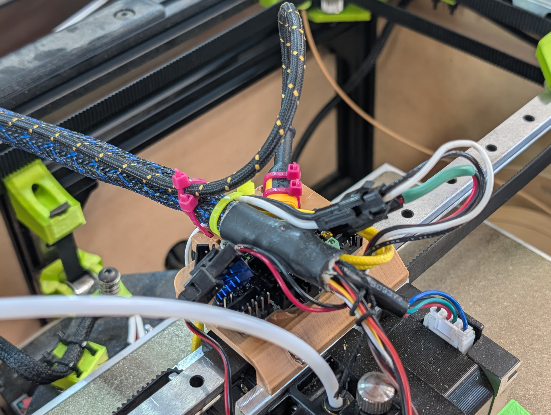

I woke up thinking about this in the middle of the night. I could reduce quite a bit of the mass if I get rid of the usb-c cable and go pure CAN. I did already order a u2c board.
I also ordered some usb-c breakout boards. Now I can decide what to do after all the parts get here on Tuesday.
I do know I want to print some strain relief for inside the electronics cabinet. I’ll start working on that design later today.

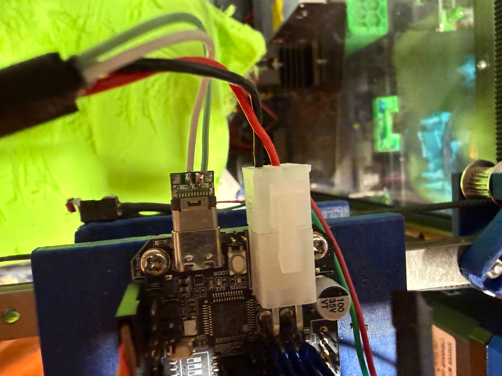

I did it with just a 4 wire cable and the USB C breakout board.
Dang it seems like a lot of space could be saved with solder pads. I know plugs are convenient but soldering wires to pads is pretty easy. And it would be a solid reason to buy one of those USB solder pens.
I’d question whether all the movement would cause a solder pad to be broken off. At least with the plugs it’s a through hole joint.
I know wire strain relief will help, but still.

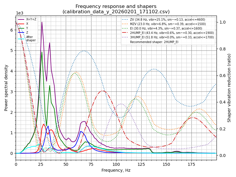

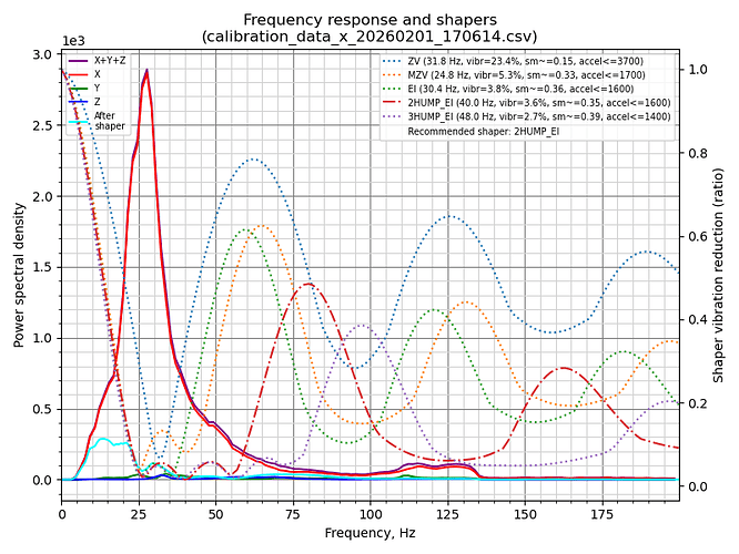

I don’t know what I’m looking at here, but I’m assuming the really big umbilical cord really makes these graphs bad.
The one thing I did understand is that the printer recommended lowering my acceleration down to 1800, which is a lot lower than the 6000 I previously had set.
Yeah thats WAY more cables than you need running a toolhead board thats for sure.
I’m still waiting for the USB-C breakout boards or the U2C to come in. I was just too excited to get it mounted and test ‘something’ out.
That I can understand 1000%!

Before input shaper
After
