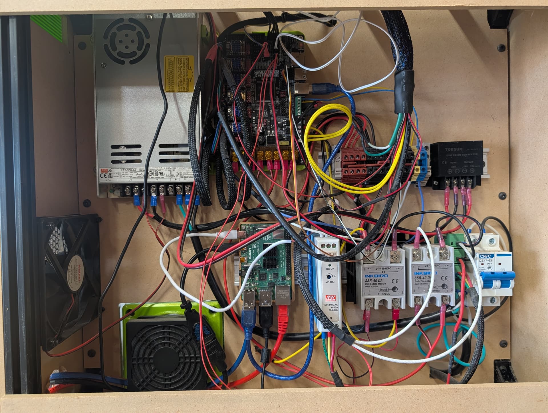

I have tried really hard to be better at wire cleanliness and gotten better at it. It really does help to have it cleaned up I have found… It just takes a long time and when there is a project and limited time, the tidiness takes the back seat. Also i fry fewer components with cleaner wiring because fewer things get caught and accidentally unplug.
I bought some wire tray from the online bookseller for less than $20 and used some tape to stick it to the back board. It hides the long wires and makes some short ones not fit, but i think it is worth the effort. One day after cooking the first octopus board, i just decided to do it, and have done somwthimg for wire loom or channel on all systems since and not regretted it. Highly recommend it. A clean system is a happy system.
I agree. My new Pi4 DIN mount finished printing, so I ran out and installed it. I yanked out all the excess wiring that’s not needed and have re-wired up the exhaust fan and tested it. Even just doing that has made the wiring look a little better.
I have a bunch of stick-on channel that I could/should be using to help clean this up more too. The way I’m routing my umbilical makes anything going that way hard to cable manage, but I could do a better job of all the other ‘inside the cage’ wiring that’s going on. I’d like to at least get all the AC wiring inside a channel. I’ll have to pull the channel off the shelf and see if I can put some in when I wire up the chamber heater this evening.

There’s less wires. Still a rats nest. The pi install is better than the other one I had as there’s more airflow over the CPU.

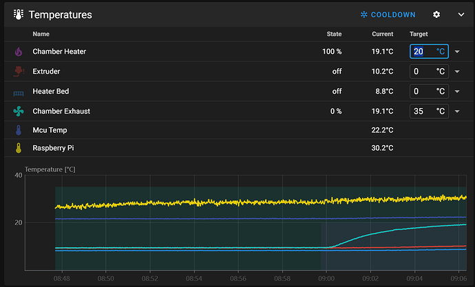

Here’s what my temp graphs now look like while testing the chamber heater. It’s not a very big one, but it at least takes the edge off. It’ll push hotter when the heat bed and extruder are running. It at least helps keep it warm for ASA prints.
What is the config for mcu temp and rpi temp?
I host an internal gitlab repo, so I don’t have a good way of sharing the entire config :confused:
[temperature_sensor raspberry_pi]
sensor_type: temperature_host
min_temp: 10
max_temp: 100
[temperature_sensor mcu_temp]
sensor_type: temperature_mcu
min_temp: 0
max_temp: 100
Oh i see. You have the pi set up as one of the mcus as well. Ok that makes sense. Thanks for sharing. I can get it with this info.
