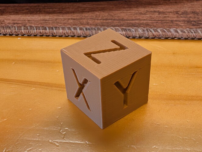

In other news. I got a test cube to print. It’s even mostly all the right sizes. X and Y are a tad low (shrinkage). Z was almost spot on.

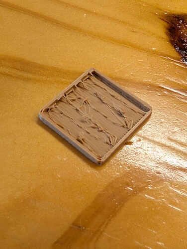

The infill looked horrible, which I think is due to the underextrusion and I have ringing which I think is from printing too fast. I don’t have any accelerometers on this machine. I need to look in my boxes. I think I bought one when I bought all the other upgrades.
Horrible infill
I figured it out!
There were a lot of errors in the console I was missing because I was watching the printer and not the terminal… Unknown Command G2, Unknown command G3. I forgot to enable arcs in Klipper and the gcode was using arcs for all the gyroid infill
I give you a 24 minute xyz cube.
The startup homes the axis, runs z tilt, and gets a fresh mesh. I could speed it up if I had the extruder heating up while running the mesh.
Later I’ll actually test the mesh stuff to see if this fixes the whole reason I went through all the work.
The better power supply is working awesome. No more undervoltage messages.
I also have a chamber temp probe working already. Just need to wire up the heater and exhaust fan and program their configs.
Actual Measurements:
X: 19.9 mm
Y: 19.95 mm
Z: 20.05 mm
Close enough for the girls I date.

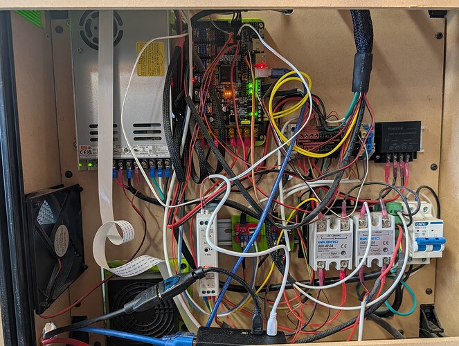

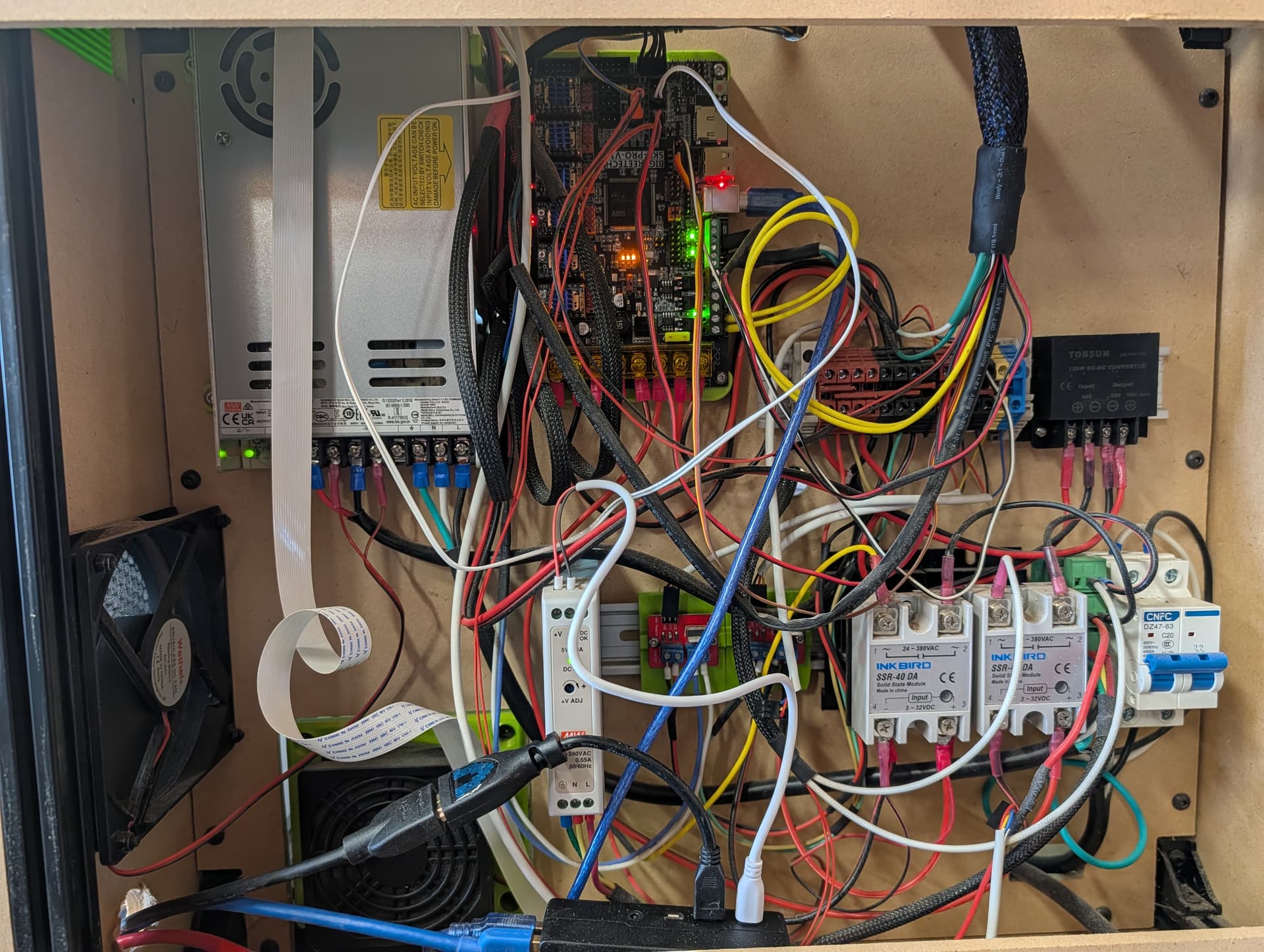

This morning, with the help of gemini, I adjusted my my config to add the chamber heater and exhaust fan. I need to go wire all those to the appropriate plugs later today. Then I need to print a mount for the Pi4.
I kinda wish I had fancy wire management. At lest some of this will get removed now that I’ll have the skr controlling the chamber heater and exhaust fan.
I had to jump through a few hoops for the pi3 to control things via its header pins.
Maybe I’ll do some more cleanup while I’m in here.
I also struggle with wire management. “Functional” is about what I get. I never seem to get the right wire length for what I want and tend to leave wires too long (better than too short, I guess) so they get snarled.
I start off with all teh best intentions but find I a get a bunch of just a little bit too short to router in a neat way so I end up with a bunch taking a shortcut.
Working and hectic, is better than not and clean.
Looking at my setup, it looks like past me was at least smart enough to standardize on some type of color codes… Red is some type of DC voltage, black is ground. white and yellow are AC line voltage. Although Yellow also looks to be the heater for the extruder, but I think that just ‘is what it is’.
I am sad to see I won’t be using the BTT TFT that’s on the front of the printer. I have an HDMI screen mounted up there too, so I guess that’s less of an issue. I guess that’s even more cables I’ll be able to clean up.
I’ll also be switching over to a USB camera with better resolution, so no more flat cables running around the inside of the lid.
I tried so hard to keep my V5 nice, but I wouldn’t even want to look back their right now :man_facepalming: Its easy when you are starting out, but as you add or change things it gets harder and harder. My V4 is straight up just a mess
Wire management is an art form and I am not an artist.
