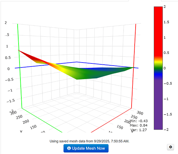

I need to figure out why the MP3DPv4 has a wonky bed. Maybe my aluminum plate isn’t flat? Not sure how to fix that at this point. I do use screws in the 4 corners to build my plate. Maybe that corner just needs to be tightened a bit more.
It does look to me like your right rear is too tight and left rear is too loose. Under 1mm is not actually too bad in my opinion, obviously it can get better
It’s not horrible. I do need to figure out why the printer isn’t actually using this information. I’m working on a rather large print that uses most of the print bed. Watching the first layer print, it still squished the high parts and almost didn’t have any bed adhesion at all on the low parts. I think I missed a g-code command somewhere.
