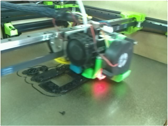

Fan mount… modified.
Used a hot air gun to soften the ASA and put a slight upward bend where the fan hits the print. Then I threw 2 washers under each ear on the z probe.
Everything clears the print quite nicely now.
The printer is currently printing a Wire Mount to bolt onto the aluminum parts to zip tie the wire loom to.
Oh. And I shot a bunch of video of the process of making the mount. I’ll get it mashed together and up on youtube at some point.
Wire tie-down mount is printed. It doesn’t quite fit. It hits the X end-stop. Adjusting design now :slight_smile:
AAANNNDDDDD Done.

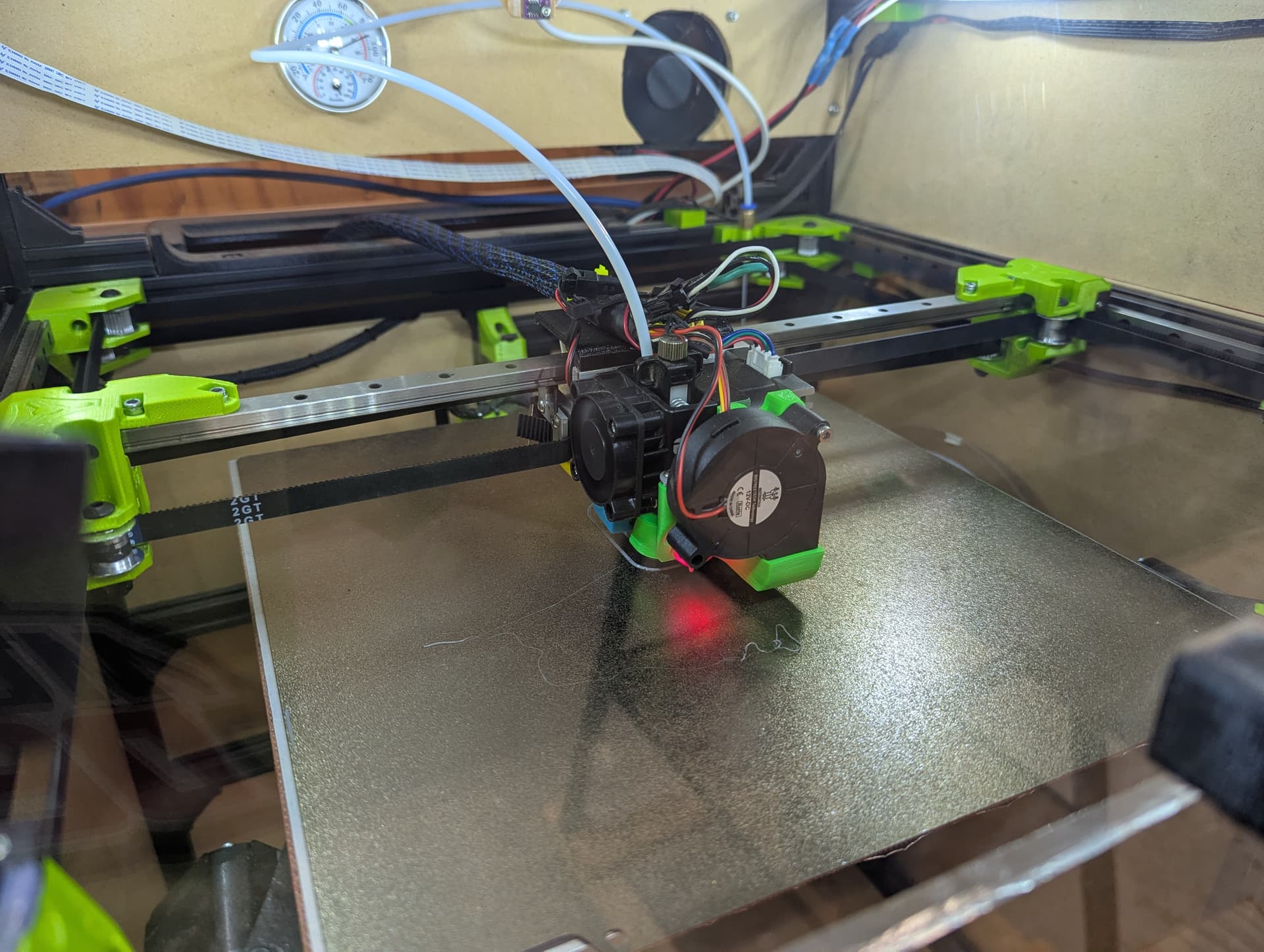

I ordered some more GT2 belt. What I’ve discovered is that one of the core belts isn’t quite long enough to get a good grip behind the aluminum endplates I designed. I’m going to cut new belts with a little extra that I can pull on to help snug up the belts before I use the bolts on the front to fine-tune. I also recut the end plates to help facilitate this.
I’ve finished up a few outstanding projects in the shop, so I’ve spent the last few weeks cleaning and organizing.
At the end of all that work, I finally got around to installing the new belts into the printer. I also made some more modifications to the two clamping pieces I use to hold the belts in. The belts are much more secure on the core now, so them slipping out should be minimized.
I also took the time to change how the X end stop wires connect to the switch. I soldered on a lead to the switch and put a locking connector on it. I kept having issues with the little baby spades popping off of the end stop.
I did some test ‘homes’ and everything looked good so I started doing some quick wire management and discovered that at some point I broke the wires going to the thermistor on the hot end. New ones on order, but testing the printer will be delayed until Tuesday now.
It’s for the better, I need to redesign the to cover for the new aluminum core so I can attach some zip ties to it for wire management. I didn’t even think about the fact the new core doesn’t have the same mounting holes as the last iteration.
Just to re-iterate. The printer printed great with the 3d printed PETG core that was originally designed for it. My only issue and the whole reason I went down this rabbit hole is because printing ASA was causing the PETG core to soften and cause issues with the huge 120v heated bed I have on the machine.
This aluminum core is me trying to fix that.
She’s alive! If you zoom in, you can see the final belt clamp iteration.
