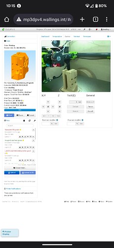

I have a test print running now. It’s looking good. The wife needed the huge print for something she was doing with her students today, so no need to wast filament re-trying it now. Although, she could probably use the things in the future.

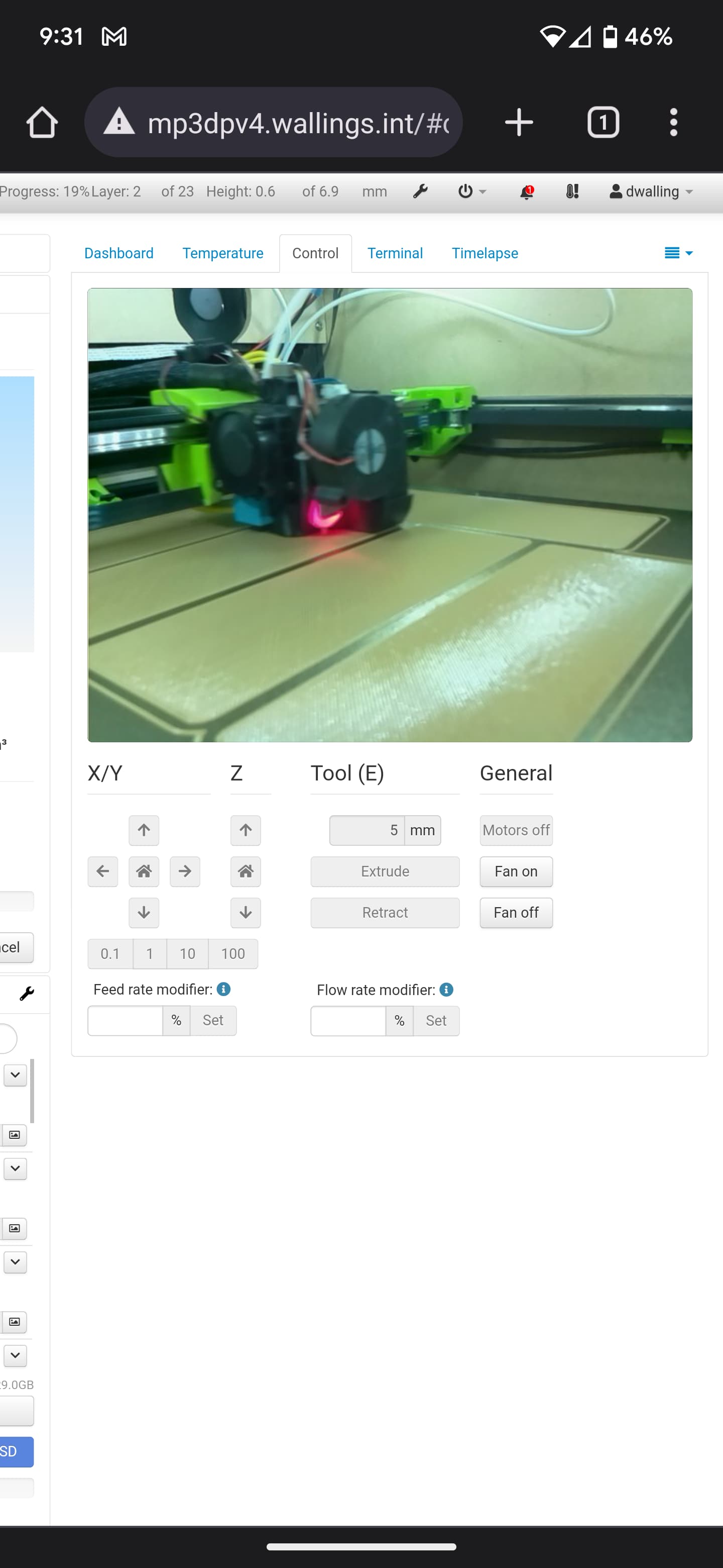

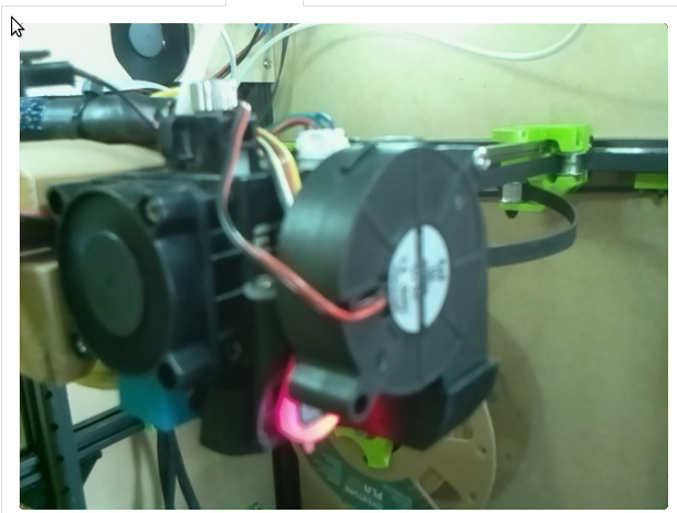

20 minutes left in a 7 hour print and a belt came loose. You can see it loose on the right side of the picture.
I was even watching the print when it let loose, so I killed it. The parts may still be usable. All it had left was printing the top two layers on all 5 parts.
belt_loose_again
That was with the new core?

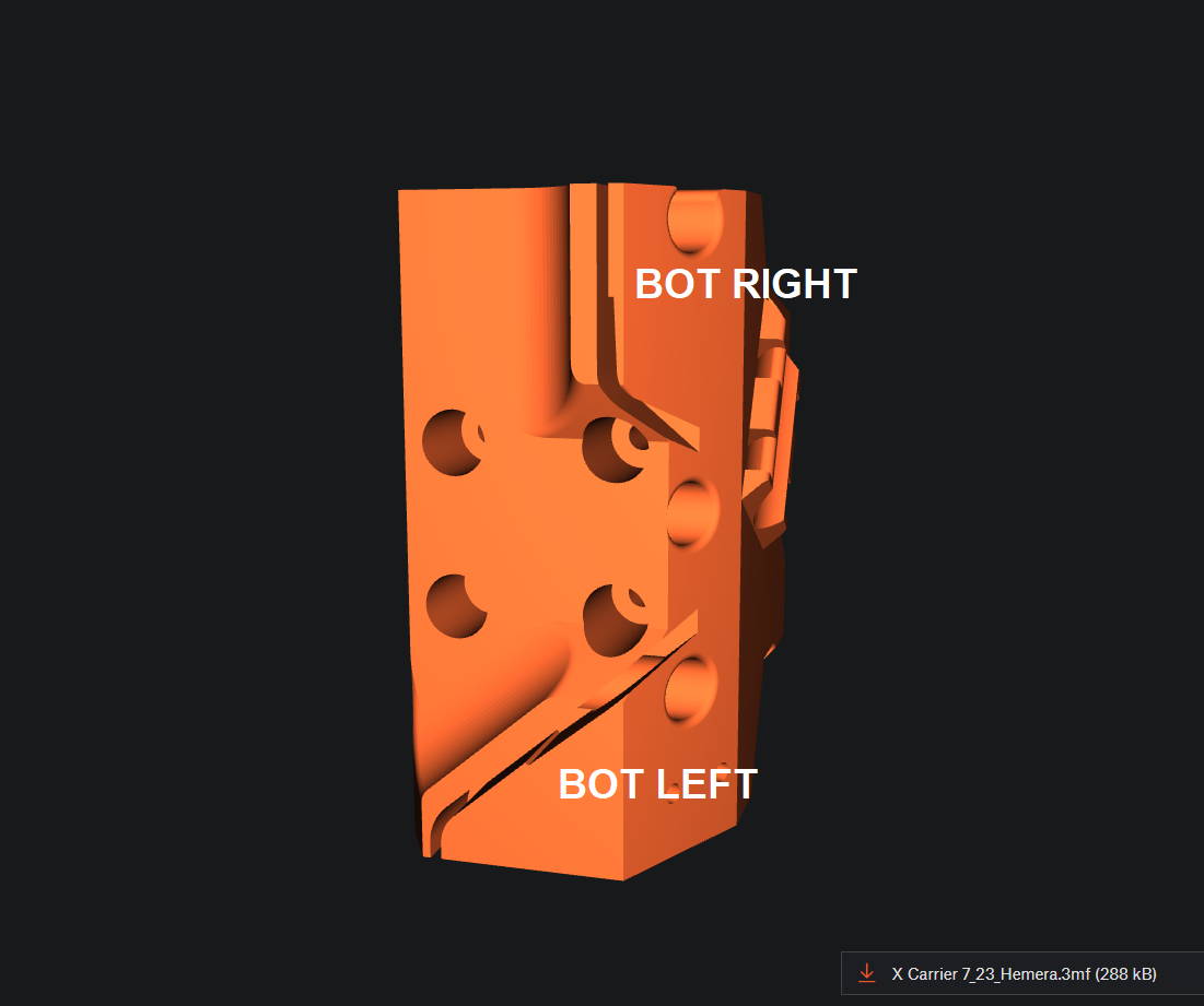

Yes. I’m wondering if my belt ‘wedge’ piece is too small. The one I was using only had 3-4 teeth. I just replaced it with a piece that’s closer to an inch long and fills in the void from where it widens all the way out the back of the core.
It was the same belt side/position that pulled out previously.
https://www.printables.com/model/282346-mp3dp-v41/files#preview:file-QB2Wc
Pulled out from Bottom Right belt holding slot?
Bot left.

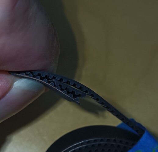

Just tugged pretty hard on my belts, they’re not coming out. But then I haven’t done tons of printing with my PETG Core. Just 5-6 teeth on the short Belt bits, I couldn’t get belt to double back on itself.

I have video of the last failed print. I’ll have to go watch it to see if I can see the small piece of the belt wiggling loose or something. The camera angle is bad for seeing under the printhead.

It pinches down to a few tenths of a mm over the width of one belt. After printing, that usually means it is the exact width of a belt. The angle is so it is easier to get a doubled up belt into place and then pull it into locking position.
