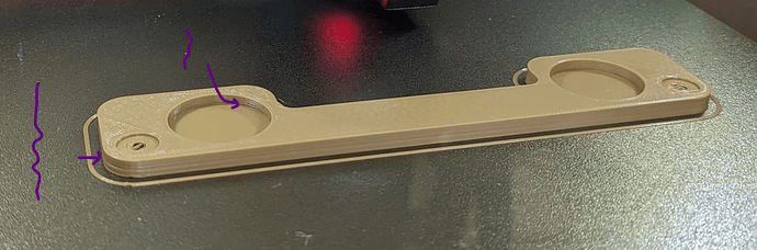

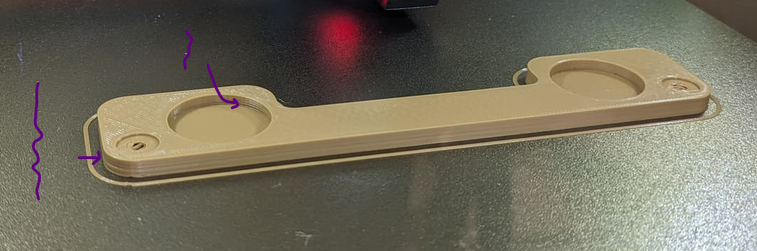

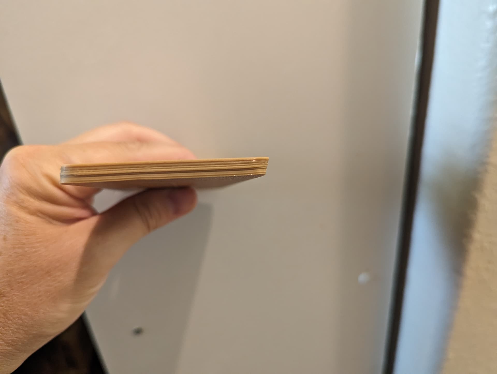

I’m talking about the prints I printed after replacing the core. I printed a bunch of bead holders for my wife that were about 8mm high. There was a noticeable ‘slope’ to the print.
Picture of slope. Kinda hard to photograph, but the edge on the right should be vertical.
Oh that is a rough print.
Hopefully the belts are just so tight the steppers are having a hard time rotating.

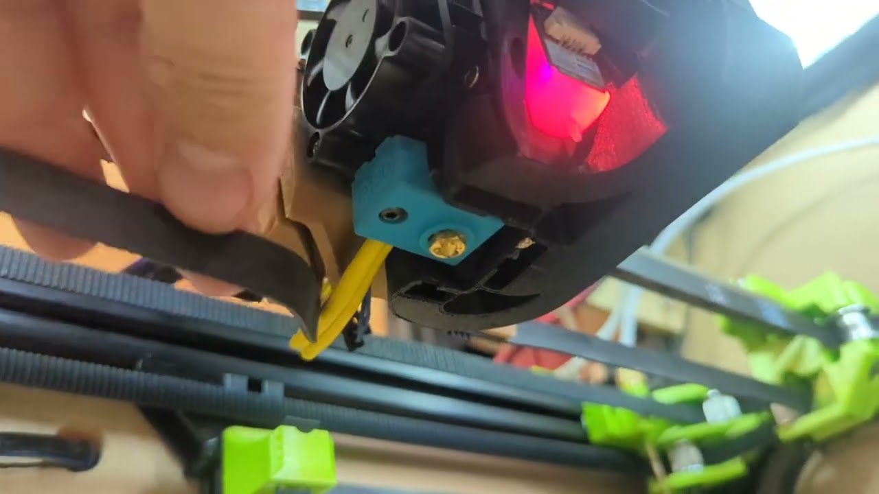

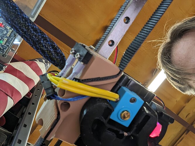

Sort of. This last one did not go well. Walked out there and the one belt was loose.
I’m thinking I’m starting off too tight and the extra stress is causing it to go loose.
I also discovered while out there that the extruder was a little loose on the core. I tightened those bolts back down.

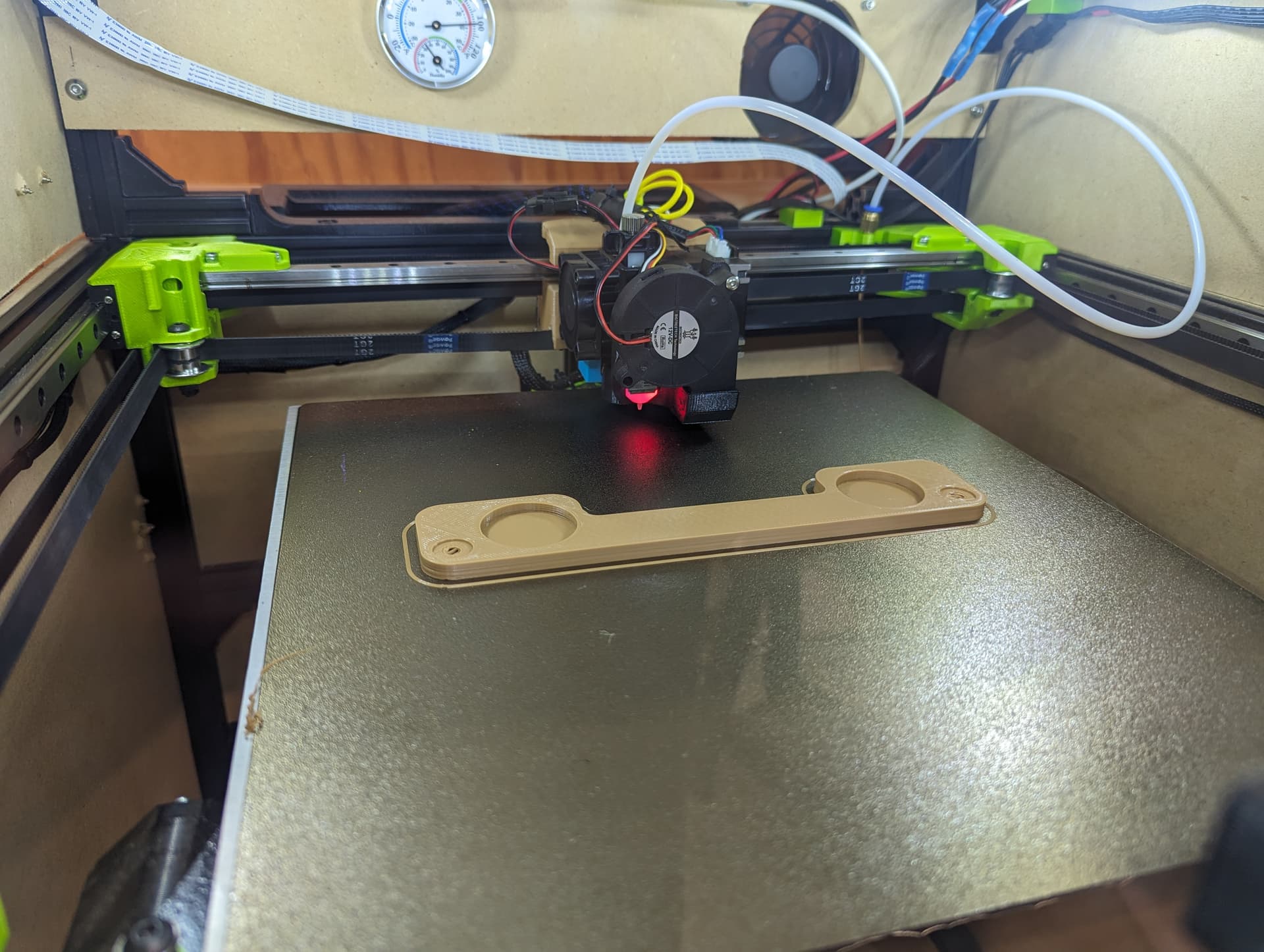

I’m still thinking the extra heat we’re having here is causing issues. I’m going to run the next print with the front door on the printer open. Right now I’m going through a bed mesh level because I think the one I ran earlier today was with the loose extruder on the core.
3 failed prints today.
All 3 the belt loosened up during the print.

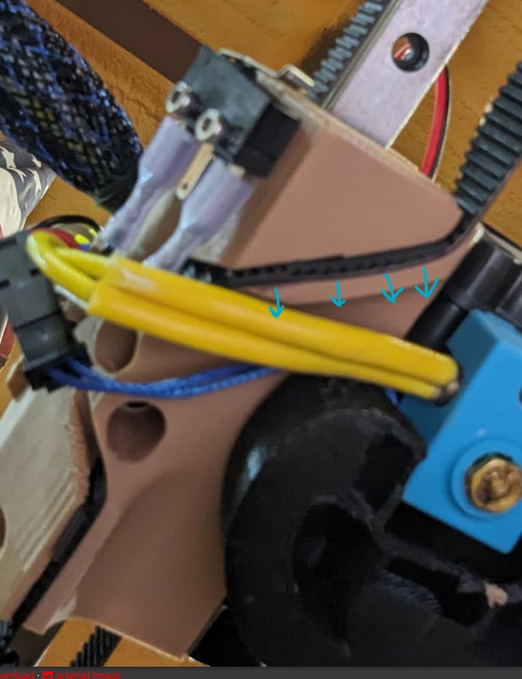

Once that part gets stretched out glue is the only thing that will keep a belt in while you print a new core.
Did you figure out if it was too tight? We have similar climates, I am trying to figure out why this keeps happening to you and not me, we also both use PLA. So wither the prints are super loose and the belt slips though, or they are too tight and stretch the part.
I just not sure the best way to put the belts in otherwise.

I see that print is pretty rough, but there is no way in heck I can fit three belts in there. So I am not sure if it stretched super crazy or the print is just way off.
Just to triple check this, on the initial assembly on the fresh core. When you put the belts in there you do use the little 1mm notch as the stop for the second little locking piece right? Like you put them in and pull it to lock it in place?
I’m thinking I might not have used the notch correctly last time.

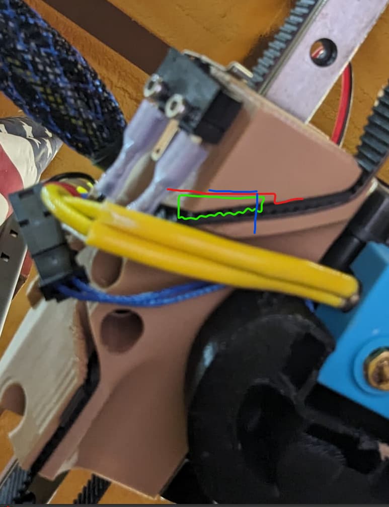

Quick and dirty.
This is the wedge idea. Expand the slot to the red line. Green is a separate wedge piece. That blue represents a bit that traps the wedge and belt from falling out.
The wedge can provide more holding force, and is easier to use. The slot can be wider so it is easier to feed the belt in.
The drawbacks are more pieces, the wedge will need to be printed flawless to interlock with a 2mm belt, and this will kill some of the adjustment that is possible.
Looking at how yours is failing, though, it looks as if the small wall is bending out.
No, something is still off, these walls should be perfect.
I like your wedge idea, but I’d add a 3mm hole perpendicular to the wedge that I can thread a 3mm bolt into and clamp it in place. A touch of superglue on the threads to lock it in place.

At 0:53 in your video, the belt just falls out :astonished:. Was it like that when the Core was first printed?
For me, my belts were a PITA to add/remove, Core holes were very tight…
If belts were always loose, then am wondering if under-extrusion caused Core slots to be too loose?

I keep going back to it being a combination of over tightened belts and excessive heat causing the PLA to flex.
I know Ryan says he has the same temperatures, but I’m running a full enclosure. I’m wondering if heat from the hot end or bed is getting trapped near the core. I know I had to take the fan shroud off and use a hot air gun to heat and flex the back part up because it had warped down towards the bed and was lower than the tip of the extruder. I discovered that issue when the fan shroud started acting like a scraper and was popping parts off.
In underextrusion, the location of holes would not be incorrect. There would be too little material present, so gaps would change, wall thickness would change, part adhesion would change, part strength would change, and because of these, stretching and sag would be worse aside from gaps being too large. There’s at least some hints of that above in pictures of the gaps and flexing of the belt retainer slot.
Overtightened belts would make all of that worse.
Do you have an extra thermistor pin on your electronics? I wonder if it might be worthwhile to wire up a temp sensor to place somewhere up on the assembly to measure what temps that part is seeing inside the enclosure.
