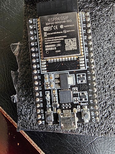

The ESP-32, and specifically the ESP-32 chip on the dev board, is the brain of the whole output. The FluidNC firmware runs there in the two processor cores, and the WiFi and Bluetooth hardware live in that chip.
There are variations among ESP-32s, and depending on who built the dev board and how well they spec’d coponents or made modifications, some work great, some not as well.
The ESP-32 has a pin that does double-duty. At boot time, this pin (BOOT0) tells the ESP-32 whether to load user firmware, or to enter the boot loader. After boot time, this pin is used as a UART, and that UART talks to the TMC2209 drivers to configure them.
On some boards and in some circumstances, the weak pull-up inside the ESP-32 chip is inadequate, and the results could be that user firmware never boots, or potentially the board can’t be put into boot loader mode without the user pressing some buttons on the board.
Additionally, if the pullup resistor value isn’t well chosen, that pullup resistor will interfere with the communication between FluidNC and the TMC2209s after the firmware is running.

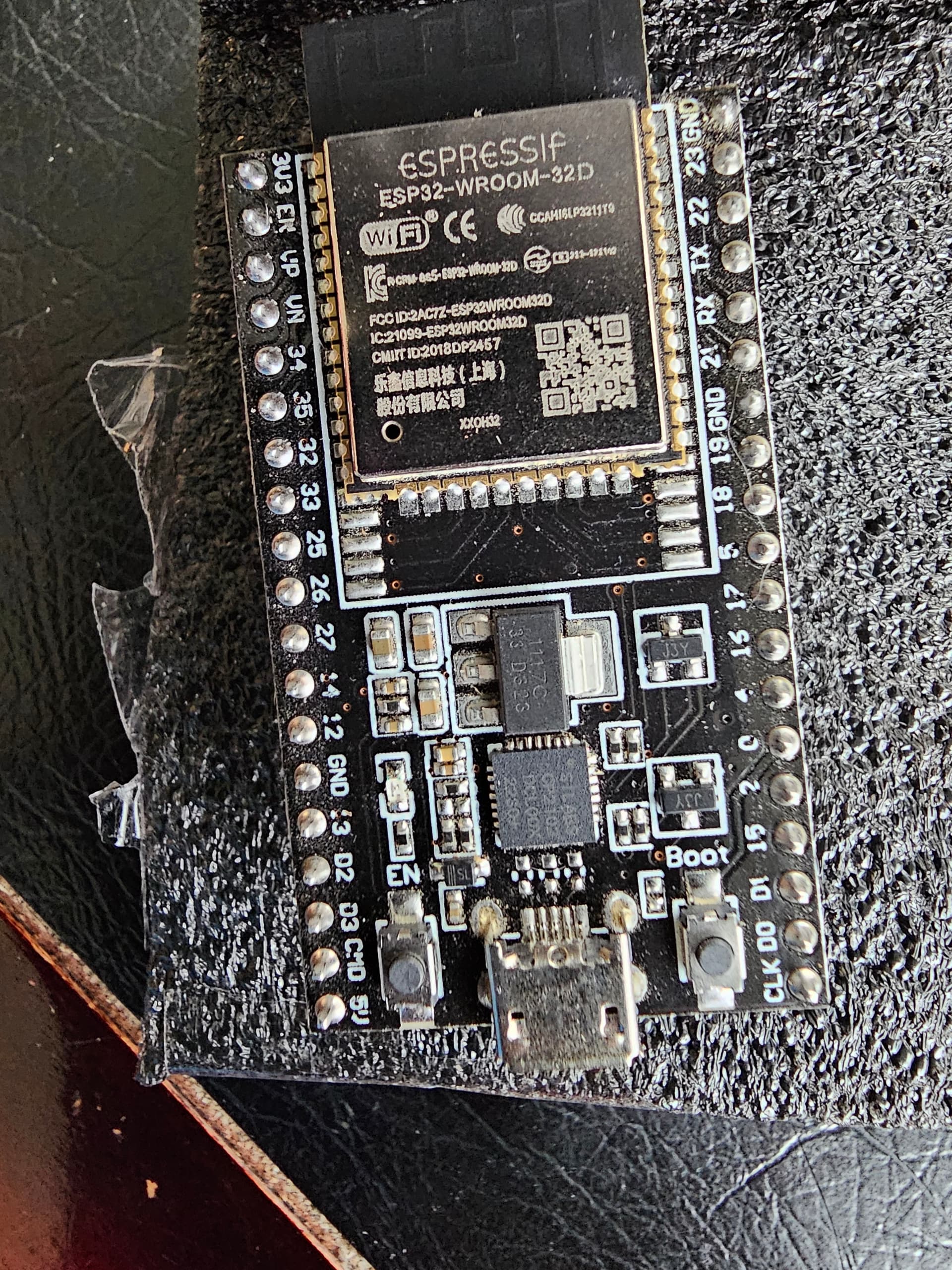

I will take care of it, I just need your info. You have a v1.2 so you already have the resistor, do not add another. I got your thread confused with another. (ps the test is just htting the reset button 10 seconds or so after powering it up). If it boots it was a resistor issue.

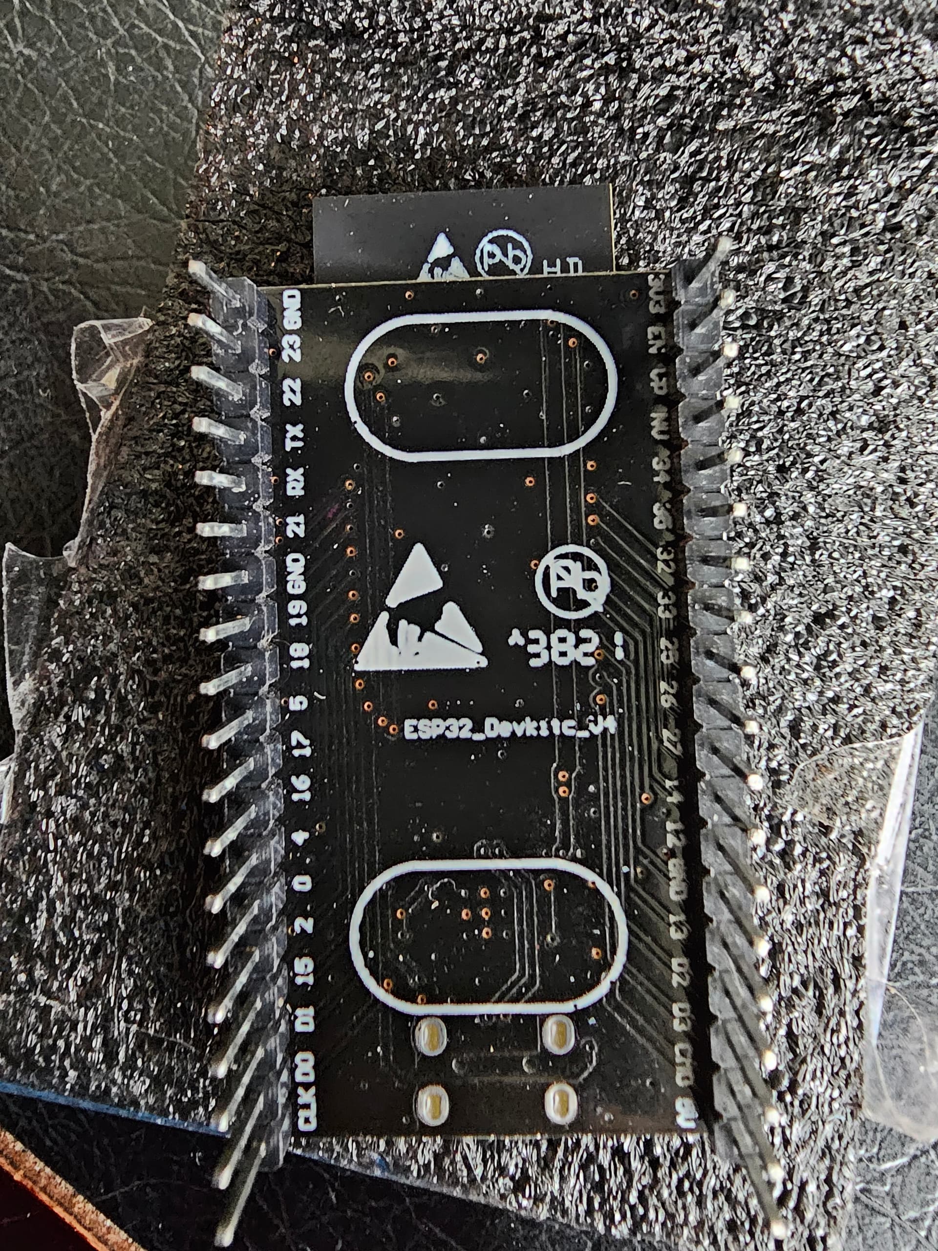

Kinda looks like you have a genuine ESP32 as well but I need to see the underside of it to be sure.
If you do have a genuine I will need to get both back in here for testing to see what is wrong. This would not be a common scenario. We have only had the generic ones fail after the fact.

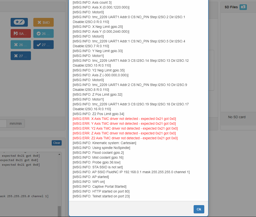

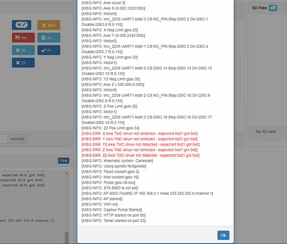

I pulled the board to get it ready to box up and ship before I leave town. As I’m sitting at my desk the earlier remark of [sic] “you have 1.2 so the resistor is already there.” flashes so I decide to put the esp back in the board and try again. I’d been assuming the needed resistor was on the chip, but thought I might have been reading it wrong and it was on the board.
So back together, power, hold boot for 30 seconds, reset for 20, release the reset and 10 seconds later release boot.
I tried the windows erase, and fails with the header message. I tried the windows, and it connected with the " There was an error during boot, likely due to an unvalid configuration.
Click here to see details" message.
I’m unaware what ‘unvalid’ means but it’s not my place to worry about typos. Anyway over to the file section and it allowed me to upload the v3 yaml file. So that was new. I wiped it and downloaded the v2 files, and it took them all.
So reboot it again, and it appears to boot again with the same unvalid messange. Details:

[MSG:ERR: X Axis TMC driver not detected - expected 0x21 got 0x0]
[MSG:ERR: Y Axis TMC driver not detected - expected 0x21 got 0x0]
[MSG:ERR: Y2 Axis TMC driver not detected - expected 0x21 got 0x0]
[MSG:ERR: Z Axis TMC driver not detected - expected 0x21 got 0x0]
[MSG:ERR: Z2 Axis TMC driver not detected - expected 0x21 got 0x0]

Everything is green except the xyz drivers are missing and those error messages are in red. If that’s referencing the driver chips, they’re all installed. And the error message was talked about as being because the config file was not installed, but it is definitely there now.

The stepper drivers and rest of the electronics on the Jackpot do not work if the board is only being powered by USB.
The real test is with the Jackpot connected to VMOT (Jackpot board) power.
If it boots and comes up reliably in that configuration then the board is working.
That was going to be my thought as well.

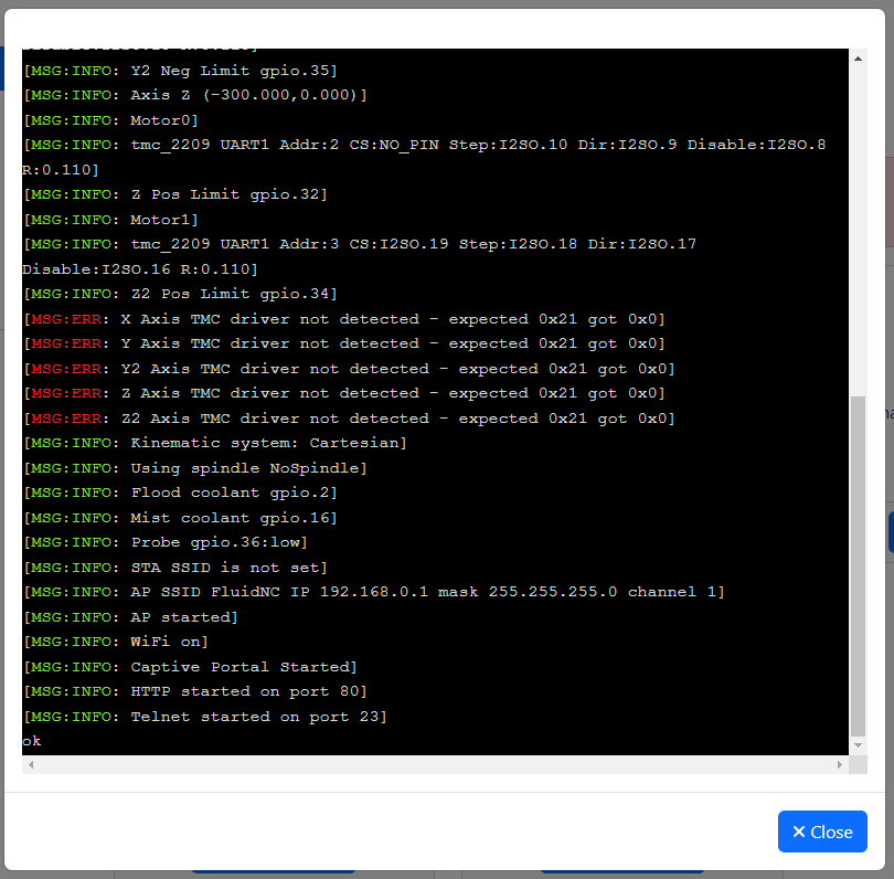

Running on usb I could connect by wifi and got to the control screen, and the same driver errors.
Everything else looked normal.

The way I debug those is to run FluidTerm while testing. I’m not sure what exactly happened, but it looked to me like there was some kind of issue when homing to Zmax, that cause a crash/reboot.
Your 2nd connection showed you the crash dump, FluidTerm would have caught that in real time (and be cut/pastable).

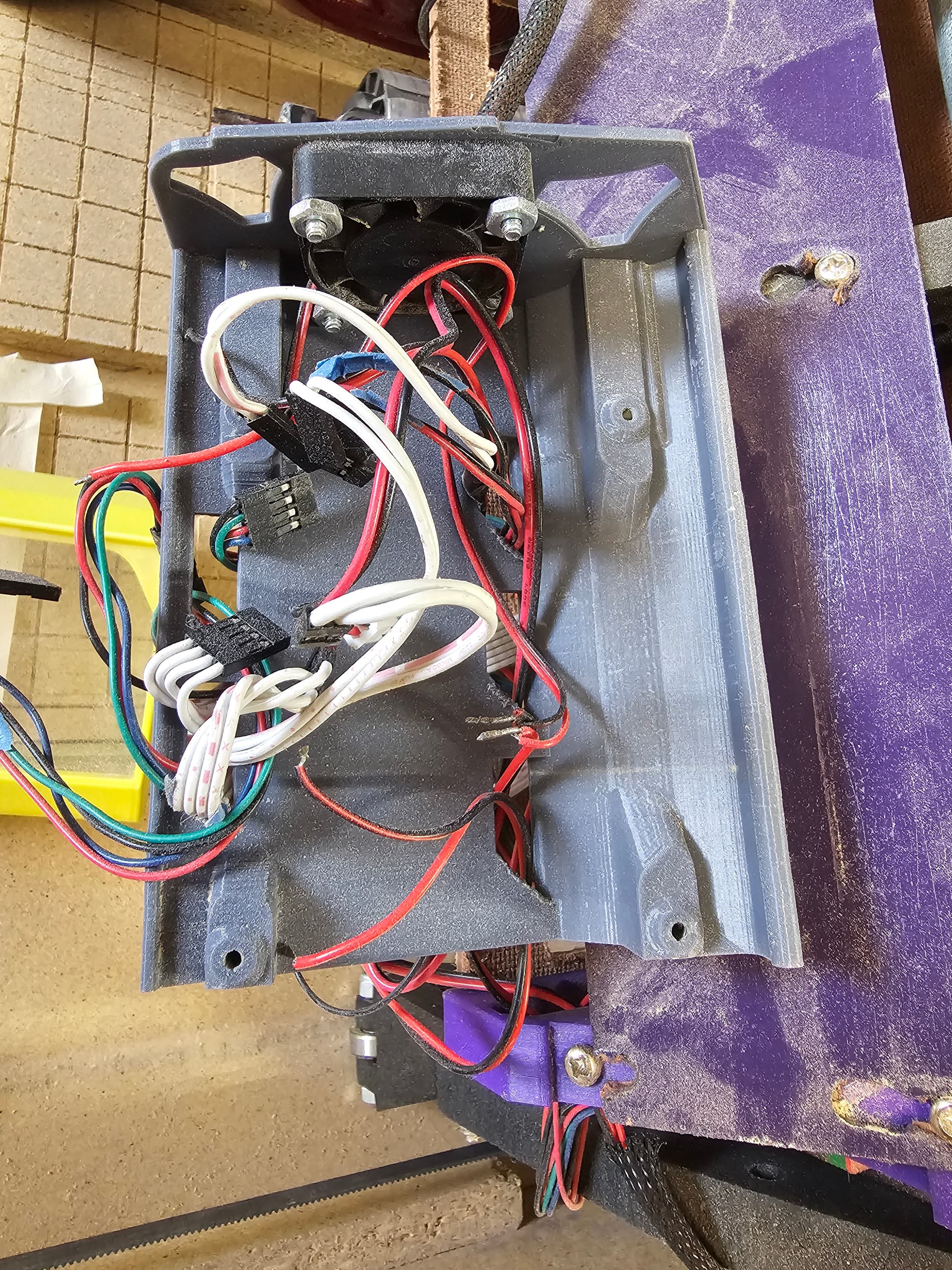

What was plugged into the 5v and mosfet ports? It tests fine on my side, been sitting at a very cool temp everything seems to work as expected?

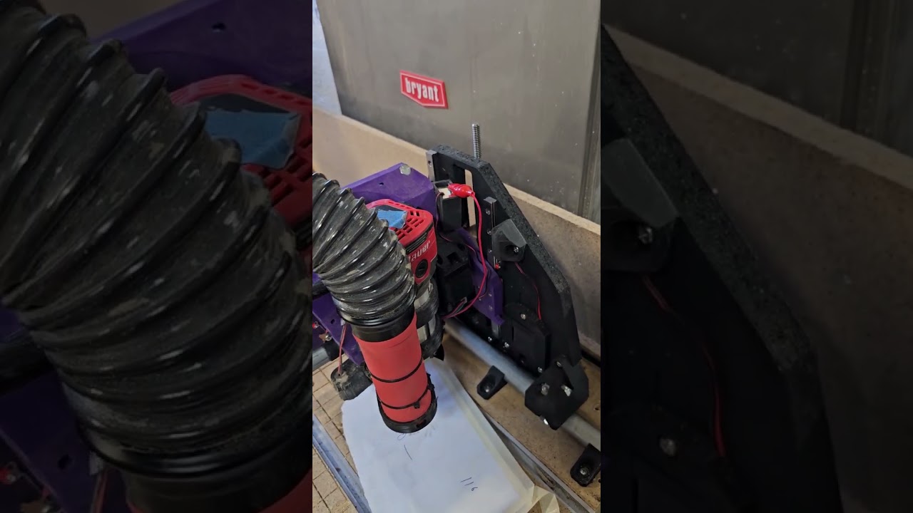

I have a laser pointer on the 5v, mosfet is a 24v/110 relay for the router control. It sits elevated with a cooling fan that’s hooked into the main, so it’s on whenever the machine is powered on, the only contact is the screw posts.
It’s been wired up this way since the beginning.
Whenever it stops responding leds are still lit and appearance wise or loss like everything is on and normal. When it had stopped resounding during use, it keeps working normally until the cut is dobe, so it’s still processing the gcode normally, but then it just ignores everything until in powered off and back on.
