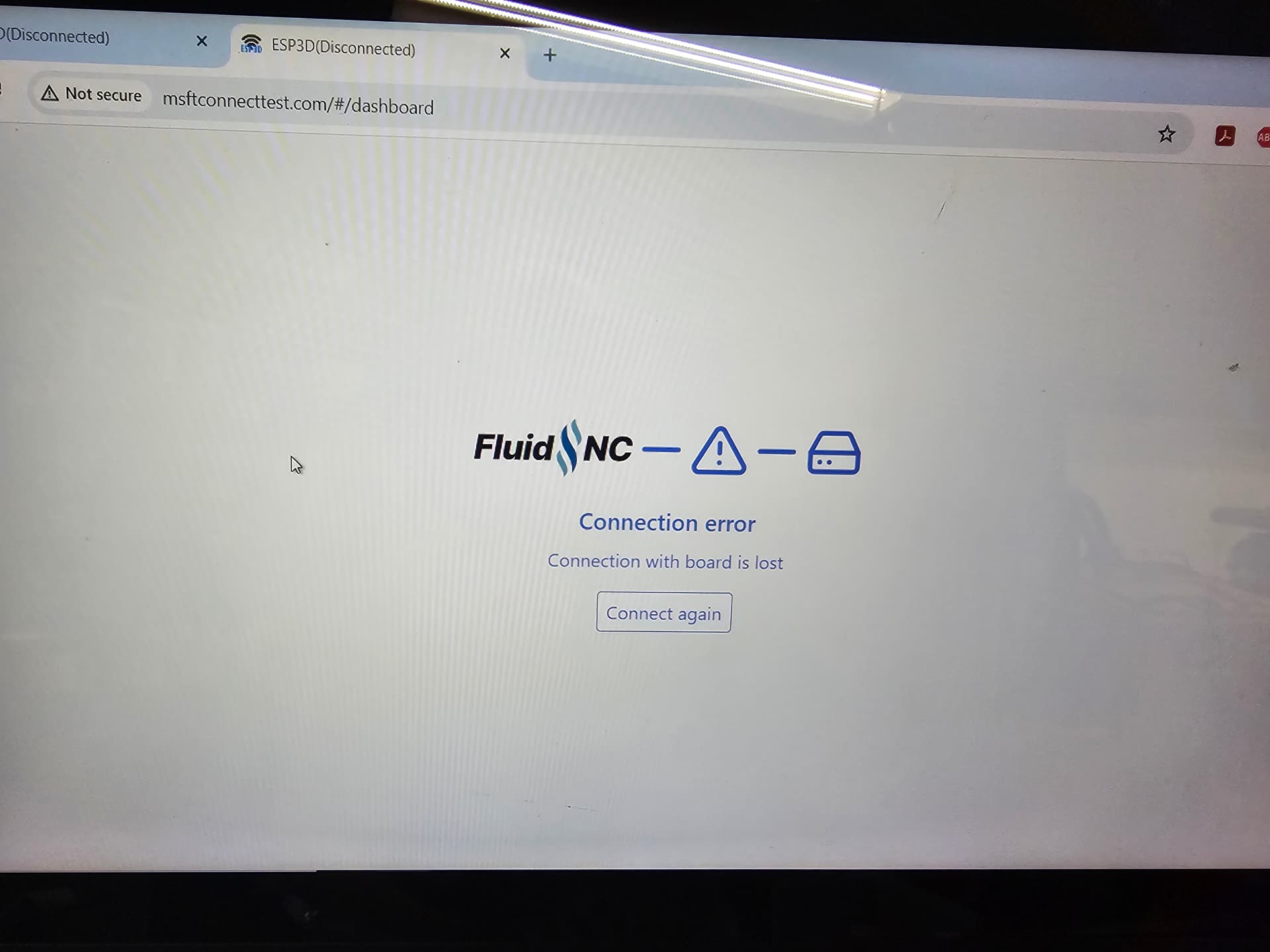

No wifi, no connection to the board

So what tests might I run to cause an issue, any way to be sure it happens? I had it sitting here powered on for about 45 minutes yesterday and I could log in the whole time.
I don’t know. When I pulled it apart again it would respond to homing all, then trying to jog z a few times and it repeatedly failed.
It’s been running normally for quite a while, then it started not responding after cuts were completed until it was powered off and back on, then it was failing before cuts were made, then I couldn’t flash it, pretty much everything in this thread. I have no idea how to troubleshoot it, just that it wasn’t working correctly.

Unfortunately, if the ESP is good, the board is bad. Everything is put back together, connected and it made it through squaring the other day. Today I was leveling and it started into the exact same issues but with “error:152” in red. Multiple power on/off and it was then at least working for a bit so I decided to just go with it. I have cabinet doors off and my wife has hinted she would like them back on…
I was doing my 1st test cuts to measure square in actual use and it shut down entirely, displayed “websocket connection error” in red. The LED’s on the board were still lit up but all movement stopped. It had been actively moving for maybe 5 minutes.
It seems to connect initially, but after being on for a while starts having problems.

The disconnects started during squaring. As before the wifi still shows it’s connected but it doesn’t respond to any controls. After a minute or 2 the web interface changes to the generic no network page, but wifi still shows it’s connected. I then connected by phone and got the same result.
Turning the machine/board off and back on, it reconnects and works normally for a few minutes, then repeated the disconnects. So it loads fine, then stops after a few minutes. I haven’t thrown a stopwatch on it to see if there’s any common run time before it happens, but that will likely happens soon. I don’t expect to get any usable info, but curiosity is what it is…
The disconnects continued while I was leveling the gantry, the only thing I changed was the z1 pullback after homing. During this process it was rehomed Z repeatedly, it was power cycled several times.
The websocket error popped up mid-cut, the 3rd test square, no power cycling so it was up and running for a few minutes. I’d done a 2x2 square to check diagonals, did a 2x8 rectangle and checked the diagonals, and was doing a 10x10 when it just shut down. There was a couple minutes between each cut while I measured and loaded the next file, Gcode generated by vectric vcarve pro. It had been up and running for several minutes, so the configuration had been loaded and had been untouched.
I’m in AP mode, connected directly to the board, not going through my home internet.
I was REALLY hoping to hear about a physical issue I could look at and hit with a soldering iron. I was thinking websocket was an actual socket on the board, google says I was thinking incorrectly.

Reset again and I’m going to leave it powered up over night and see if it will stop just from on time or if it correlates to movement.
Did you ever confirm the details of how you’re powering the Jackpot?
It survived the night, it was still connected this morning. I jogged it twice, homed all, Z homed, Y homed X started homing and then it died, connection error, websocket error, connection with the board was lost.
24v power supply brick, same one I’ve been running since the initial primo build. I haven’t put a MM on it to check voltage but I’ve never seen the LEDs on the board flicker or go out so I assume it’s been receiving voltage the entire time.

Slapping a multimeter on it would be a good idea. Making sure the wall plug to power supply box is good (we just had one that needed a pin bent out a bit), and looking at your through hole solder points is another check I already mentioned.
Having it fail for you during moves is a usually a smoking gun to something loose. Or something making contact that it should not.
Ryan tests these thoroughly, so if there is something wrong it is in the way the ESP-32 wifi stack, or FluidNC, or both interacts with your local network setup.

I was on the verge of scrapping a somewhat expensive board, and it turned out to be the power supply. It would produce 25V when not under load, and could power the processor on board, but when it enaed the motors, thenPSU would sag badly, and everythjng would stop. I was pretty sure it was the motor drivers (onboard) so was about to replace it all.
Glad I checked with another PSU first.
