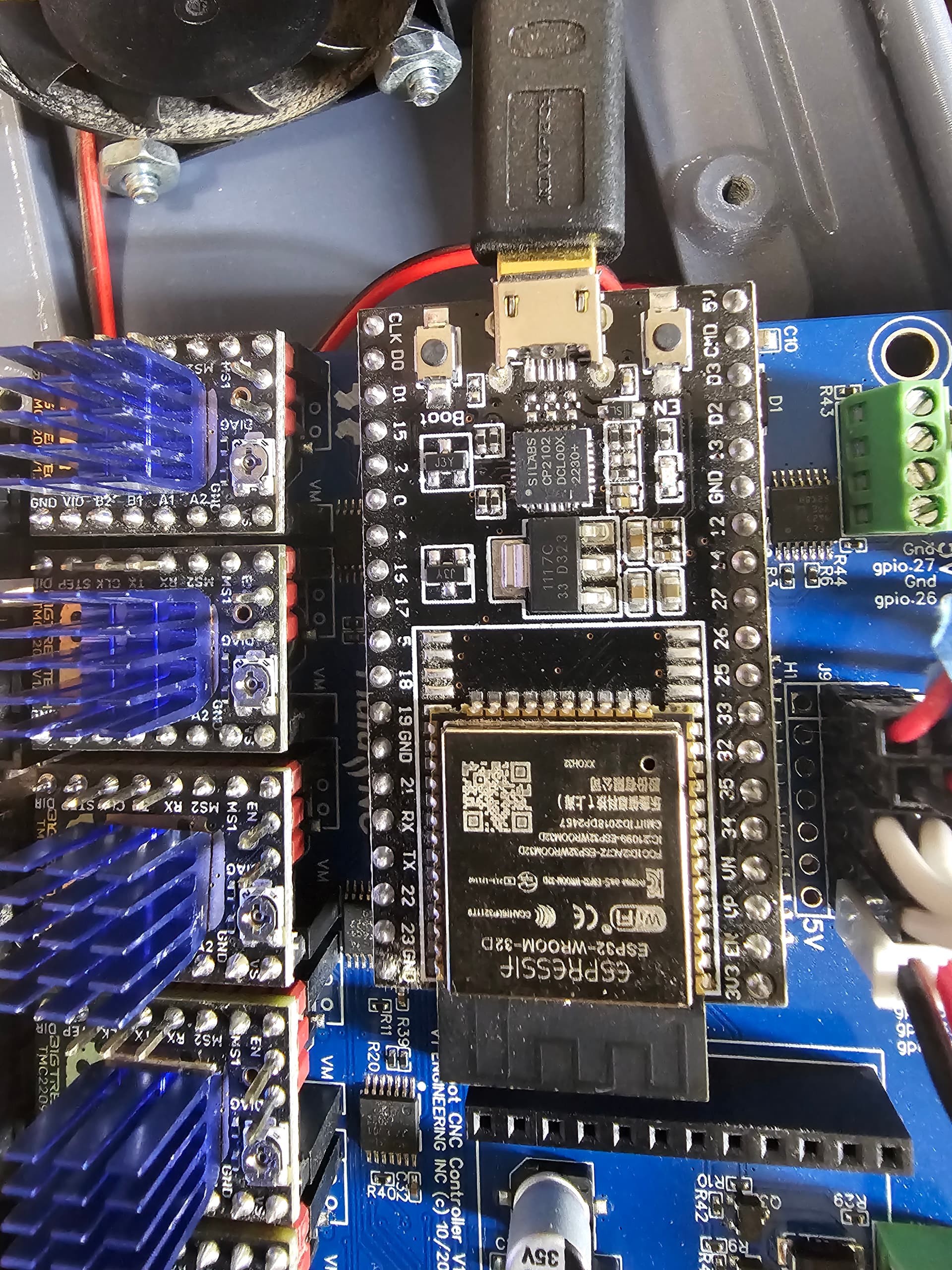

Yay, more issues with my jackpot! I’ve been having connection issues for a while, requiring powering down and back up to get my jackpot to actually talk with the web controller, even though the wifi shows it is connected. I’m almost in the habit of just power cycling at the end of every cut.
Today though, no wifi whatsoever. I’ve cycled power repeatedly and the board doesn’t appear at all as an available network. I’ve tried my computers, my phone, everything that is wifi capable and the jackpot does not appear to exist at all. It’s definitely powered on, LED are lit, steppers are locked, but no way to communicate with it.
I’ve checked wire connections, everything is tight. Is there a way to reset the wifi, any other ideas, or am I just dead in the water here?
Can you upload a picture of your board so I know what you are using please.

Gaaah. Make life easy on yourself and pull the esp32 off the jackpot to update it - I wouldn’t think it’s terribly good for your laptop to put external power IN through the usb port.

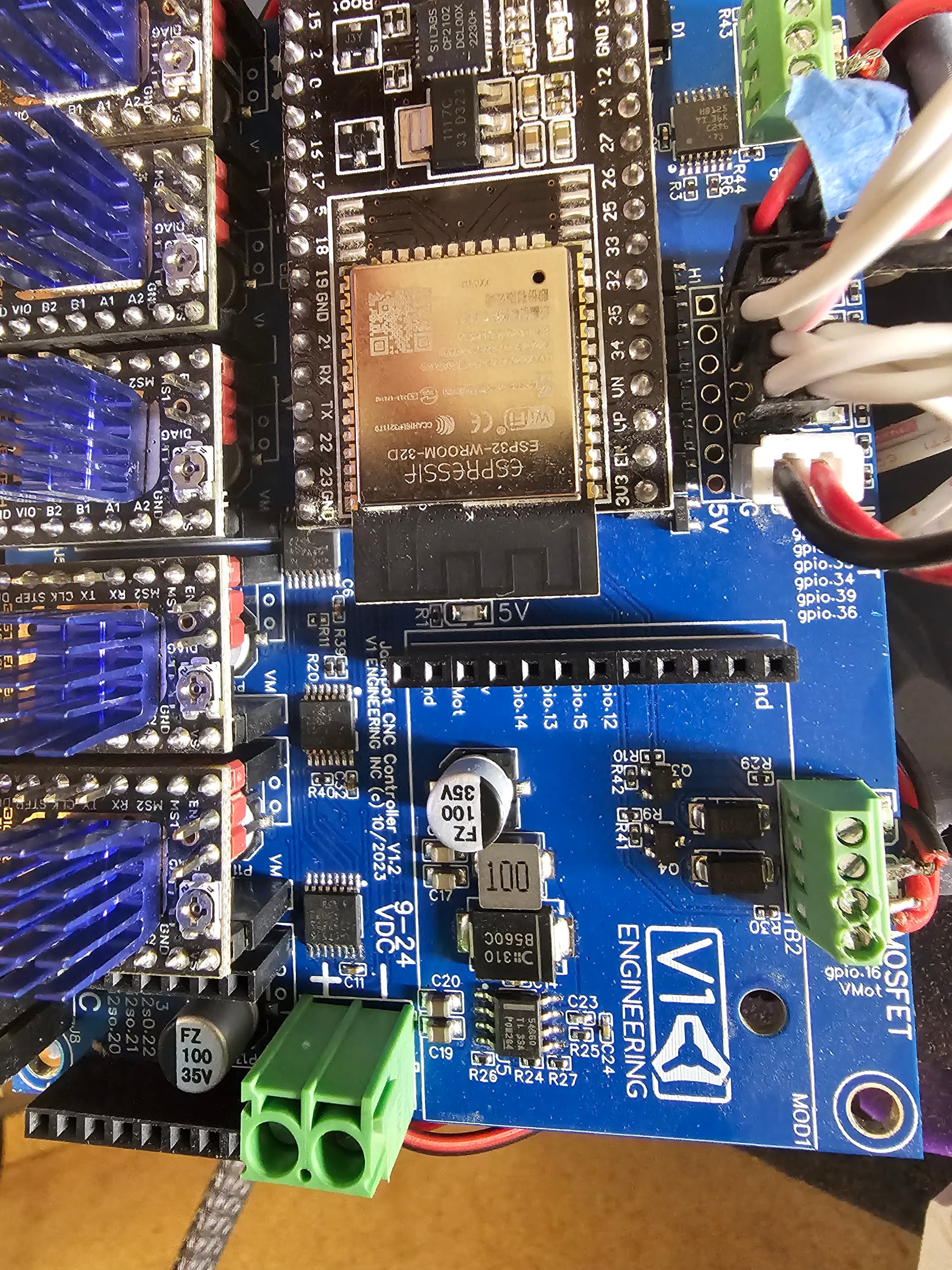

Other thing I’d check is put a multimeter on your power terminals on the jackpot and confirm the voltage. What amp/watts is your power supply?

I can’t see the info on your boards, a picture would really help me quickly identify what you are using.
The boot switch is labeled, you are using the right one, you only need to hold it for like 3 seconds then let it go and erase and update fully. this takes a few moments.
From there you will need to use the files proved further down on the docs jackpot update section. V2 for whatever machine you have. The file upload takes several minutes.
After that power off completely then boot and everything should be fine.

There’s a blocking diode on the system,.
When the ESP32 is only connected to USB only the ESP32 is being powered.
That’s normally bad as FluidNC can’t see the electronics on the jackpot.
It’s not a problem at all for doing an install, and effectively is no different than pulling the ESP32 (at least for the install process).
Pulling the ESP32 is only really required if one happens to have an old Jackpot board and certain less than well behaved ESP32s.
