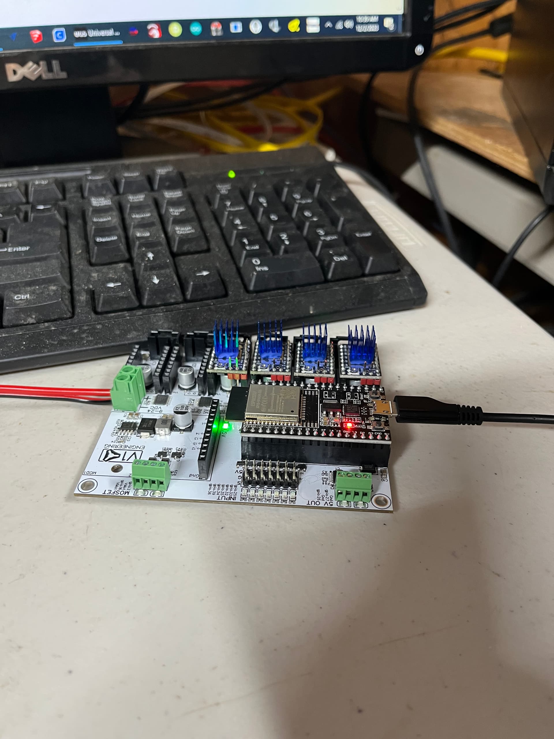

X will move in the positive dir about 1/16 inch one time and then no more movement +/-.
Y works
Z works
A works however it moves in the same dir for both + and - moves.
Have swapped drivers around several times, makes no difference.

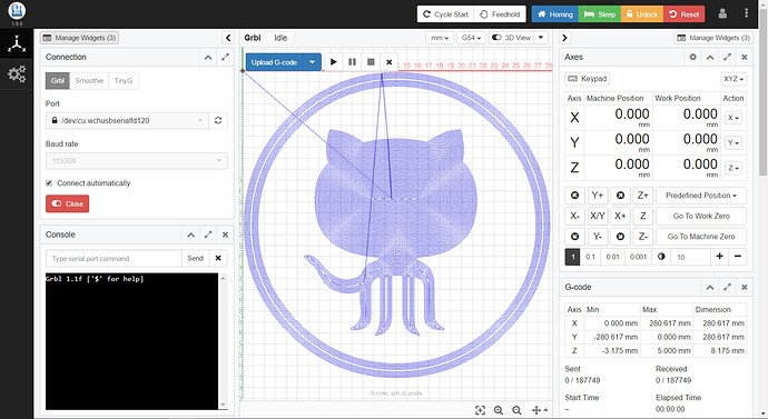

It thinks your endstops are triggered.
Do you have endstops? If so I am assuming they are wired Normally Open?
Is that your CNC.js console? You should try CNC.js for testing that has been verified to work.
I have nothing but the board laying on a plastic table with nothing connected except power and USB

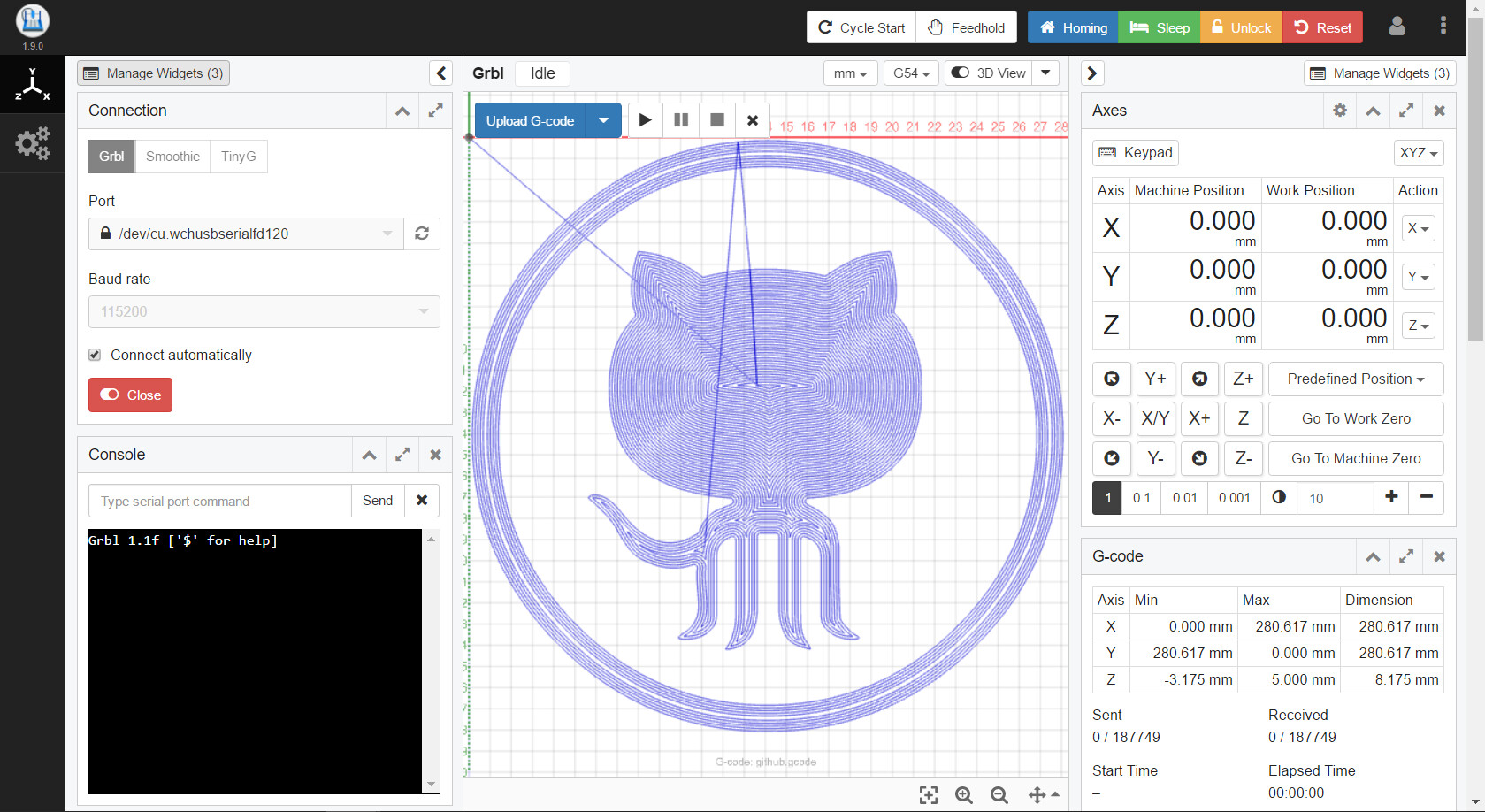

I downloaded CNCjs and took a look at it. I cannot make heads or tails out of it and I have used almost all of the GRBL senders out there. This interface looks like nothing I have ever seen…
Is there anyone out here that uses a gcode sender other than CNCjs.
If you use endstops they need to be plugged in, at this point it seems real testing is needed so you might as well.
Does it look like this? The connection is on the left, g code preview in the middle, controls on the right. I would think it is very similar to all other senders.

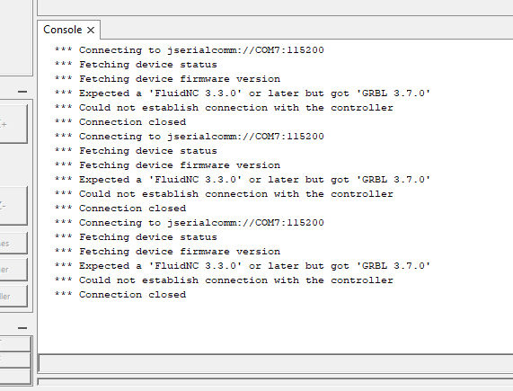

Your sender says “connection could not be established” so I think the built in sender is the best bet for now, and the only way I have time to test.
I have nothing plugged in to anything except motors to drivers.
