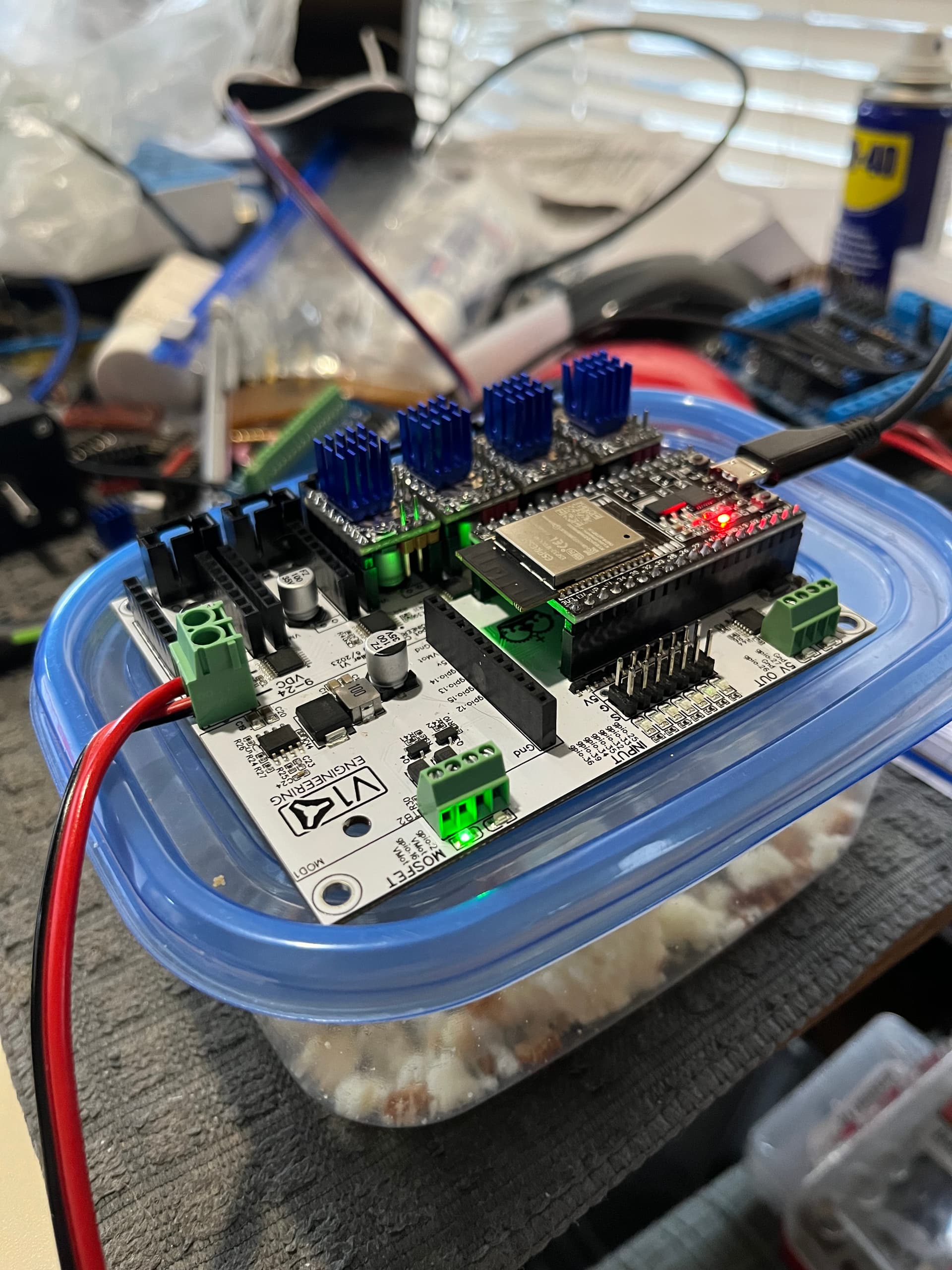

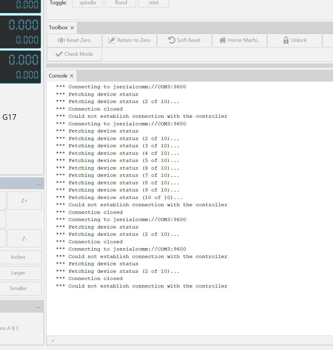

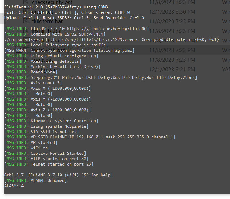

No stepper movement with new Jackpot board

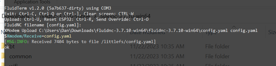

Just compress it as a ZIP file and attach that.
No problem. Do not try to upload again. Thanks Dan
I was uploading it when you replied. It’s there if you want to try it. You’ll probably have to change the steps per mm in A.
Just be careful not to add any extra spaces.
Those red warnings usually mean the board does not have power other than USB.
Only 4 drivers are in the board.
board: Jackpot TMC2209
meta: 11-29-2023 RyanZ
planner_blocks: 32

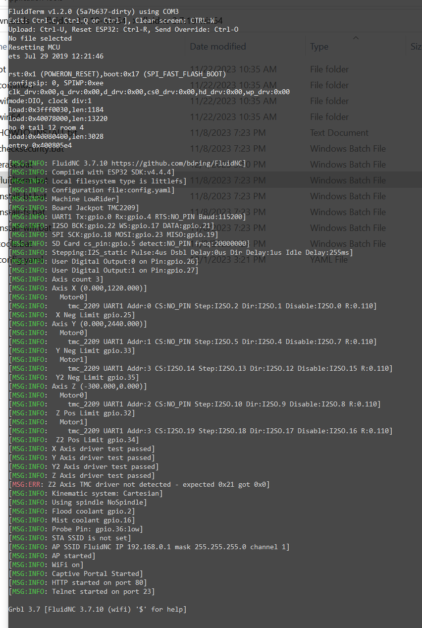

MY LATEST YAML file
Yaml with commented excess removed
planner_blocks: 32
stepping:
  engine: I2S_STATIC
  idle_ms: 255
  pulse_us: 4
  dir_delay_us: 1
  disable_delay_us: 0
uart1:
  txd_pin: gpio.0
  rxd_pin: gpio.4
  rts_pin: NO_PIN
  baud: 115200
  mode: 8N1
axes:
  x:
    steps_per_mm: 50.000
    max_rate_mm_per_min: 9000.000
    acceleration_mm_per_sec2: 200.000
    max_travel_mm: 1220
    soft_limits: false
    homing:
      cycle: 0
      positive_direction: false
      mpos_mm: 0
      feed_mm_per_min: 300.000
      seek_mm_per_min: 1500.000
      settle_ms: 500
      seek_scaler: 1.100
      feed_scaler: 1.100
    motor0:
      limit_neg_pin: gpio.25:high
      limit_pos_pin: NO_PIN
      limit_all_pin: NO_PIN
      hard_limits: false
      pulloff_mm: 4.000
      tmc_2209:
        uart_num: 1
        addr: 0
        cs_pin: NO_PIN
        r_sense_ohms: 0.110
        run_amps: 0.680
        hold_amps: 0.500
        microsteps: 8
        stallguard: 0
        stallguard_debug: false
        toff_disable: 0
        toff_stealthchop: 5
        toff_coolstep: 3
        run_mode: StealthChop
        homing_mode: StealthChop
        use_enable: false
        direction_pin: I2SO.1
        step_pin: I2SO.2
        disable_pin: I2SO.0
  y:
    max_travel_mm: 2440
    soft_limits: false
    homing:
      cycle: 0
      mpos_mm: 0
      settle_ms: 500
      seek_scaler: 1.100
      feed_scaler: 1.100
    motor0:
      limit_neg_pin: gpio.33:high
      hard_limits: false
      pulloff_mm: 4.000
      tmc_2209:
        uart_num: 1
        addr: 1
        cs_pin: NO_PIN
        r_sense_ohms: 0.110
        run_amps: 0.680
        hold_amps: 0.500
        microsteps: 8
        stallguard: 0
        toff_disable: 0
        toff_stealthchop: 5
        toff_coolstep: 3
        use_enable: false
        step_pin: I2SO.5
        direction_pin: I2SO.4
        disable_pin: I2SO.7
    motor1:
      limit_neg_pin: gpio.35:high
      hard_limits: false
      pulloff_mm: 4.000
      tmc_2209:
        uart_num: 1
        addr: 3
        cs_pin: i2so.14
        r_sense_ohms: 0.110
        run_amps: 0.680
        hold_amps: 0.500
        microsteps: 8
        stallguard: 0
        toff_disable: 0
        toff_stealthchop: 5
        toff_coolstep: 3
        use_enable: false
        step_pin: I2SO.13
        direction_pin: I2SO.12
        disable_pin: I2SO.15
  z:
    steps_per_mm: 200.000
    max_rate_mm_per_min: 1200.000
    max_travel_mm: 300.000
    soft_limits: false
    homing:
      cycle: 0
      positive_direction: true
      mpos_mm: 0
      seek_mm_per_min: 800.000
      settle_ms: 500
      seek_scaler: 1.100
      feed_scaler: 1.100
    motor0:
      limit_neg_pin: NO_PIN
      limit_pos_pin: gpio.32:high
      hard_limits: false
      pulloff_mm: 4.000
      tmc_2209:
        uart_num: 1
        addr: 2
        cs_pin: NO_PIN
        r_sense_ohms: 0.110
        run_amps: 0.680
        hold_amps: 0.500
        microsteps: 8
        stallguard: 0
        toff_disable: 0
        toff_stealthchop: 5
        toff_coolstep: 3
        use_enable: false
        step_pin: I2SO.10
        direction_pin: I2SO.9
        disable_pin: I2SO.8
i2so:
  bck_pin: gpio.22
  data_pin: gpio.21
  ws_pin: gpio.17
spi:
  miso_pin: gpio.19
  mosi_pin: gpio.23
  sck_pin: gpio.18
sdcard:
  cs_pin: gpio.5
  card_detect_pin: NO_PIN

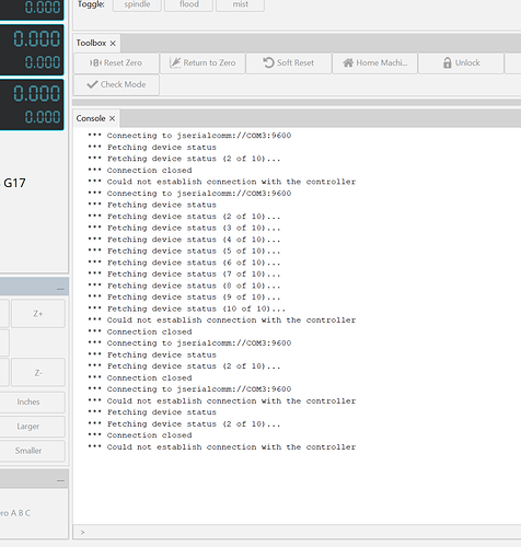

Did you try Britt’s file?
What is the program with the white display, CNC.js?
UGS - Universal Gcode Sender
I have 6 stepper drivers on my MPCNC. @dre3rd is only using 4.
It looks like his rotary is on the Z and mine is on the A axis.
Frogmore you are trying to use X, Y, Z, A, no other drivers?
You might want to try CNC.js they are more tightly integrated into FluidNC and have all the same features for you but should absolutely connect.
Will give that a try. I think I already have it in my downloads.
Can you confirm how many steppers you are tying to use so I can look at the yaml for you.
Which axis are you using for the rotary?
I ask because neither one of your configs have the A axis correct.
The jackpot has to use 2209, (or the similar TMC, it can not use 8825’s).
Let me see what I can do.
What I would like to have is XYZA and all in order in the config file.

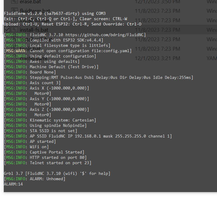

Here’s a config that has only 4 drivers. XYZA
config.yaml.zip (1.9 KB)
My rotary has steps_per_mm: 6.944 on the A axis.
You will have to figure out your rotary’s setting.
The A axis is actually steps per degree of rotation.
So mine is 6.944 steps per degree.
Just in case there is an issue with that, here is a backup. ( see something odd in my yaml…I need to poke around a bit).
config.zip (1.3 KB)
