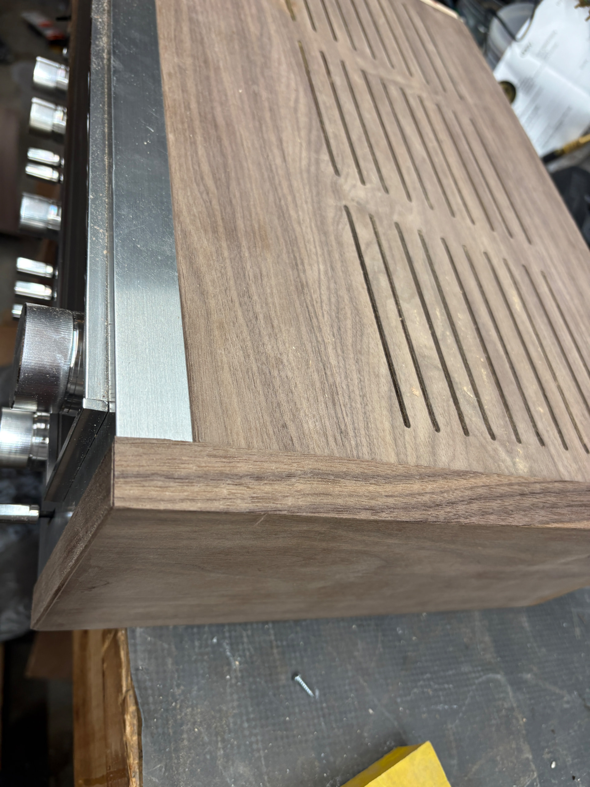

Thanks for the tip, here is what I am working on just mocked up for now and will glue up soon
That looks really nice.

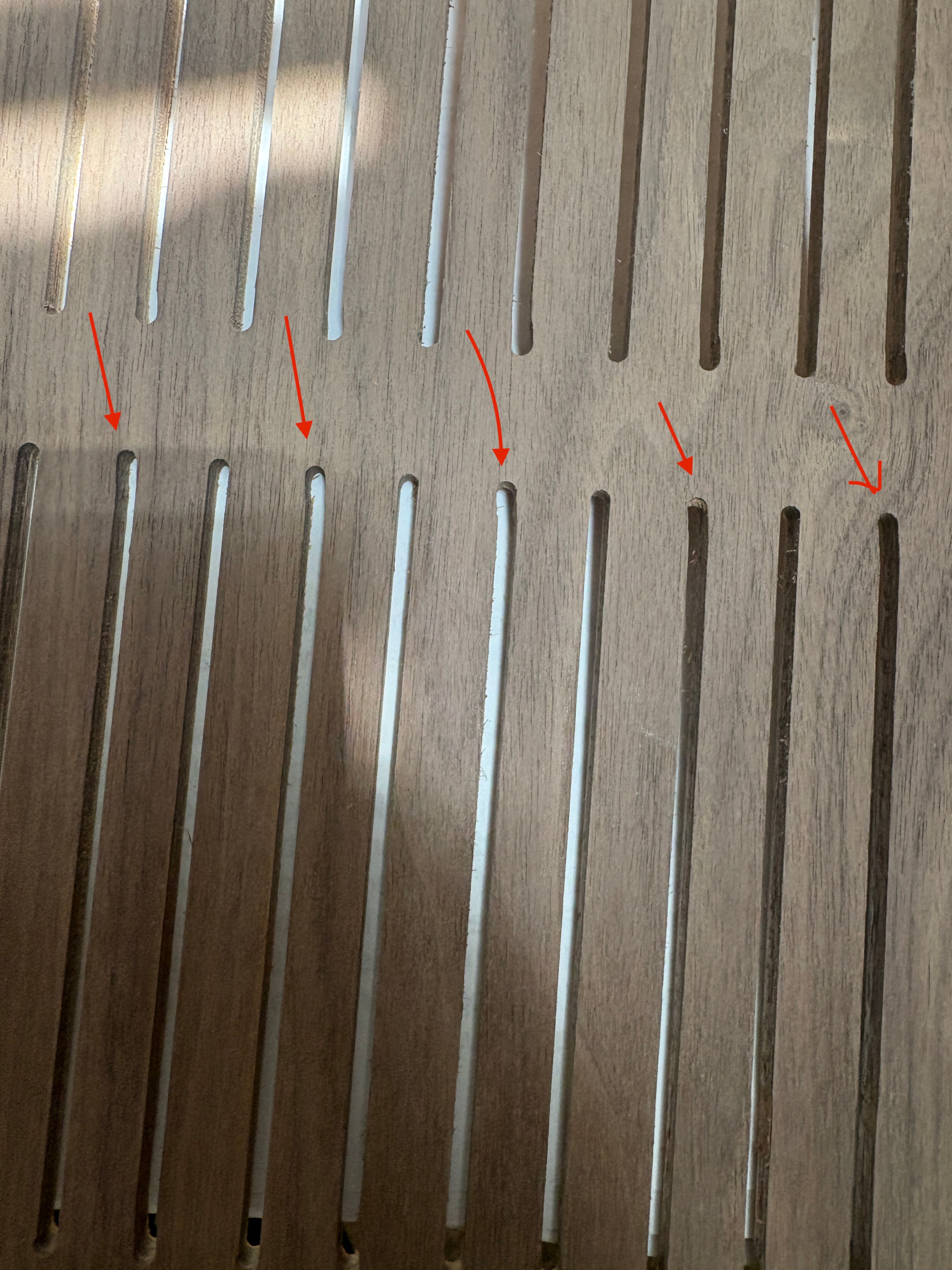

Taking a closer look… although delighted that it worked at all I can see some obvious drifting… and pretty sure it comes down to my Y axis right side belt being a bit looser than the others. Not sure how well this will show in the pic but several slots go a bit wonky at the ends. Might even tighten it up, and run it again with with a larger bit.
Noticed something strange. Every other row is a bit wonky, does not seem random. How could that be?
If those are full width slots you need pretty perfect feeds and speeds.
It might be easier to use wider slots or a more narrow endmill to let you use a full depth finishing pass all the way around.
It is odd that the ends all have something wonky about them. Is that the starting end or the finishing end?
I believe those are the the finishing end… can’t remember how Millmage handled the path, will double check. Yes, those are 1/8 grooves for 1/8 inch endmill… live and learn! I’ll redesign for a mm or two wider and even them up.
What is really crazy is the perfect skipping a row. One perfect, one wonky, etc. I could understand uniform but that’s got me puzzled.
Will tighten belts and back at it.
It must be changing direction, up and back, the other end being funky??
Yeah that should fix it.
Yeah, you can see it in the top rows, there every second bottom is off. Seems to have to do with climb vs conventional?
I believe that is it… entry point vs exit I am at work but snuck a look at my phone with a video and they do alternate… goes L to R, then R to L, etc on each pass. Now just need to determine if entry or exit are wonky. They are there for cooling so larger slots will only allow more heat to pass through so all good with larger slots within reason. So a few more passes will not be a bad thing.
Looks like each spot that messed up is the end of the cut.

I was unable to design for the pocket in Millmage (new to all of this) and could not figure out the offset to turn a 3mm line into a 4mm pocket… tested it in cutting foam and my design was either bit width or too fat so I regrouped and decided “good enough” ! Did not have the guts to run the part again when it was so close to how I intended it. I have learned a whole lot on this project and will be ready to go for next one… I have some more projects to do in the near future.
