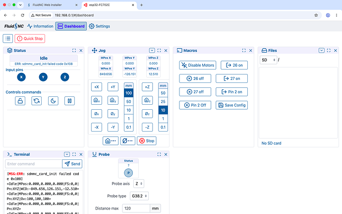

Long story short… I bought this years ago, an MPCNC Burly, had to set it aside and just put it together. I just bought a Jackpot 2 (not knowing that there was now a 3) and put it together.

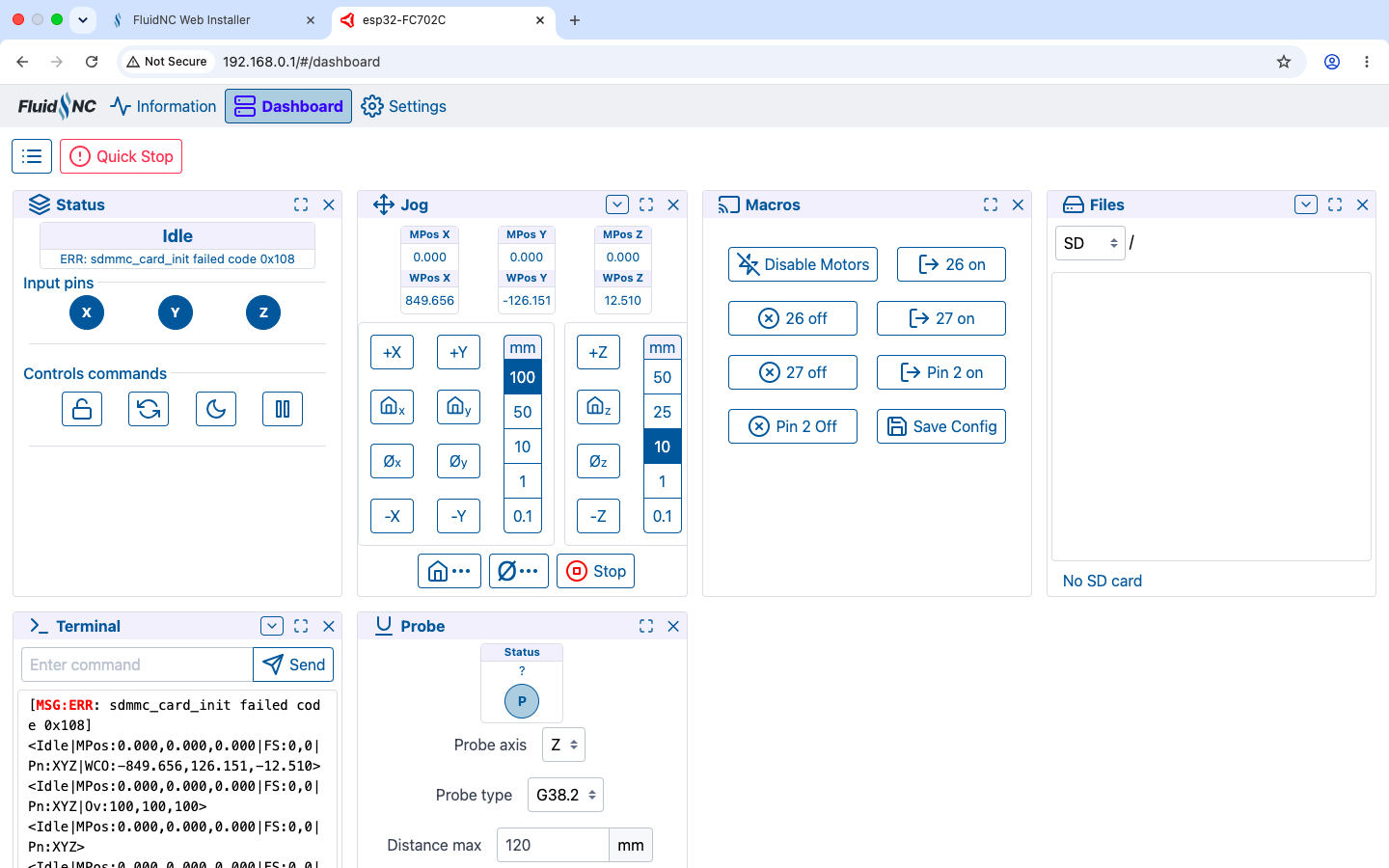

My problem is I am not very knowledgeable when it comes to this type of installation. I know that the Jackpot comes configured for the LowRider. I know that I need to load the appropriate config.yaml file. I can log in to the Fluid NC and the little page that loads up automatically. But, even when opening 192.168.0.1 I cannot get to the part of the interface that shows “Manage Local Files” and the Green folder, no matter which device I try. Is there another way to load it, like on a SD card?
Can you show us a screenshot of what does come up?
It should look like this, https://docs.v1e.com/img/jackpot/LUI.jpg
You can load files directly through the webinstaller but either way you will need to be able to see that screen so we might as well figure out what is going on.
What devices are you using to view the jackpot controls, please be specific, device type and browser used.
I believe mine is the same… I have been trying to use my Macbook Air with Chrome.
All I have found shows that you need to have a screen that shows folders that you can add the new config.yaml from.
I tried to use it as is with the two steppers plugged into a little board that runs 2 steppers from one socket for one axis but it is very weak…will jog around but stalls when you just touch it with a hand, that is on a 12V 5A power supply.
Under files change from SD to Flash. Then you can upload the config.
Wow! That did it…. and the second set of steppers working now and has more oomph. Very appreciative of the help. Have not made a cut yet but on my way now.
