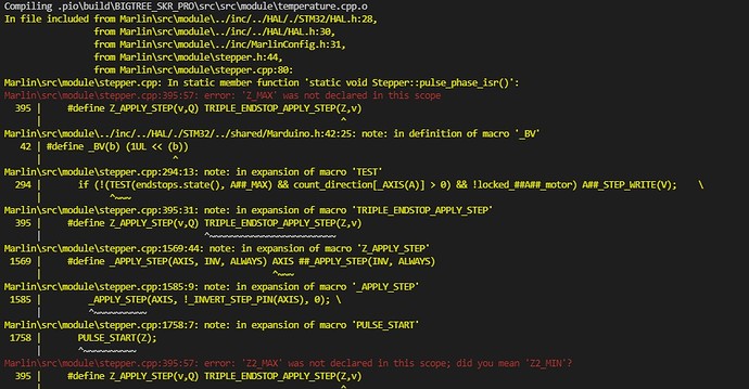

I know I should just give in and use the BL but what if someone doesn’t want to and they just want to use regular endstops…AND I hate to think I found a bug and just leave it for someone else to deal with if I can confirm and report or possibly fix it would be awesome.
I think I got it all set correctly this time and I have tried a few checks, no coreXY, min vs max homing, 2 vs 3 Z’s. I have the same issues.
If I home to Z min I get Z max errors… and reversed, home to MIN and get MAX errors. Something has to be reversed here. Anyone see anything obvious in this breakdown, I think it shows all the relevant lines?
So this is set to home to Z MIN…why Z max errors (I did try turning on/off the Z max pins/endstop (on during min creates more errors))

I would not be surprised if you did hit a bug though. That error message is a mess. It is a bunch of macro expansions leading to an undefined variable name. Nothing obvious is sticking out to me.
Can tou just try the simplest change to make this fail? A vanilla 2.0.9.2 (or whichever) with just the trippe Z set up? If that compiles, then maybe it is some complication with something else you have changed. If it fails, then that should be reported to Marlin, and probably added as a test case.

Marlin\src\module\stepper.cpp:395:57: error: ‘Z_MAX’ was not declared in this scope
In the source file “stepper.cpp” on line 395, the program is trying to use a variable called ‘Z_MAX’ (and Z2_MAX) but its not properly defined in the code as a whole. Its saying the scope isn’t correct, meaning that if it is declared somewhere in the program, its not done correctly.
Or so it seems at least.
You are trying to find Z_MIN while getting Z_MAX errors, so its possible there is a syntax error.
What files are you modifying before you compile? The error is in the stepper.cpp file. Any way you can send me that file, or direct me to where I can download the source you are using?
The errors seem odd, and the code is unclear to me “(v, Q)” looses me. I am going to look at it again. It is bugging me. I feel like when you turn on 3 endstops (or even 2) it checks for both min and max, instead of just one. I think I can do a few quick and dirty test by commenting out some lines. I think it might be in stepper.cpp, I bet there is an “&” sign when it should be an “or” further down there are some conditionals that do not seem right to me as well something like “min | !=z probe”. I am going to have a bit of extra coffee and try this early in the day instead of late.
I am too close I can feel it.
P.S. Thanks for confirming it wasn’t something obvious on that error screen. Kinda felt like it might have been staring me right in the face.
Pretty sure I found it. Stepper.cpp lines 286-296
Was
if (!(TEST(endstops.state(), A##_MIN) && count_direction[_AXIS(A)] < 0) && !locked_##A##_motor) A##_STEP_WRITE(V); \
Needed
if (TERN0(HAS_##A##_MIN, !(TEST(endstops.state(), A##_MIN) && count_direction[_AXIS(A)] < 0) && !locked_##A##_motor)) A##_STEP_WRITE(V); \
Looks like the whole triple endstop set was missing " TERN0(HAS_##A##_MIN,"
I realized the dual endstop set above it had to work…cuz Jeff made sure of it a few years back. Got dual working, triple still wouldn’t. Stared at the screen for a very long time playing where’s Waldo or spot the difference.
Need to check it on real hardware then submit to Marlin.
Works…get a homing error when it is all done homing, but it works perfectly otherwise.

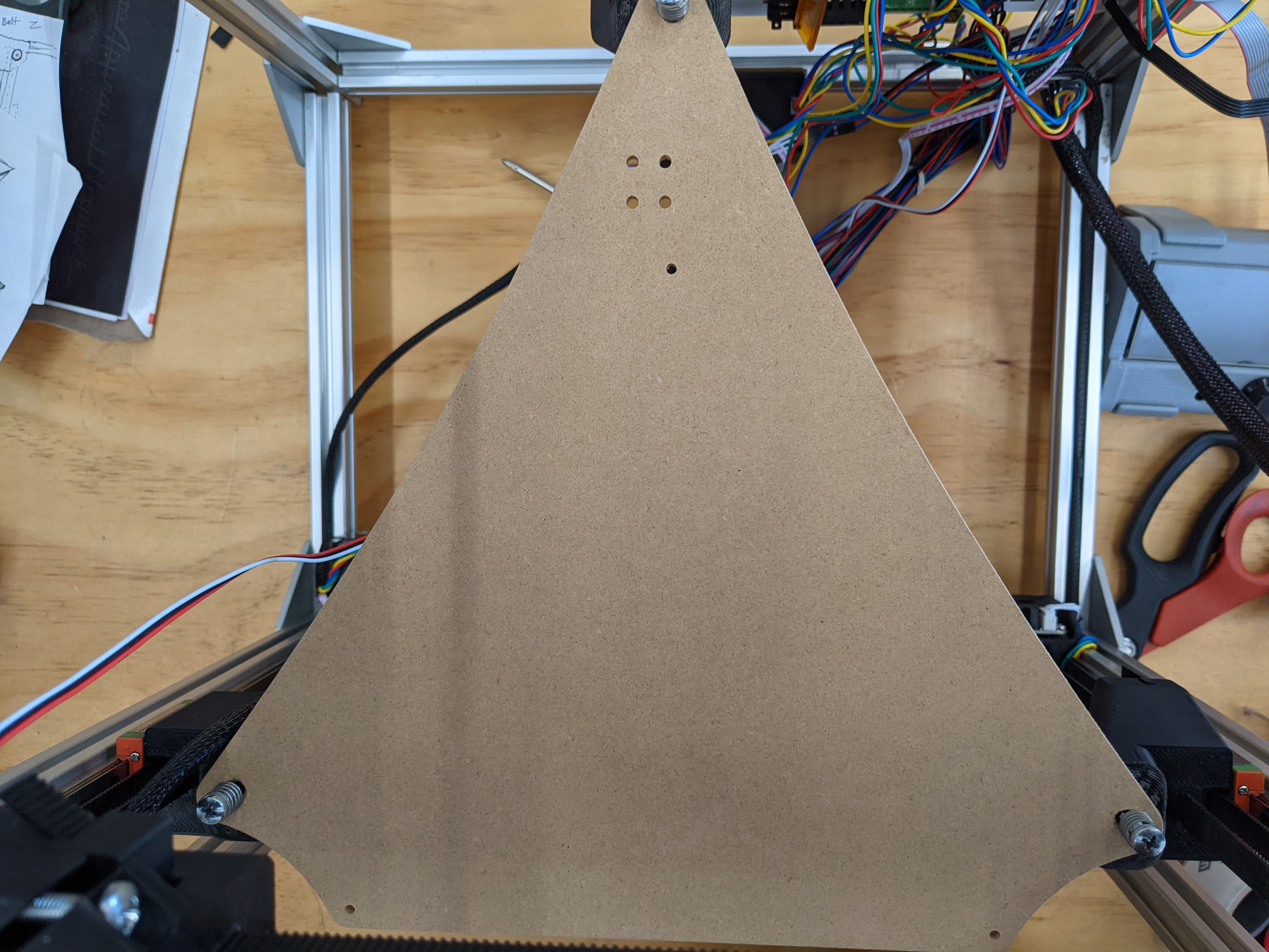

Ohhhhhh yeah, the bed plate works so much better than I expected. It also looks like the Marlin PR was approved and is just about to get merged to the bugfix branch!
What did you expect? It’s a hunk of wood with three holes in it…At least, that’s what appears to be the critical design elements. You could probably crank out something that fit those requirements with a jigsaw using a meth-head blade and a marginally useful icepick. :clown_face:
