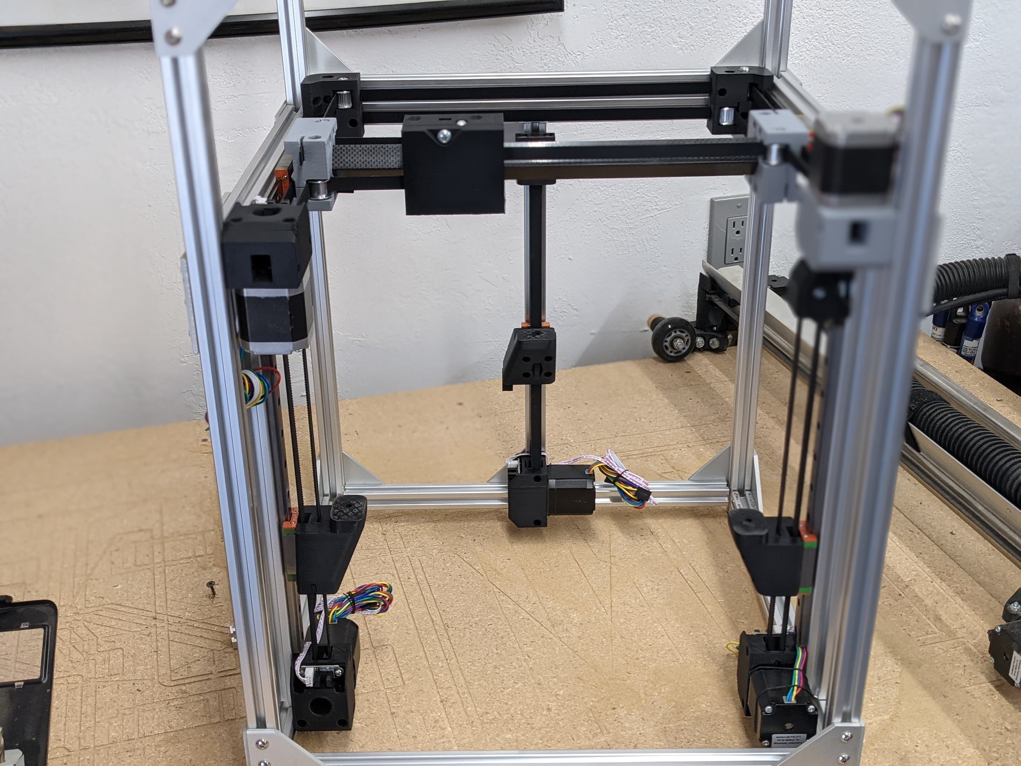

859 extrusion screws later…

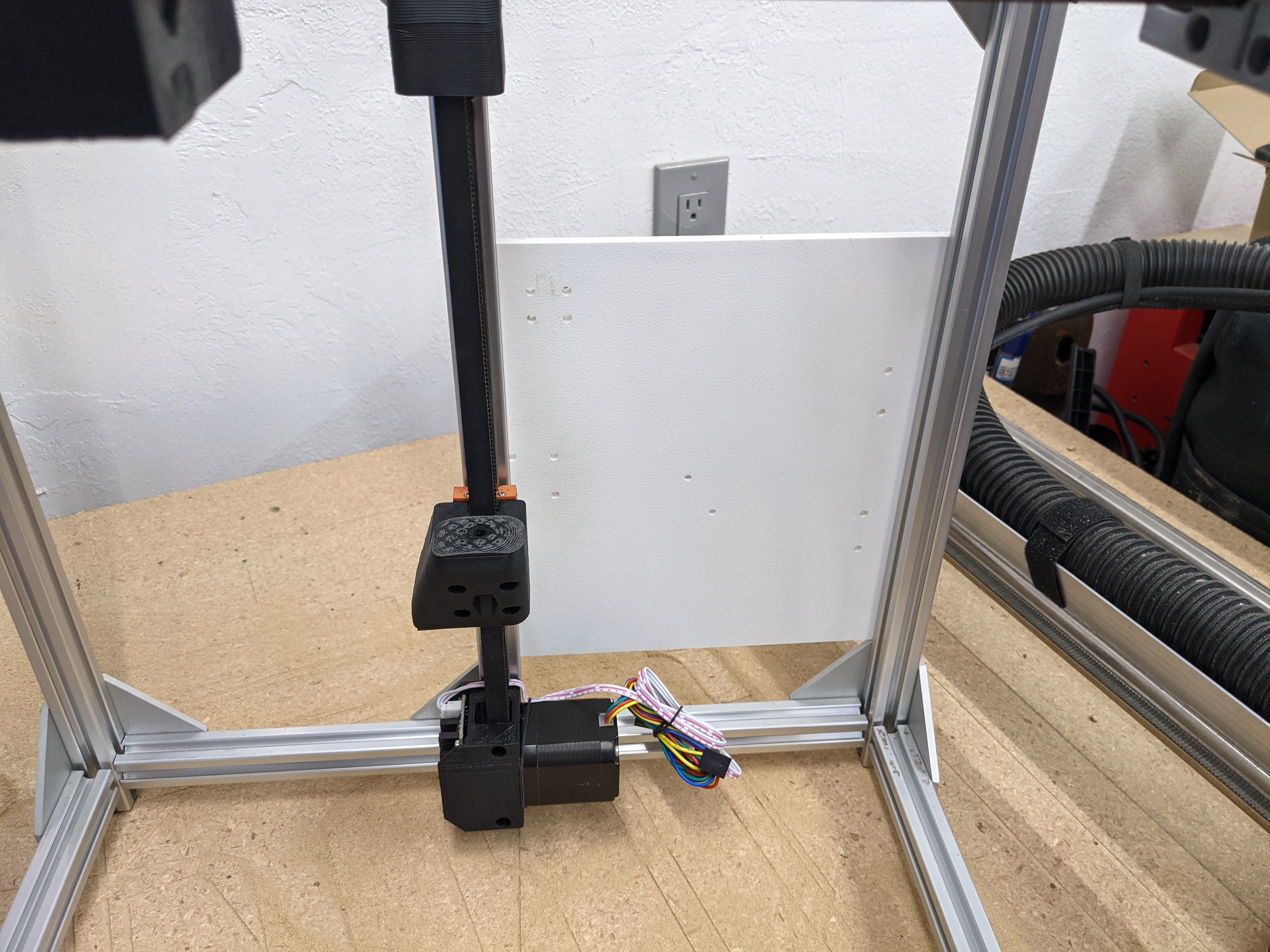

Time to cut out the bed plate and maybe wire up the motion system. I had plans to also make an extrusion based bed plate as well but I am dying to drive this thing already.
So far… awesome :sunglasses:
Hard to see, but each driver’s optical endstop is triggered by a belt chunk…love it easy to adjust or change when you cut it too far.
Pretty sure it sits at 10 unique printed parts for the entire build.
M5x30 with nuts
M3x10
Then the attachment screws are
Extrusion - m3x8 and m3x10
Or wood M3x(3/4) of your wood thickness+ ~4mm
MP3DP V1 bed plate looks good here for now.
Looking close! Can’t wait to try one for myself!
6 motor drivers… Hmmm. I might end up using the SKR Pro for this instead of the LR2. Well, I have another Duet Wifi, which I know can handle the LR2, since I have one handling the Primo just fine.
Just bolted on a SKR pro, running a few wires now.
