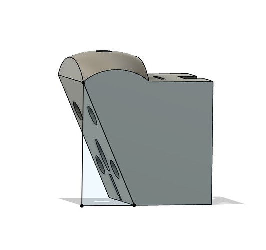

I have never really tested this. Any idea how far I can undercut? This piece is undercut 20mm, the part still on the bed would be 30x35.
I would think the angle would matter, but the undercut distance wouldn’t until it had enough of a lever arm to pop it off the bed.
That is what I figured. I made the angle very slight, and the bump at the top is just barely over the tipping point. It prints fine, but I wasn’t sure if there was a rule of thumb for undercuts, like the 45 degree rule for overhangs.
That part is the primitive shape for the bed support for the Z linear rail. It will allow for nearly a 20 degree tilt in any direction. I know that is over kill but I had to try it. I looked at a bunch of other printers and I really hope my simple approach works as I intend. I have everything to print and put together a build tomorrow. I have a extruder/bltouch/fan mount sketched out so that should be quick.

Well since you mention it, the print is pretty interesting. To get that nice smooth top I used variable layer heights. Thick on the bottom and at the dome, I went really thin to get that smooth transition. Not that it is needed more to make it a more interesting print.
I actually woke up thinking about it several times last night. 20 degrees is probably asking a lot. I am going to take that down a lot. If I am doing the trig right, a 5 degree tilt on the bed would put the mount 34mm out of plane (and only require the slot for the bed plate to be 1.4mm longer in one direction).
That is ridiculous. 2 degrees gives you ~14mm of correction. Shoot I should have done this math first…lazy engineer.
