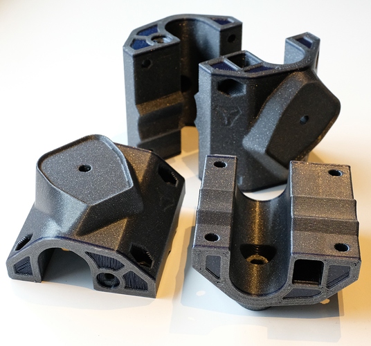

Hey all,
First time building an MPCNC (or any CNC router for that matter). Coming over here from the Voron community after one of their members mentioned that the Primo had been released a couple of months ago.
Currently just started sourcing and printing for a smaller (work area of 18"x12" for a true benchtop footprint) and had a couple of questions.
  1. Understanding PLA and PETG have been the most discussed filaments (and PLA by spec due to rigidity), does anyone have any pros/cons regarding printing all parts in ABS? I know ABS is generally only recommended if folks are truly set up to print that filament, but fortunately my Voron makes quick and painless work of ABS.
  2. I ordered the 1"/25.4mm stainless tubing from SpeedyMetals - to polish or not to polish?
  3. Also, I stumbled across what may be a dev thingiverse site for Ryan vs the production/final site for the 25.4 parts (thingiverse thing: 4550786). However, it was updated on July 23rd vs the June 23rd site that seems to be linked everywhere. Are there any issues with printing parts from the July 23rd site (as I’ve already started those).
  4. I was hoping Klipper would be a firmware option, as I have a lot of experience with klipper, Octoprint, etc. coming from the Voron, but it looks as if there are still some issues that require creative workarounds and Marlin still looks like the best option. That being said, I’ve also had great results with the SKR boards and TMC2208 drivers from the Voron and have some of those left over. It looks like a few of you have been running the 1.4 Turbos and similar - is that recommended or considered to be the wild west for MPCNC? Just looking to leverage past experience with some of the components that may be transferable from previous DIY machines I’ve made.
Thanks and I really look forward to this!

Okay, you have my attention…this size is great.
1-Super flexible and rarely dimensionally accurate.
2-I prefer the dirty tool look, shiny is nice though.
3-All the parts should be the same. I release in many places now so sometimes I forget one or two. Or in other words, no revised parts have been released, when they are I usually give them a version number…V1..V2, so you will know.
4-I have skr pros and 2209s in the shop. Klipper sounds super interesting but I have not had any time to mess around with it. Apparently Malrin is working on something similar.

My main use for this will be the initial step into the world of CNC routing and I don’t plan on cutting much other than carbon fiber, G10 and similar for small drones/rovers, etc. The ability to slip a bath under the MPCNC for cutting “dustless” CF is what drew me to it. There’s a chance I may eventually get into small aluminum parts (probably 1/4" stock at most), so I went for the smaller size in order to not push the stability/rigidity limits. I had looked at the PrintNC, but the combination of drilling steel/bulkiness of the 2x3" frame pieces, and overall cost is what led me to the MPCNC.
I’m sure klipper would work fine. Many of the benefits will be lost, because we are really just using the motion system of a 3D printer, everything else related to extrusion or temperature control of massive amounts of steps/s are all pretty pointless. We did work hard to get dual endstops on x and y into Marlin, and the lcd screens have always been there. That’s about the only things that klipper may not have, IDK.
But hey, if you want to do it, by all means, go for it. I will help think through the issues if you do. I would be interested to see it. But make a new post so it won’t be buried 2700 replies down.
Oh I’m nowhere near the skill level of being able to make Klipper work. With everyone here using Marlin, that’s a clue - I’ll just use Marlin :slight_smile: Once I get the MPCNC up and running well I’m not opposed to trying things out, but I’d rather have a solid understanding of the MPCNC and everything involved with that before venturing into the new territory.
If you change your mind, it is probably easier than you think. The first configurations for Marlin were basically stock, but we tricked the firmware into thinking the hotend thermistor was plugged in. That was it.
