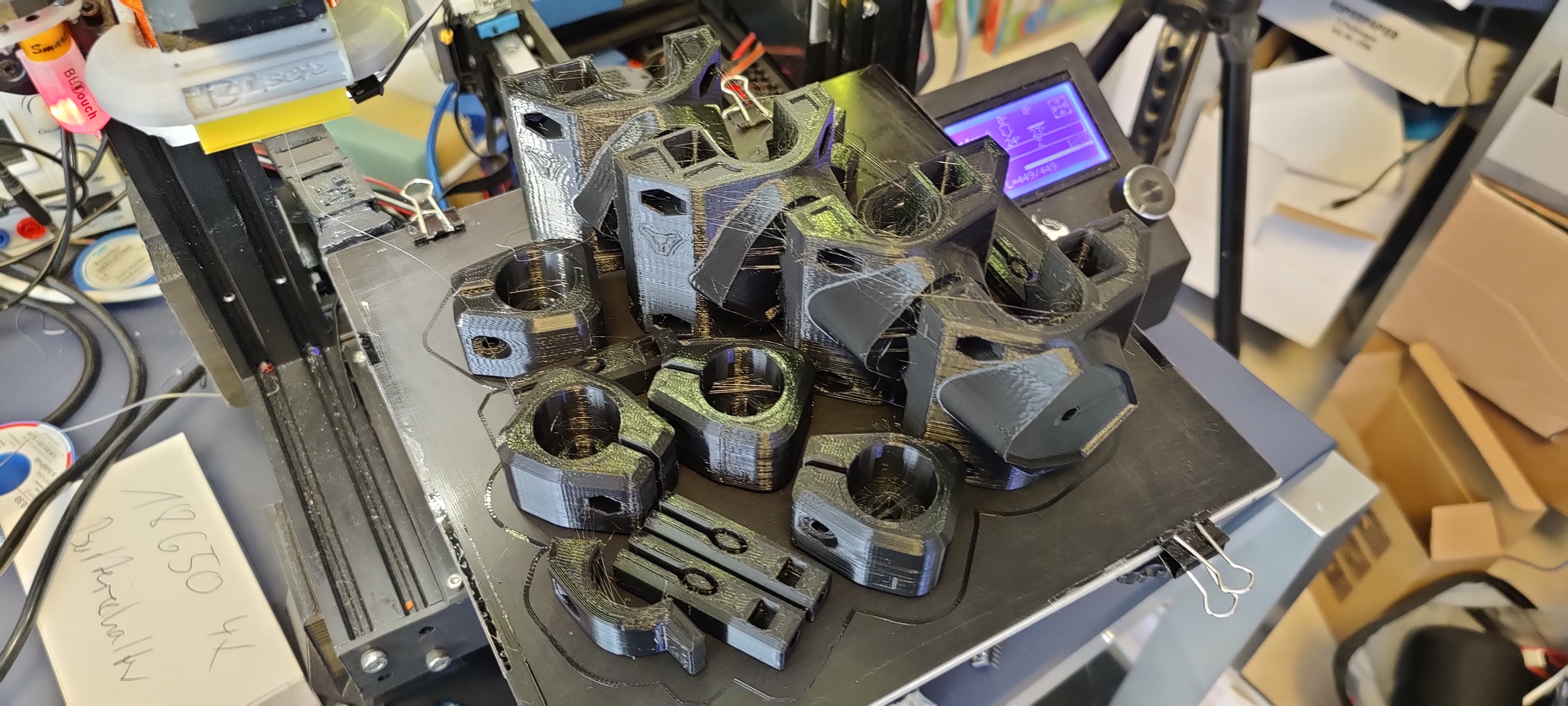

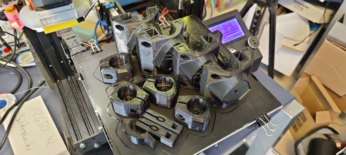

Dear friends,
just on the last day of my vacation, the 25mm F Version was realeased. I call that the perfect timing!

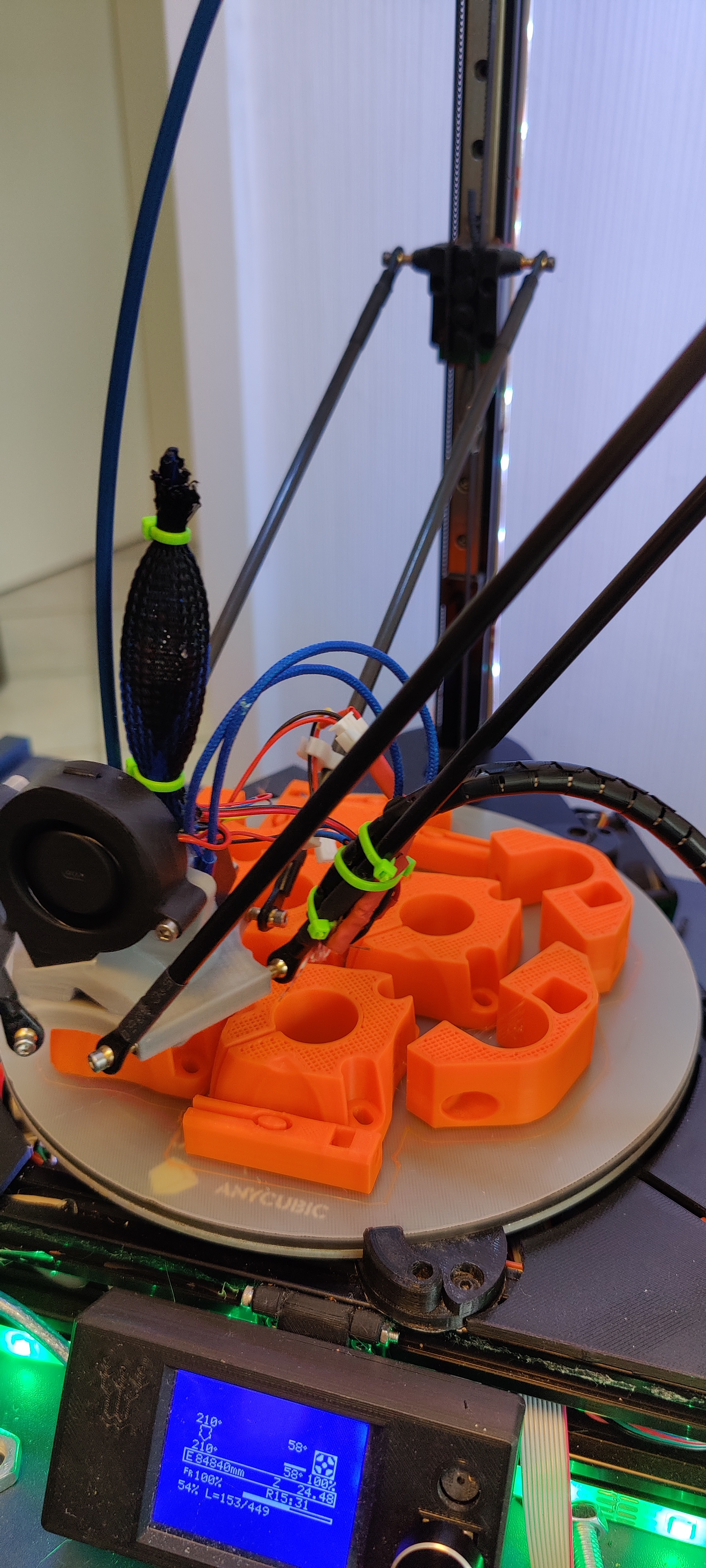

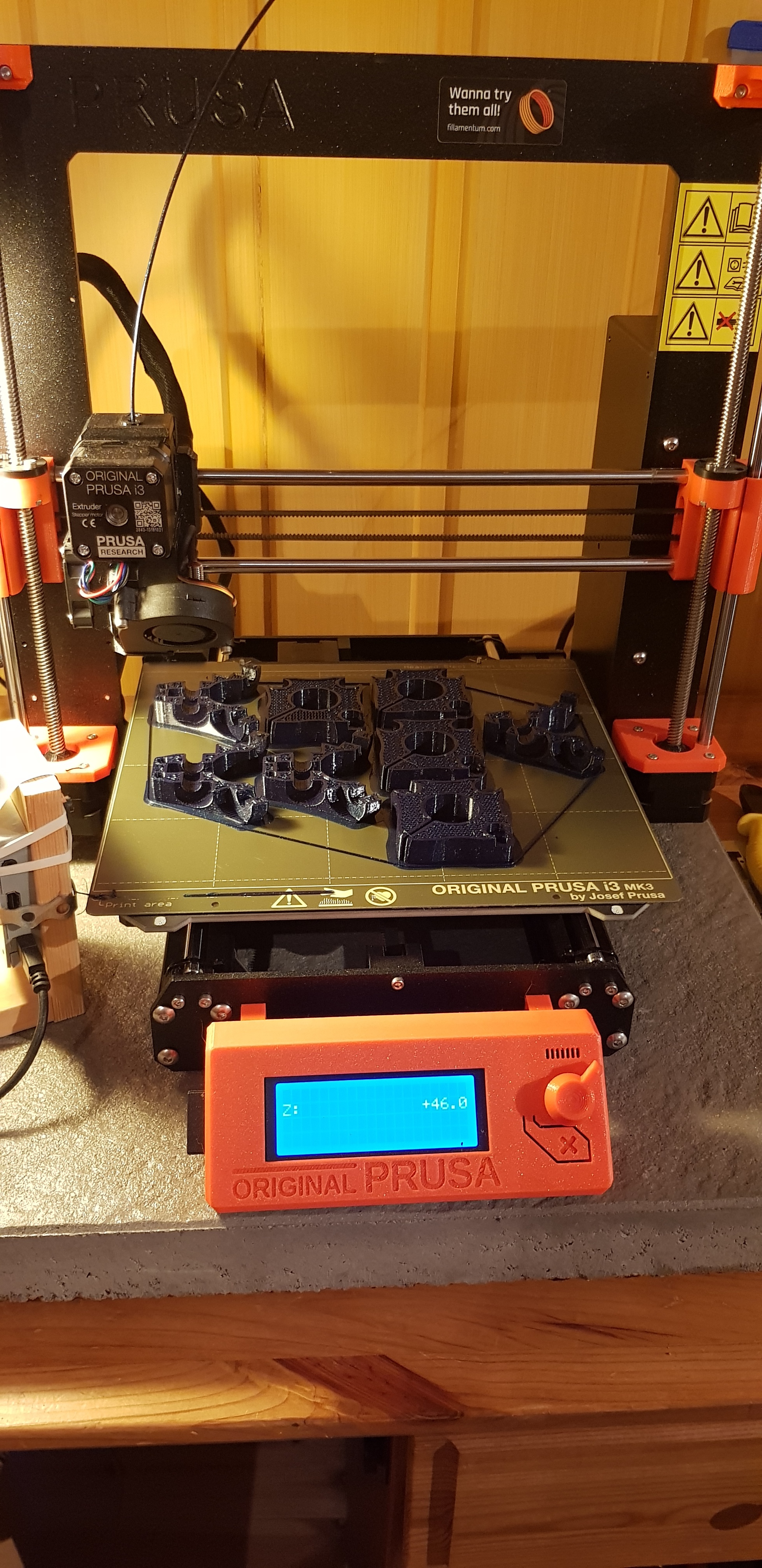

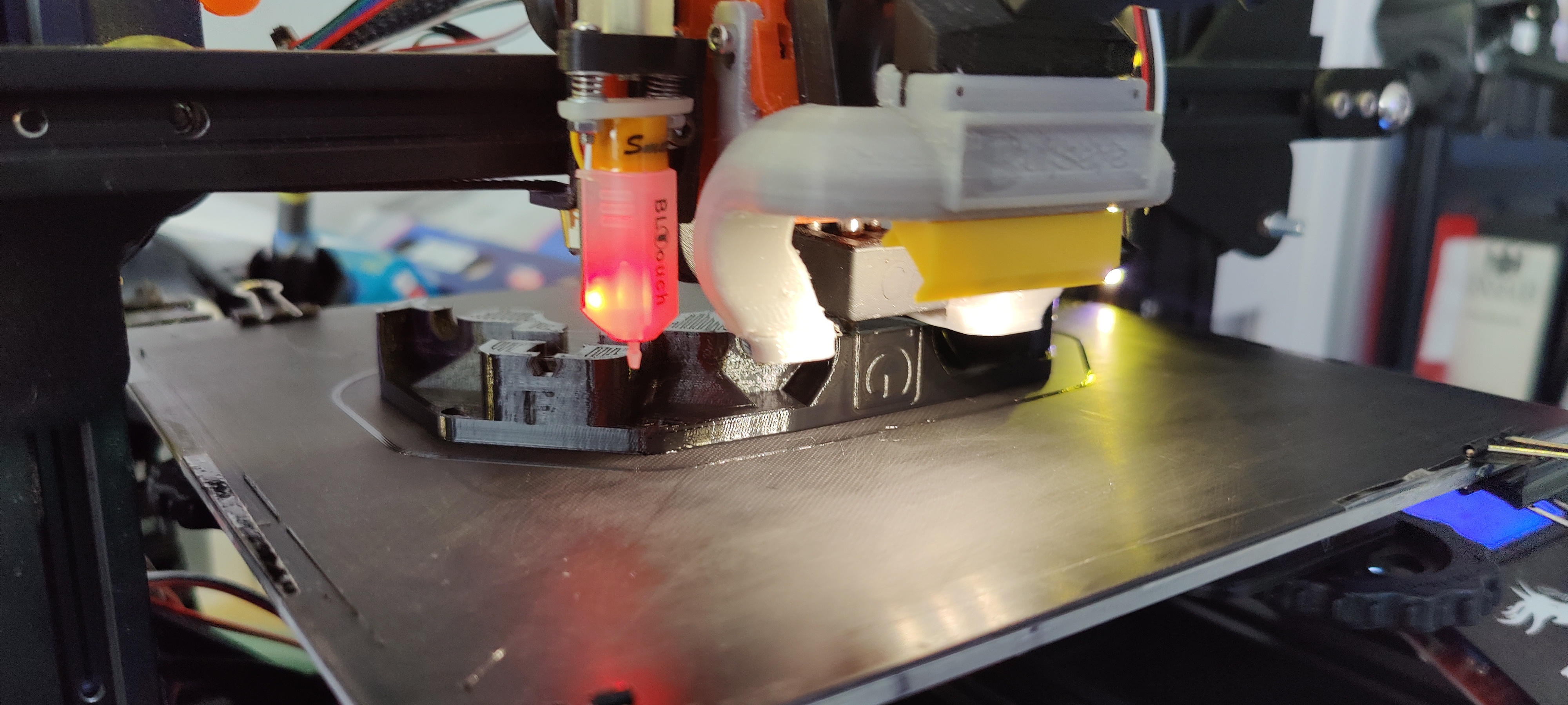

First batch is ready, second batch is still printing on the Kossel. Ender now prints the core!
Will be fun to upgrade my burly to Primo.
Thanks a lot @vicious1 for your hard work and dedication!
