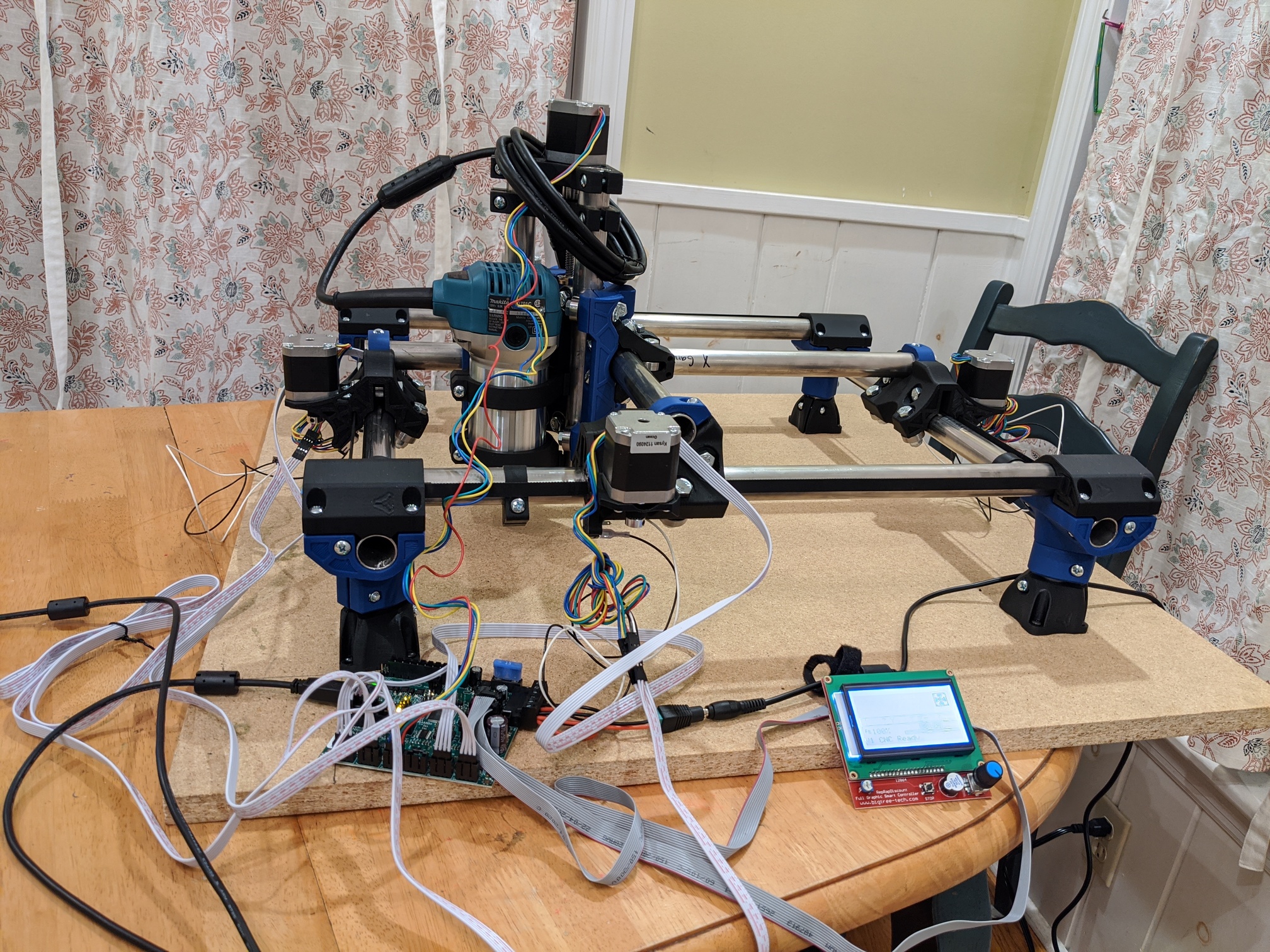

Can’t seem to finish this step I’m on… I’m bolting into my last z trap I have broken 3 of them. It’s not from over tighten because they aren’t even making it that far. Trying a different filament now. It’s just splitting I’m using super glue gel to keep the nut in place. Only thing I can think of is the force of the nut is just to much and pulling it apart.
I also screwed the nut and bolt together beforehand to loosen the nylock.
Printing .4mm nozzle with .24 layer height
Any suggestions?
If you’re using a nylock nut, run the bolt in and out of the nut a few times to loosen up he nylon “doughnut”, before you install it in the trap. Sometimes fresh Nylock nuts can take quite a bit of torque to get started.
Try printing slower and at .32mm layer height.
All done. Woo-Hoo! Everything moves in the correct direction, and the end stops work! I’m about to run the crown test with marker! :grin:
