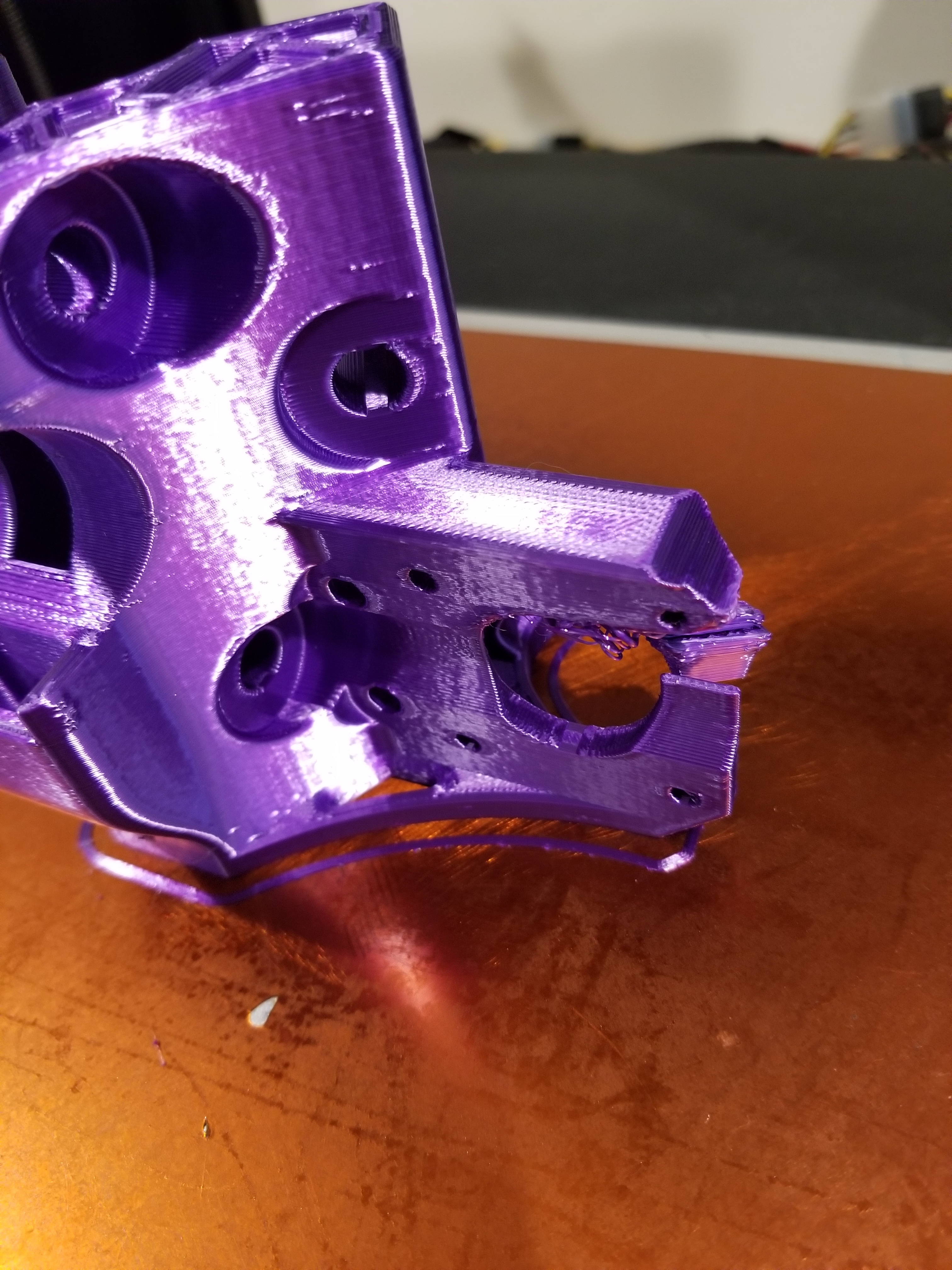

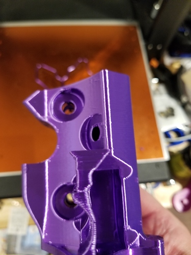

After a flawless core print, having issue with the trucks. Same brand filament, different color and bought 1year apart.
Thin spot on the outside of the stepper mount. I feel like I could glue the first and scrape/flatten the second, but it’d be good to get an opinion from @vicious1 ? Repair or reprint?
Thanks!
I don’t think those broken parts add anything structurally. If it were me I wouldn’t even bother with repair, just remove the broken pieces and continue.
I agree with Jamie I just assembled that part today and I cant imagine that being a prob.
