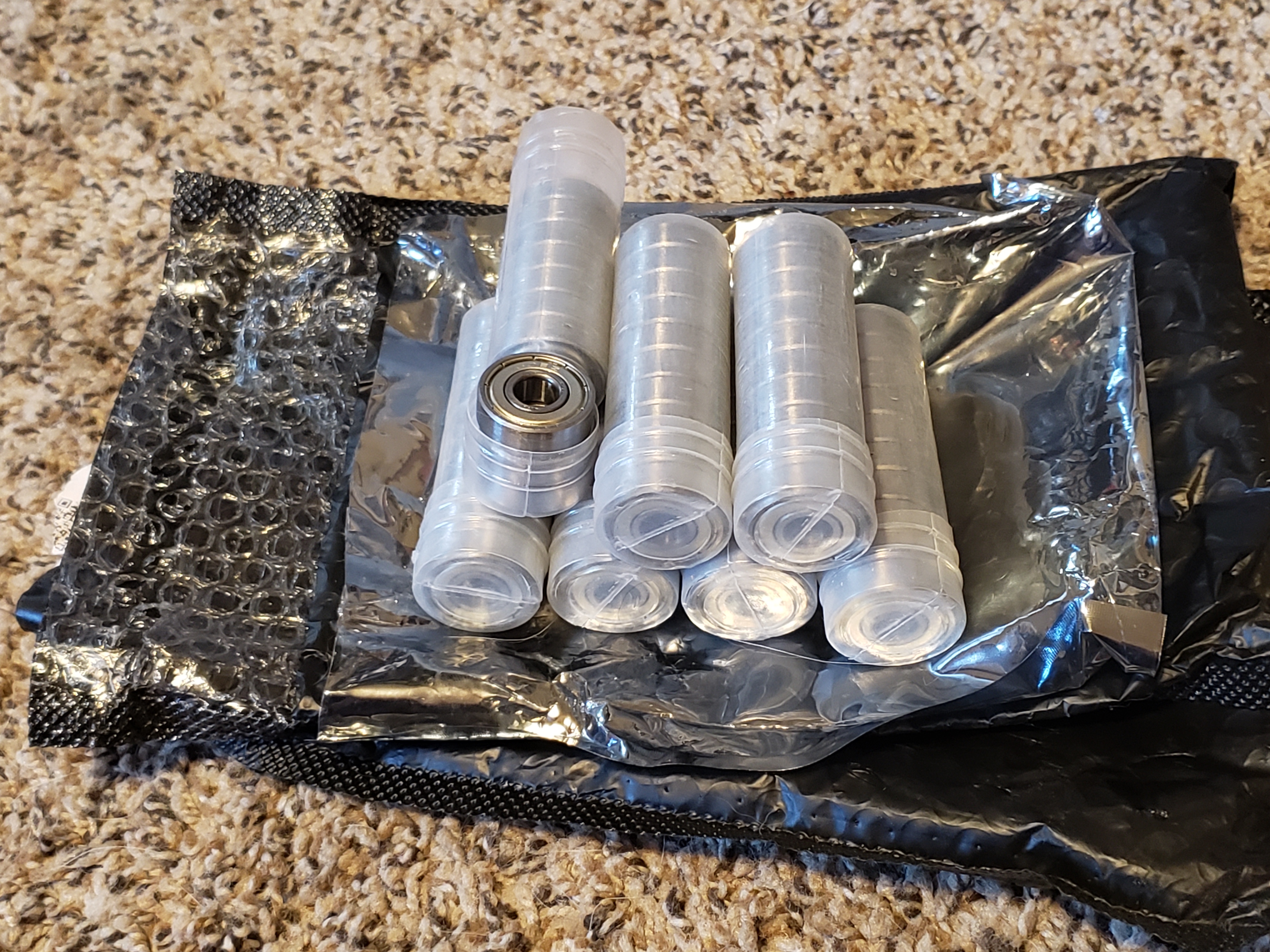

Bearings are here from AliExpress/China.
They look a lot better than the last batch of 100 Chinese 608z bearings I bought from eBay. I had to bake this horrible fishy grease off of the that batch in a cosmoline oven, and even then I had a high junk rate, around one in six.
This batch of bearings looks very consistently packaged and rust-free. From a semi-random sample of four, they appear to consistently spin very smoothly, even with an axial load.The ones I tested are so full of grease that they don’t free spin.
Any recommendations for testing them, or should I be good to go after wiping the excess grease off of them? I’m wary after that bad batch.
In a dusty environment such as sawdust or metal chips you really should have rubber sealed bearings. -2RS vs ZZ
