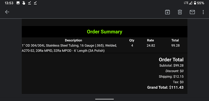

For those looking for stainless:
This stuff is shiny. I don’t know why it or shipping was so cheap. It did take a week and the tracking number they gave me was funky, but for the price… (Verocious motorsports) - I found them thru Amazon and looked them up direct

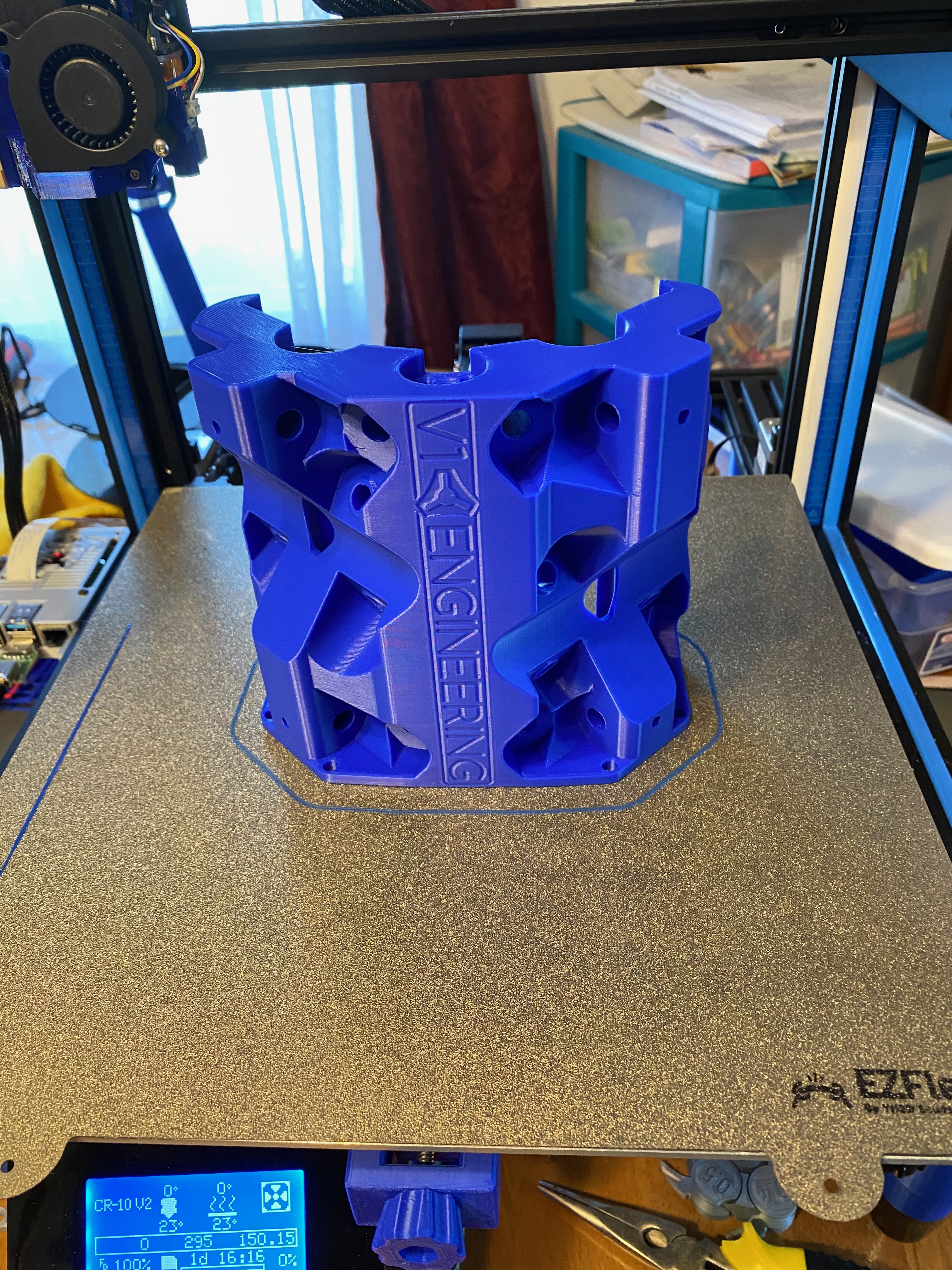

Started printing parts for my first MPCNC (or any CNC) this week, core finished earlier today! I ordered some stainless and I went to order my kit last night and SOLD OUT!!! I was holding out hoping for Rambo or Archim to be back in stock but was just going to order with the mini… Any idea on when Primo Kits will be back in stock??
