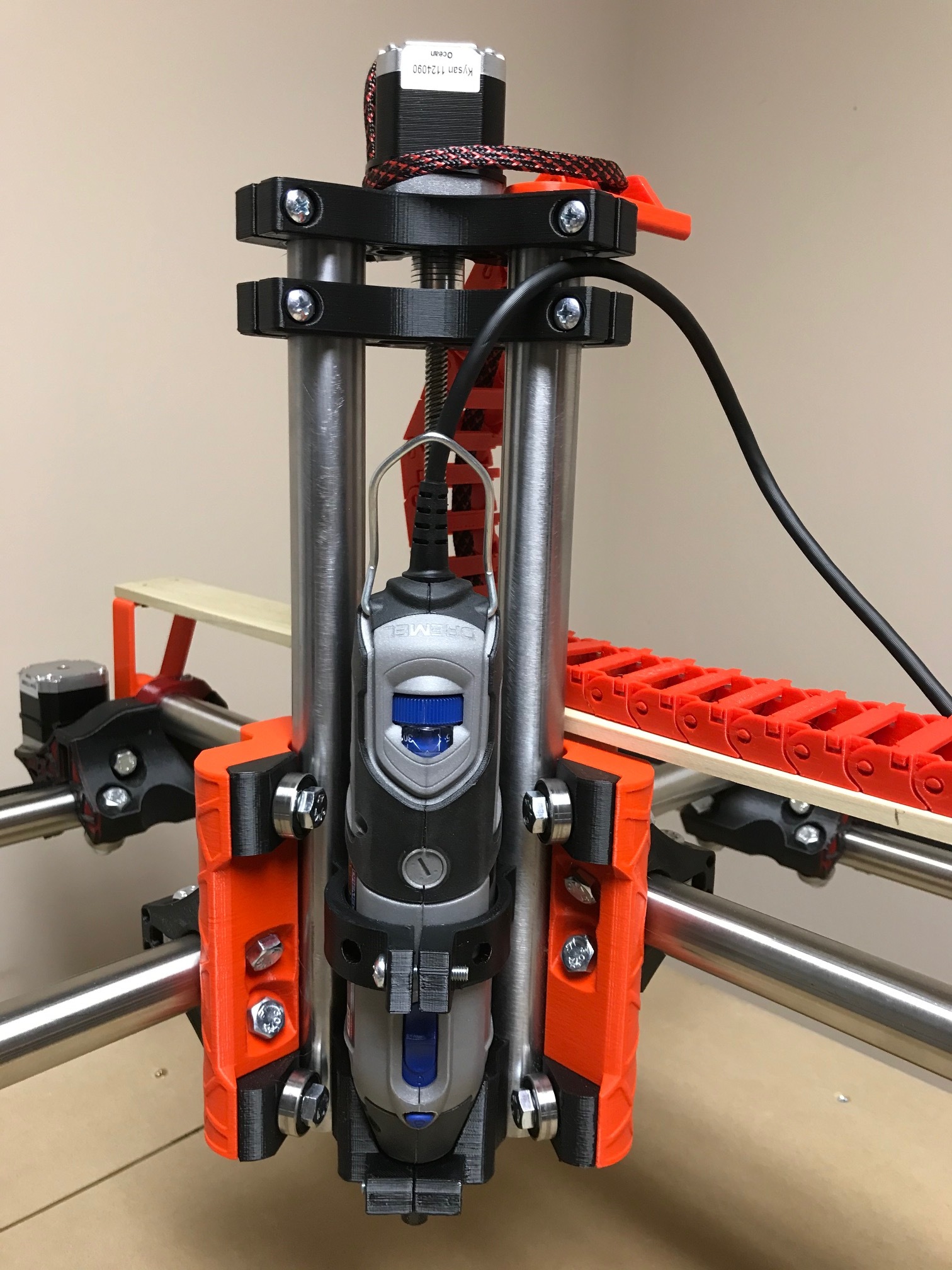

Just finished upgrade from Burly to Primo (North East Ohio). Aside from some self induced printer issues in printing the Core, the build was straight forward. The only additions to the stock design were Drag Chains for cable management and a Dremel 4000 mount (https://www.thingiverse.com/thing:4541546).
So far I am very impressed with the design. IMHO is it much improved over the Burly in terms of:
  • Calibration (squareness)
  • Tool stability
  • Easy of assembly
I used 6ea 3’ sections of Stainless Steel tubing (https://www.amazon.com/gp/product/B00ZSWL0MC) and allowed the size to fall where it may. This made the Gantry Tubes stick out a little which allowed me to suspend the Z Axis Drag Chain using standoffs that fit snugly over the protruding Gantry Rail ends.
For more demanding machining I also have a DW660 but for most light machining the Dremel is ideal.

The files and a brief description of how to install the Drag Chains is contained in the following Thingiverse item:
I used 36 Inch tubes for all 6 tubes. This was by convenience since that tube length was available in Stainless Steel on Amazon thus avoiding the need to cut the hard steel tube. https://www.amazon.com/gp/product/B00ZSWL0MC
For stainless steel I found these to be quite reasonable priced ($17.75 each + a total shipping from Philadelphia to Cleveland of only $26.30. Each tube was individually wrapped in plastic and all 6 were inserted into a cardboard mailing tube that just fit. Your shipping costs may vary.
