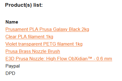

Screenshot (457)
I carved… I can’t live wihout a 0.6mm obXidian HF nozzle any longer. :stuck_out_tongue: Also, there is a sale on a few of their other manufacturer’s filament. I mean, 18€ for 1kg of transparent PLA and violet transparent PETG? You can always use PETG… :smiley:
