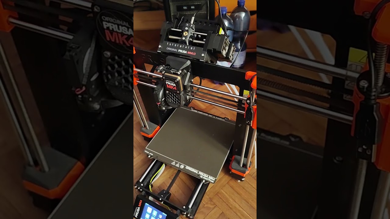

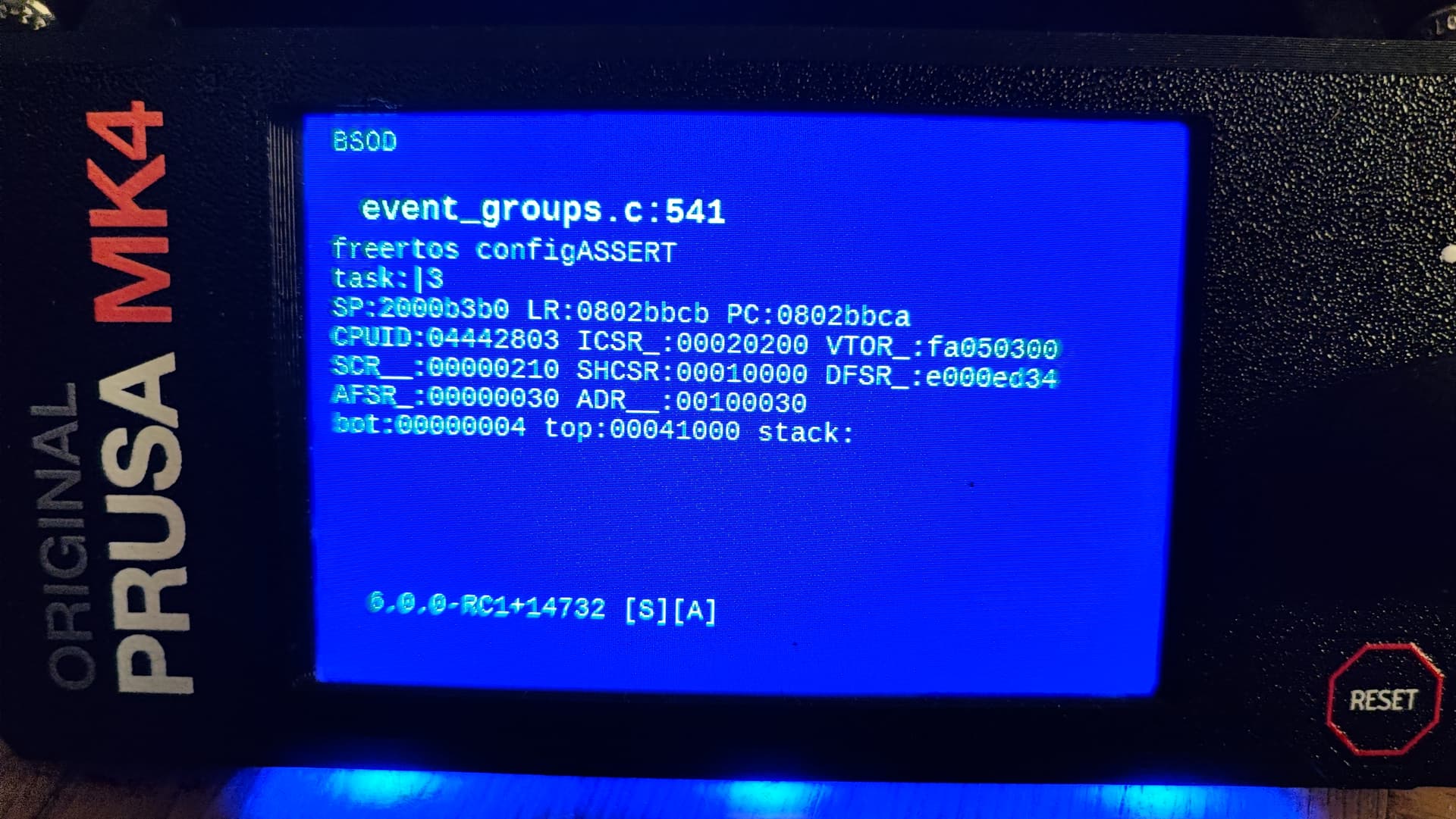

AAAAAAAAAAAAARGH!!! Why always meeeeee?? I had the broken screen for the MK4, now this. Funniest thing about all this. The printer and MMU work fine as long as the USB cable is plugged in. It does not have to be plugged in anywhere else…
Here is a video of me showing it to the support:
He was really confused and was making jokes about it not being October yet and the MMU being haunted. He didn’t have an answer, but it’s working fine with the USB plugged in… :sweat_smile: So for the time being I can live with that. They will get back to me after dealing with my error logs and the video.
@Tokoloshe , how did you figure that out? That’s really strange.
Trial and error. I thought it had to do with the Firmware not being flashed and decided to try booting with USB plugged in. After that worked I was trying shit for the lulz. :smiley:
Hmm, first thought is that there is an incorrect resistor value but hopefully it’s just a firmware problem that can easily be solved by flashing an update. Best of luck! Can’t wait to see how you use it.
I don’t mind what they do, changing the board is done in a few minutes. :smiley: I am really interested in what it turns out to be. :smiley:

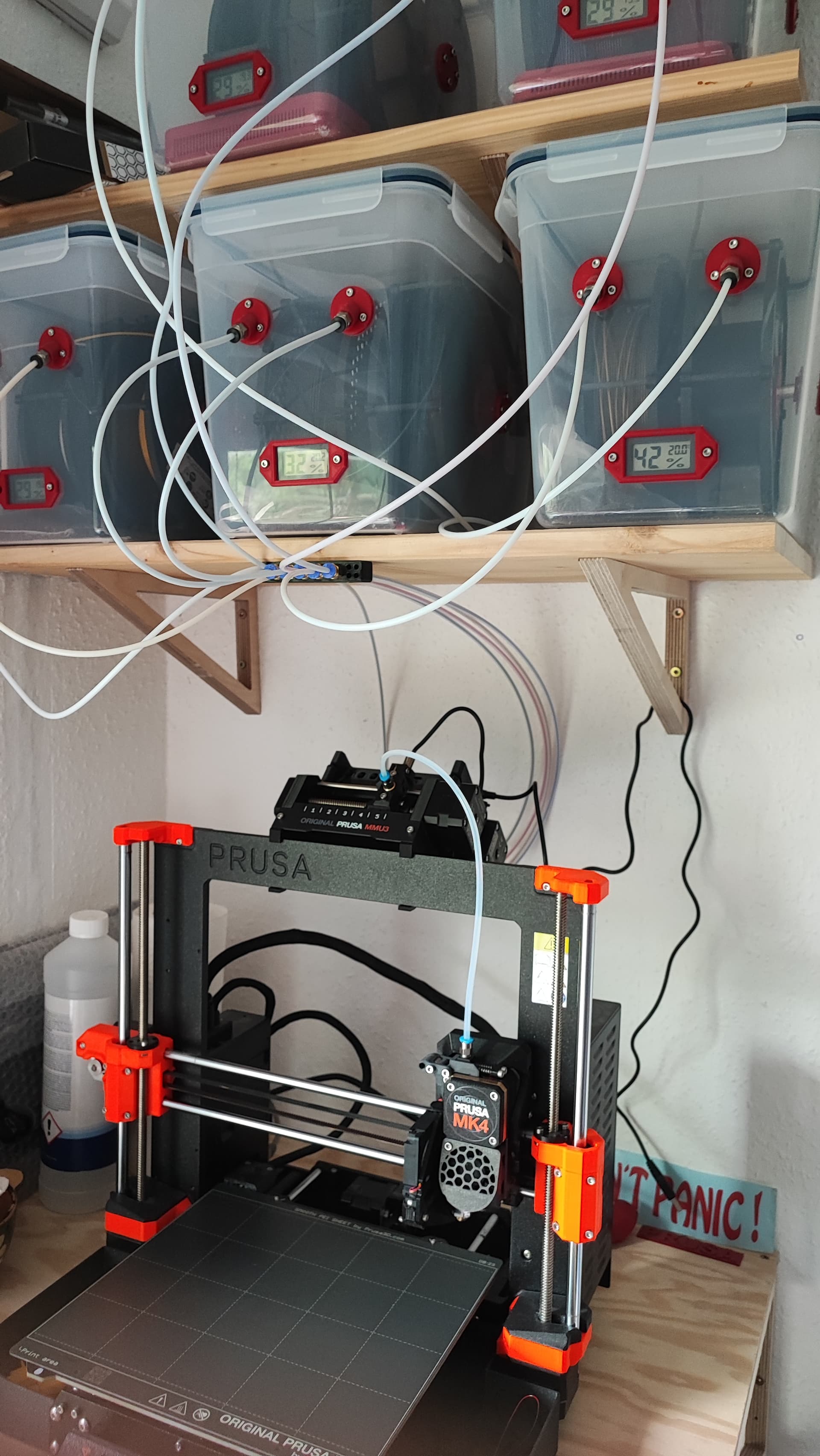

Didn’t bother unpacking the buffer, build-in buffer it is:

I’ve been confirmed that the issue that your MMU3 is experiencing is something known to us and that our Developers are currently working to fix. The fix for it should be relatively close to being released (most likely on next firmware).
Our suggestion at the moment would be the following:
  1. Continue to print with the USB cable attached while the fix is released
  2. If possible, perform a Hard Factory Reset, please let us know if that helps.
Things I am not going to do: A Hard Reset. :smiley:
12ga_reset
Do the Easy one.

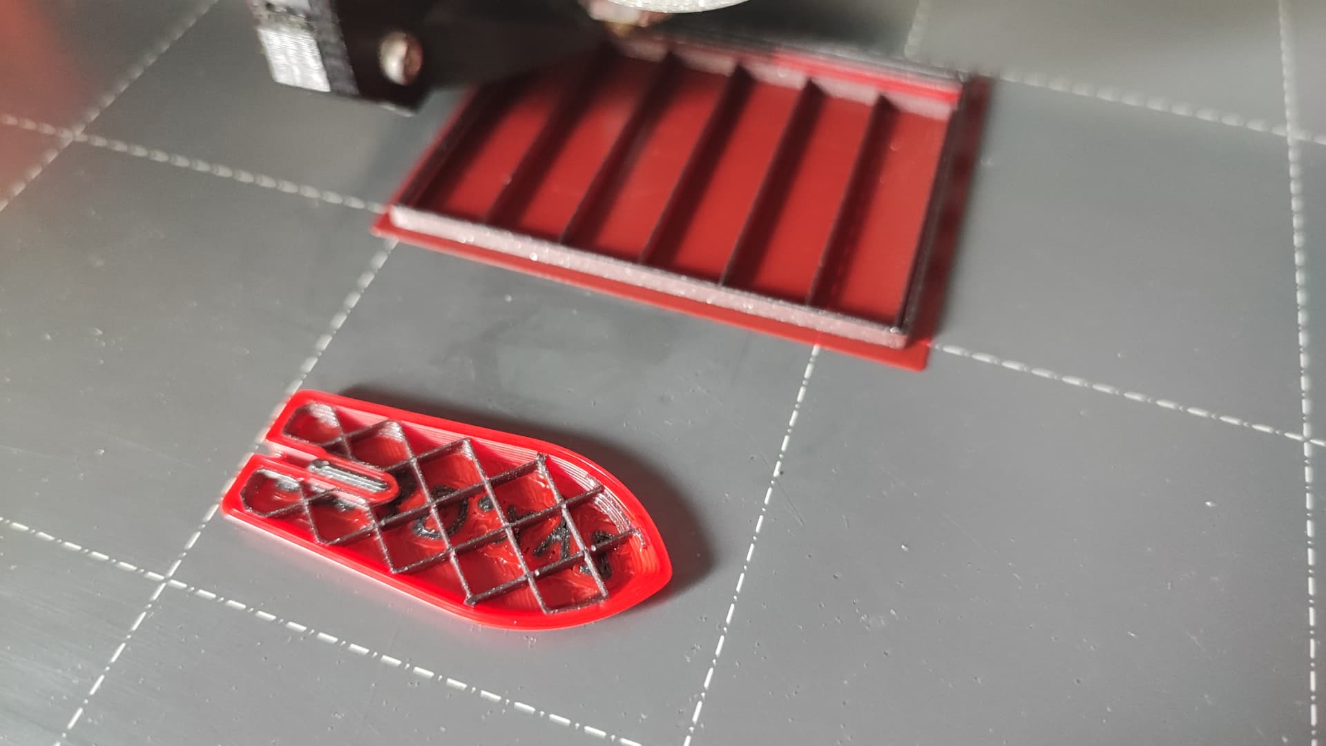

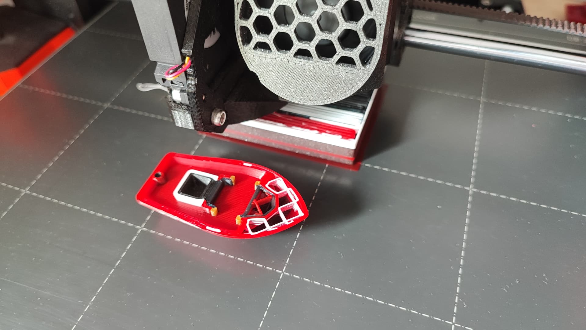

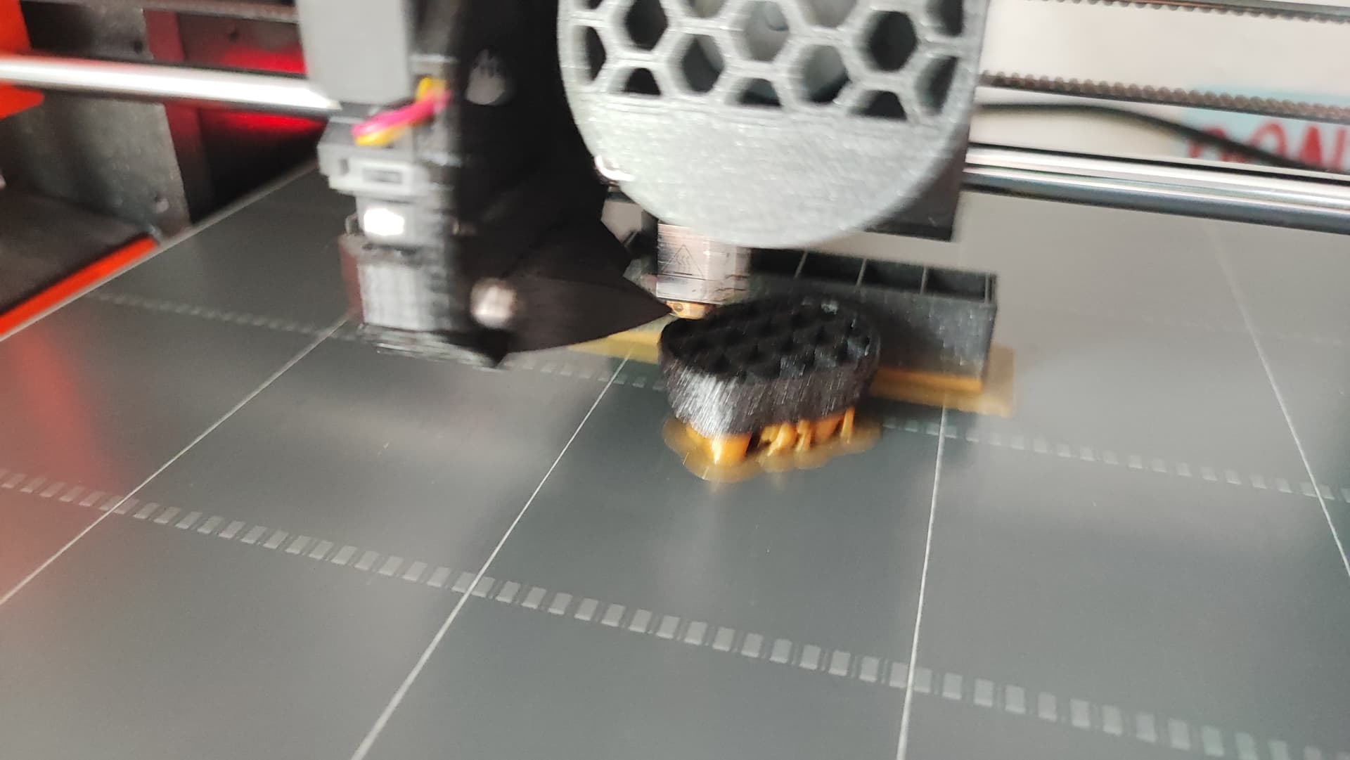

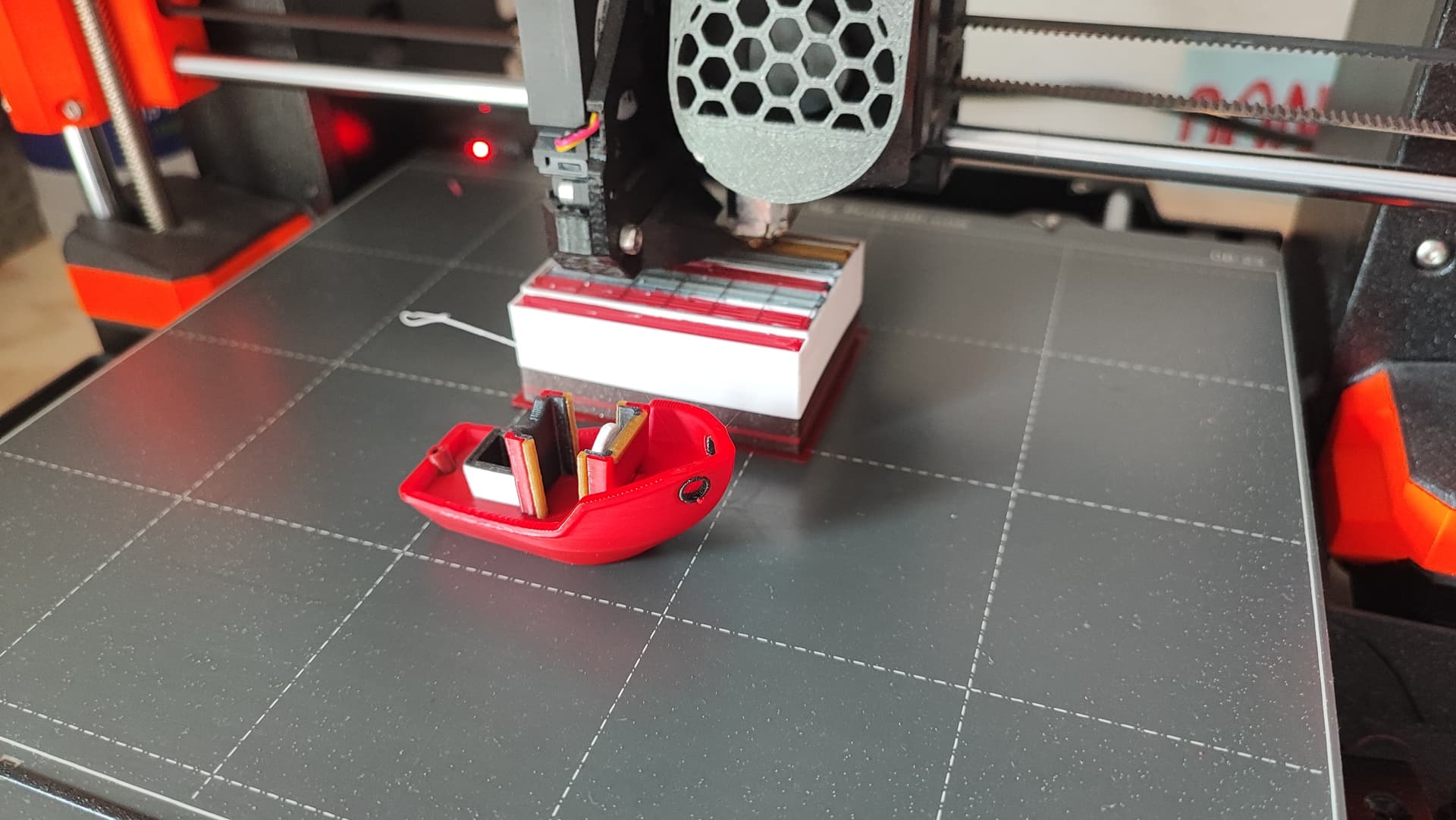

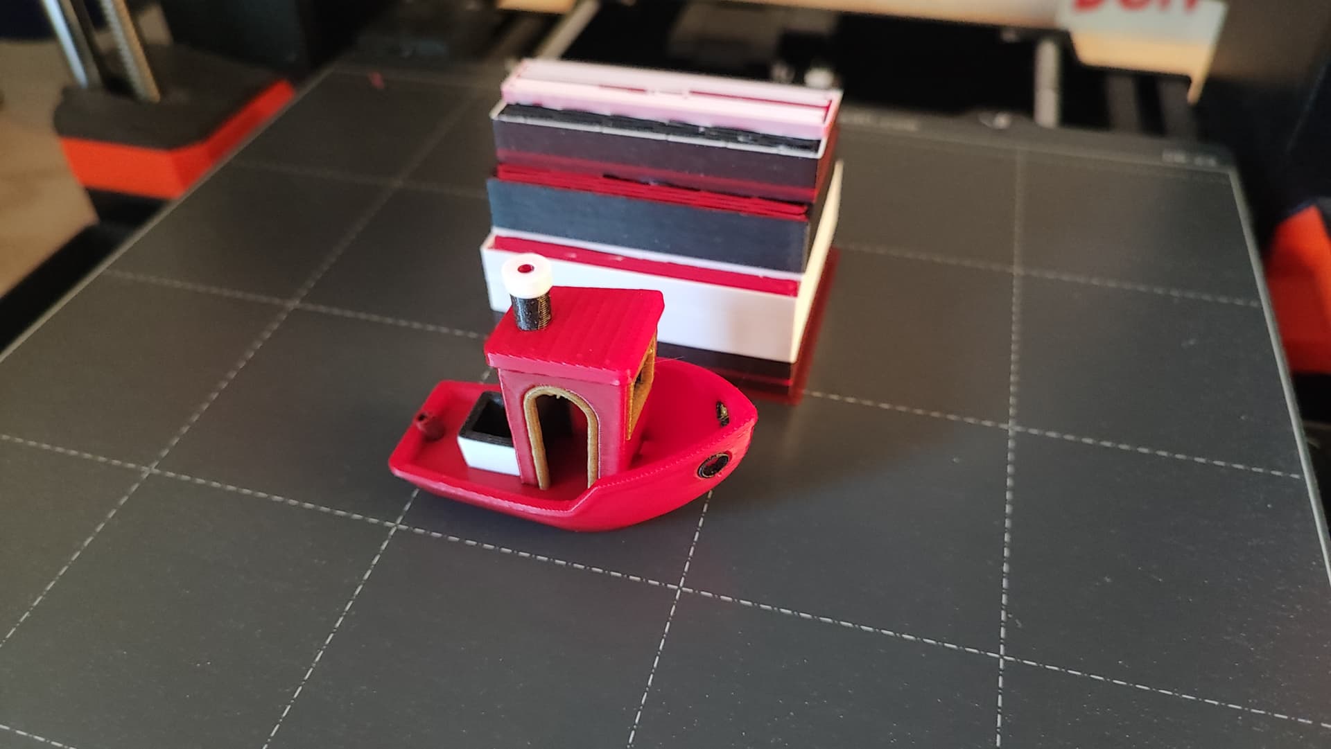

Getting somewhere. 50 cent Benchy, 3€ wipe tower… :smile: 2.5 hours to go, all in all around 500 colour changes. My drybox buffers are doing okay, but not brilliantly. Might need to use the original one after all. Boo!

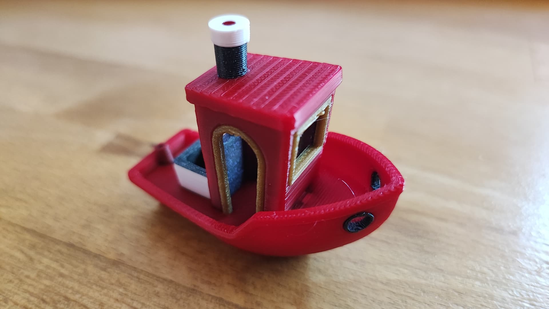

Done. I am really surprised it all worked so well. :smile: Five colours, blue and black are really similar, though. :sweat_smile:
Surprised by the size of the purge tower! They say Prusa’s purge waste is much less than Bambu, wonder how much filament the Bambu would use for the same print.
To be fair, at some points of the cabin the colour is being changed four times for just tiny dots of colour, you can see it in the post above. I made sure to include as many changes as possible, 510 in total.
Screenshot (353)
Besides, I think I would always try to activate the wipe into object and put print plates together that can utilize that. Depending on the time. Hmm, all so new. Now I gotta figure out a TPU profile… :stuck_out_tongue:
