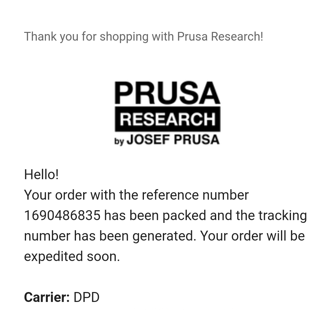

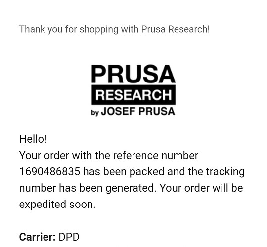

WoopWoop, it’s MMU time. :slightly_smiling_face:
I’m jeaalous! Please let us know how it works! I’m tempted… but I don’t have the space. (atm…)
Will take a week to arrive. But I will surely keep you posted! :slight_smile:
