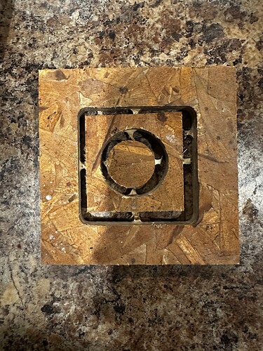

SUCCESS! I got some cuts done. Nothing special or fancy. Just wanted to see if my core and braces issues were settled and they seem to be! No grinding/rubbing/binding. Smooooooth!
The one thing is the dimensions are wrong. They are off by about 1mil in some measurements. All undersized. The cuts are also not square on the diagonal which makes sense because I have not squared the machine with M666. Its just “close” with careful measuring when setting up my temporary table. I assume that not square could account for undersized measurements?
I did measure my bit. 2 flute up cut bit. 1/4in and measured about 6.2mm. Using estlcam with just a part cut. No finishing pass. This was in 1/2 osb. Running 20mm/sec feedrate and 3mm DOC. Im not terrible worried about it at the moment as I haven’t done extensive squaring yet. More so curious if that could be the case or if I need to look elsewhere as well.
Thanks!
It looks to me like the holding tabs have broken in a couple of places, and the cut out pieces have shifted.
OSB isn’t terribly strong when thin, so you might have better success with plywood, MDF, solid wood, or thicker tabs.
I second trying again with bigger tabs to make sure it isn’t a movement issue.
Also make sure you do a full depth finishing pass if you are taking measurements under 1mm.
Sorry I should have clarified. I broke the tabs after. In the picture they are free but they all held while cutting. I suppose it still could have deflected?
So if the part was supposed to be 120mm square. But I’m reading 119 ± .5. The finishing pass addition would mean it cuts it to 121mm and then the 1mm finishing makes it 120mm?
