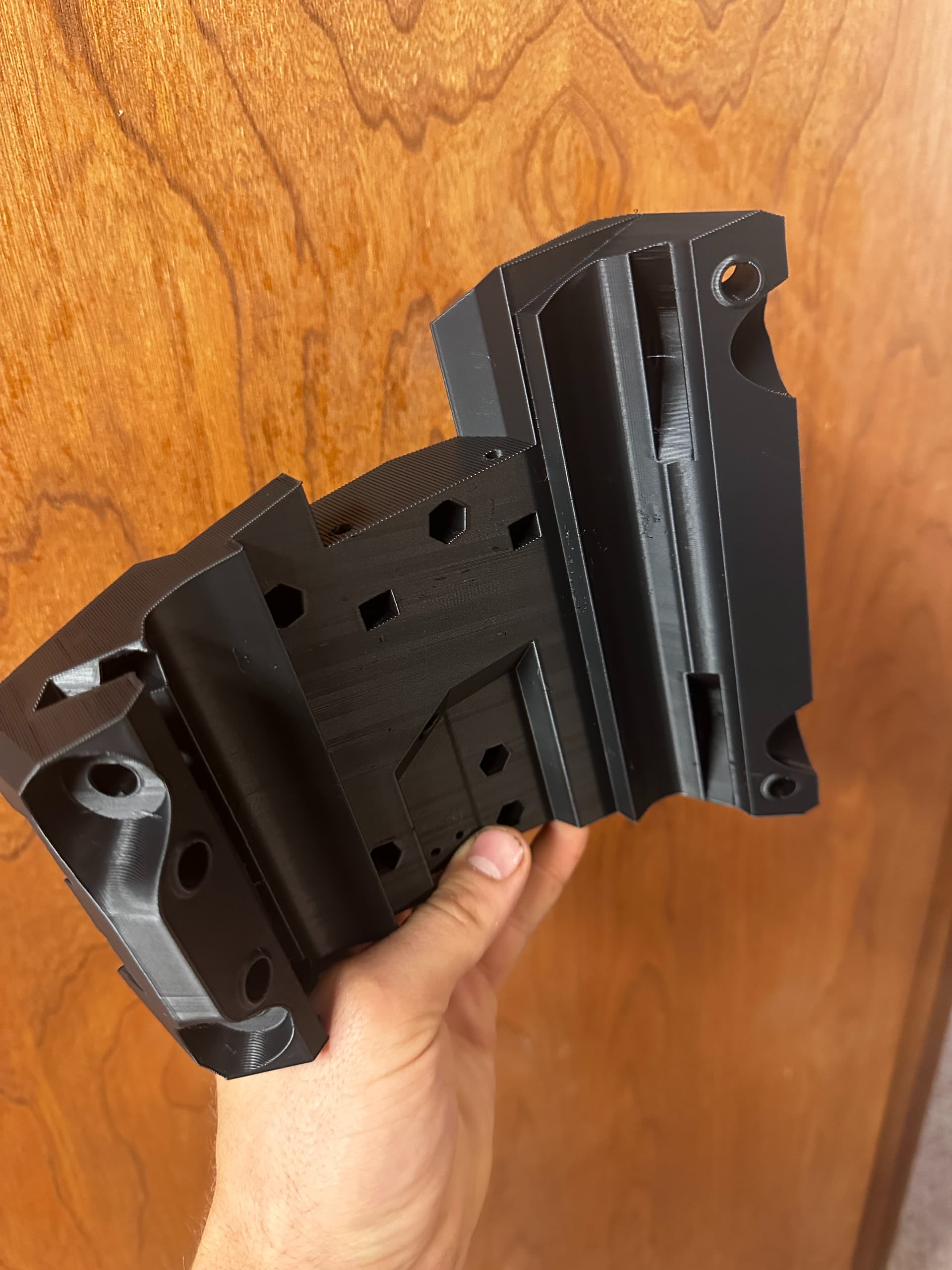

I built a Primo several years ago. Went quite well, got my feet wet and got me hungry for more. Now I am going for a full sheet low rider. I didn’t do a build log on my Primo build, but I have come to realize I really enjoy browsing the forums so I thought I better add to the content rather than just take!
I did go a little lazy on the color scheme. Its all black. Crazy. I know. I am going to add some some parts in an orange to give it some flair I think though. Although this Sunlu Matte Black is quickly one of my favorite colors to print with. Some parts are done. Just started the core. Hopefully all goes well tonight.

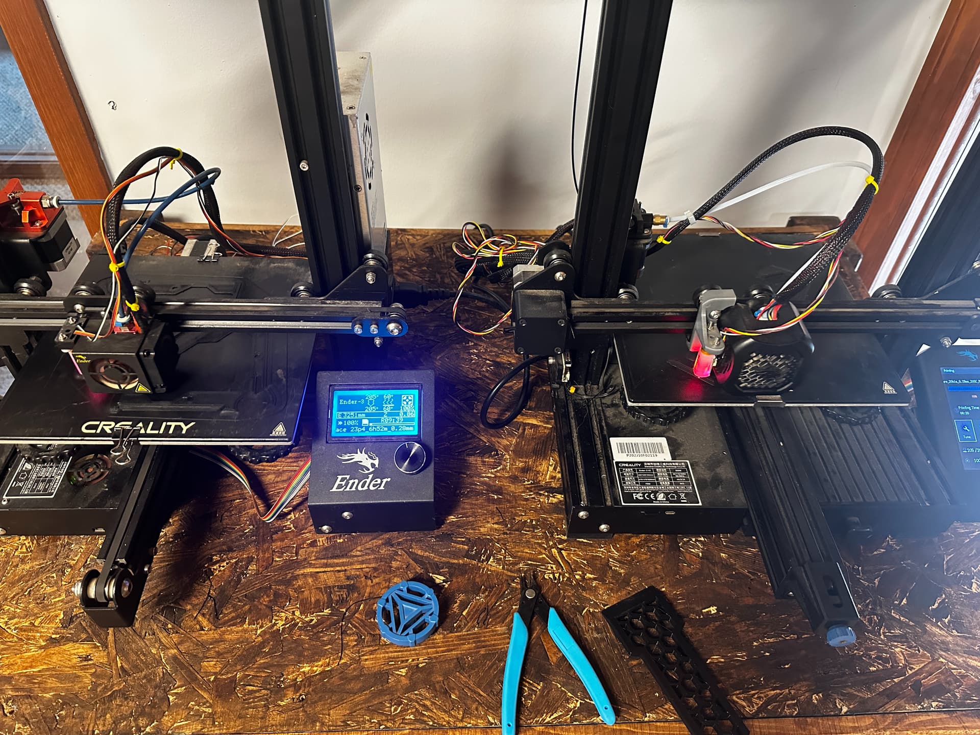

Somehow I am still doing all of the printing on Ender 3’s. Im hoping to upgrade those in the very near future. I have proven to myself I will be printing for a long long time to come so I think its valid to upgrade at this point. Not sure what to do with my Enders though. Sell? Voron upgrade? Something completely off the wall?

Parts are looking good. The LR3 is an amazing machine! Have done a lot with my 2!!

You should see mine right now. Going with the “get it done” mindset. Using a bunch of scrap colors to reprint some things that broke. One day I’ll have the nack to make it fancy!

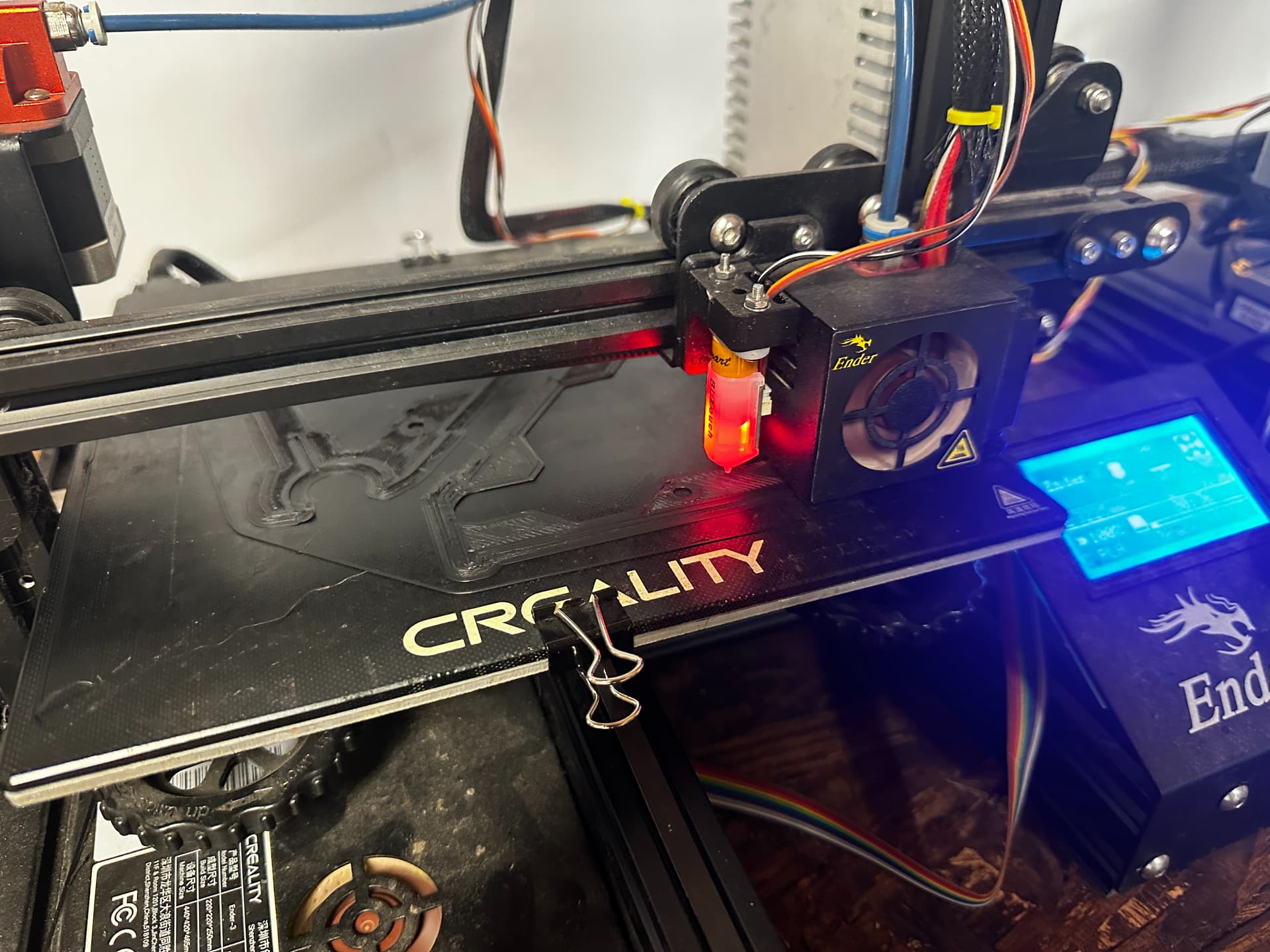

I mean for an Ender 3V2 that I have had for years, its hard to argue. I’ve still convinced myself I’m allowed to upgrade but shesh. One shot, over night, looking pretty good if you ask me.
