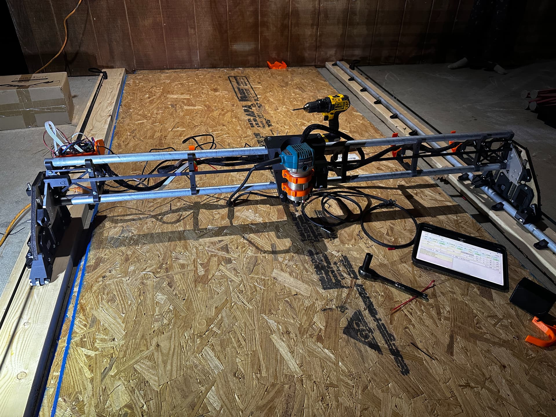

So close! Going to try and button up tonight to be ready to square and cut the struts. The best deal ended up being 1/4 plywood. Its underlayment I believe but is really high quality stuff. Hopefully it works out well.
That what I have, has worked great for me so far. Be aware though. Not all 1/4” plywood is 6.35mm
I just went and checked with calipers. its showing about 5.5mm. Seems like an odd size but at least its not to thick.

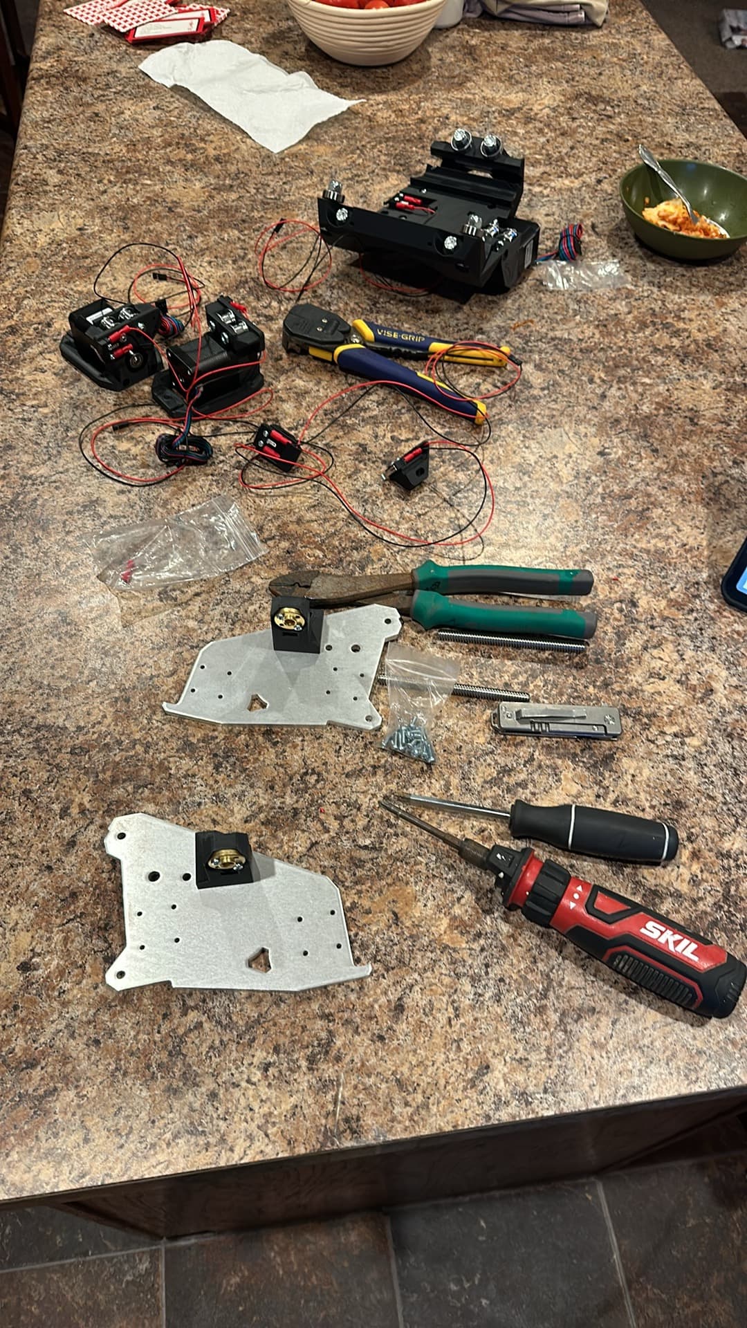

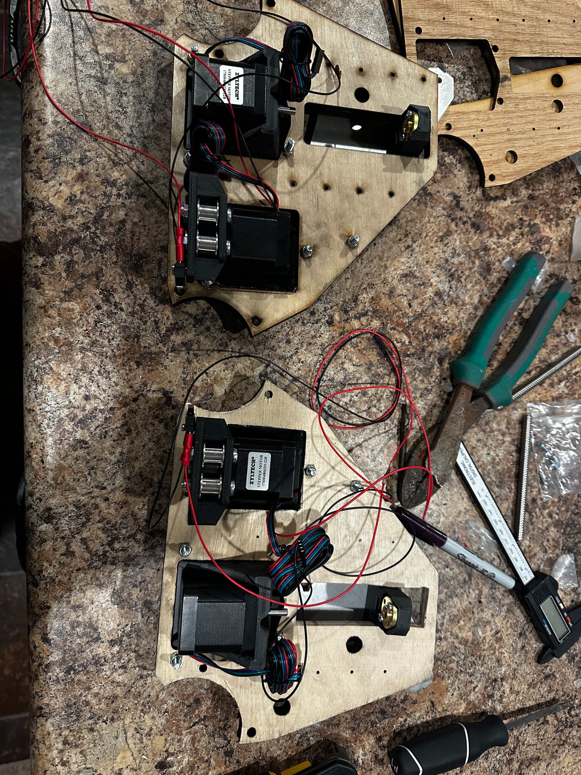

Took awhile to get these right. Not so slick with endstops. 3 of the 5 didn’t have signal. I guess I didn’t crimp very well so had to redo those. But now they work. But then I didn’t put them in right so I couldn’t figure out why it wouldn’t stop the y axis. Helps if they’re in the right spot.

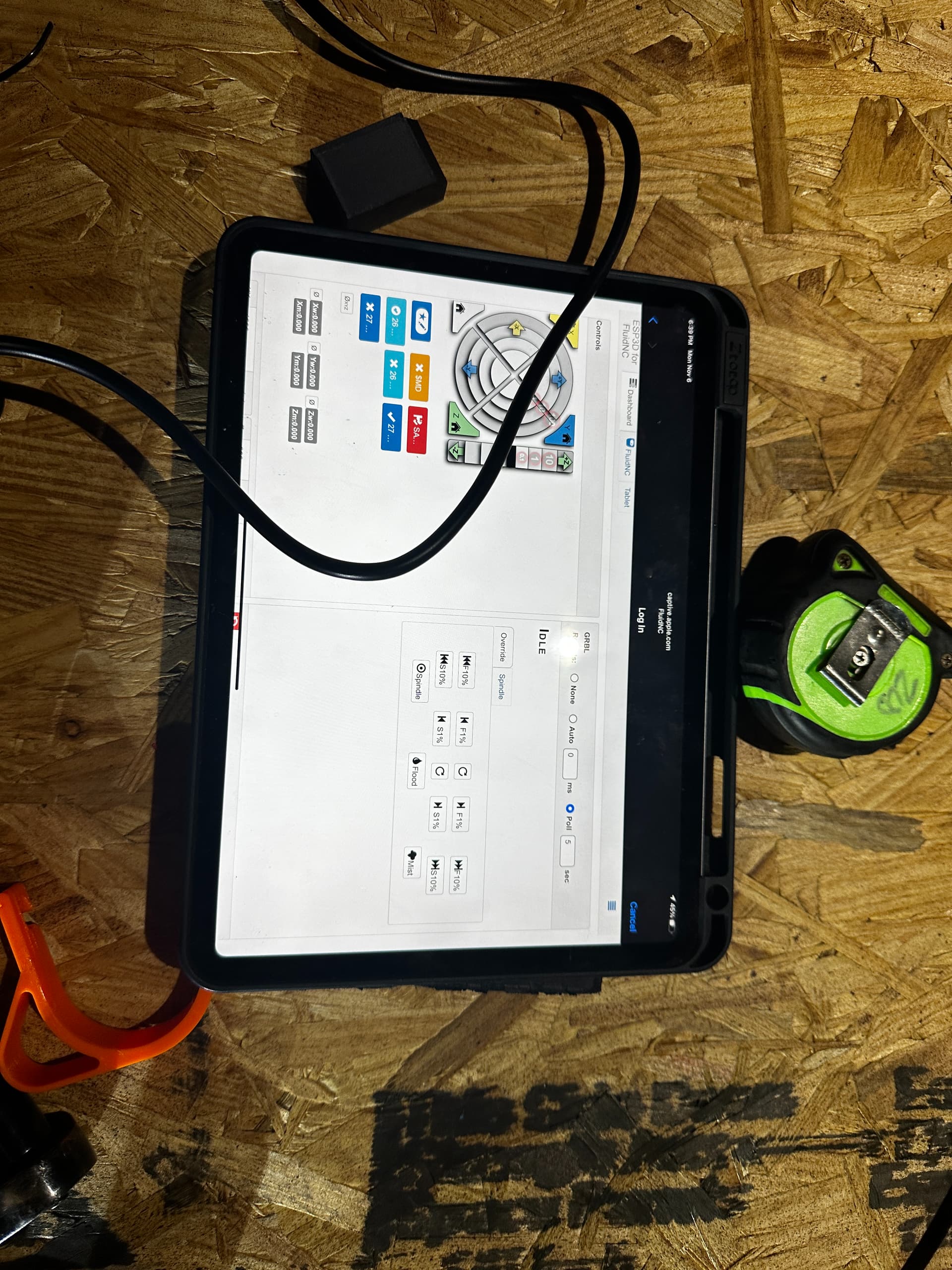

REALLY happy I went with the jackpot. Having everything on an iPad is dope.

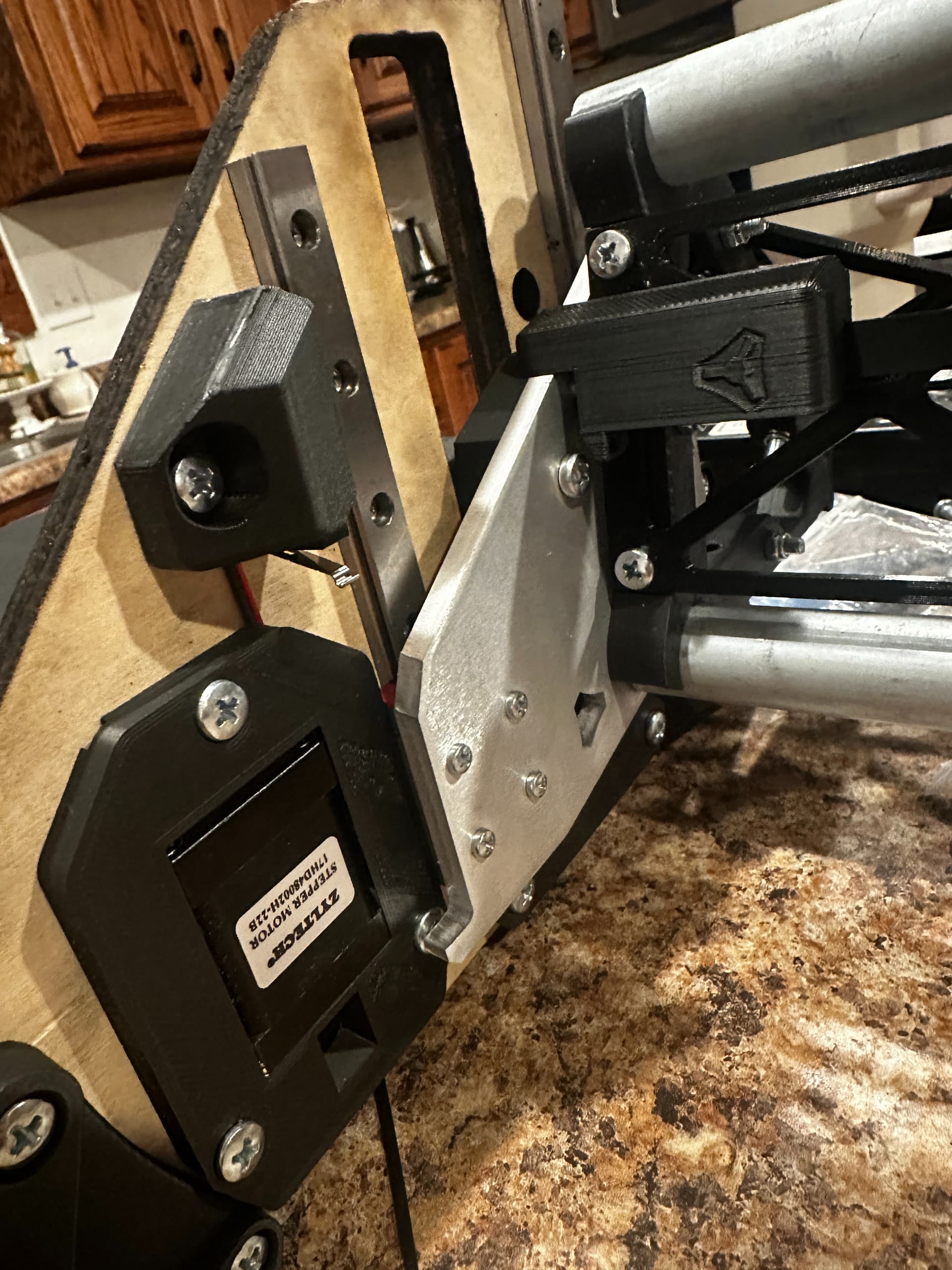

Finally. I was moving it around working on squaring. (still a little confused on how to fix square. Im with .75 in at the moment.) But I noticed play in the Core. Did it print wrong? Seems like all the bearings are pretty tight. It moves freely. No noise or anything but this kind of movement seems like it would have an effect on the cut. Any Ideas?
https://imgur.com/a/p09xQQo link to the movement.
When you say the bearings are tight, do you mean the axle bolts, or the bearings themselves (do they spin freely, or is there a little bit of drag). The bottom bearings in particular need to be adjusted so that there is just a tiny bit of drag, then loosen just a smidge. - if they spin too freely then that might mean that the core can flop around.
After having used the tft screen to probe 30+ point on my spoilboard. Can confirm some form (jackpot/Pi/Repeiter) of wireless connectivity is superb. Not required but superb

Those are the two bearings on the bottom of the core most visible. The angle shown is taken from the top down. You cant see the “captured” bearings well but I tried to spin them and seems like they are pretty free to spin as well. In that video you can see how much bolt is through the nut. I was worried about cracking the core as I thought I had read about that a couple times. I guess I’ll go tighter.
Edit - It’s the “visible (not captured)” bearings that perform the tension adjustment
I’ll definitely tighten those down then. Seemed like I was going to break something long before it got tight. Ill crank em down in the morning and see what happens.
