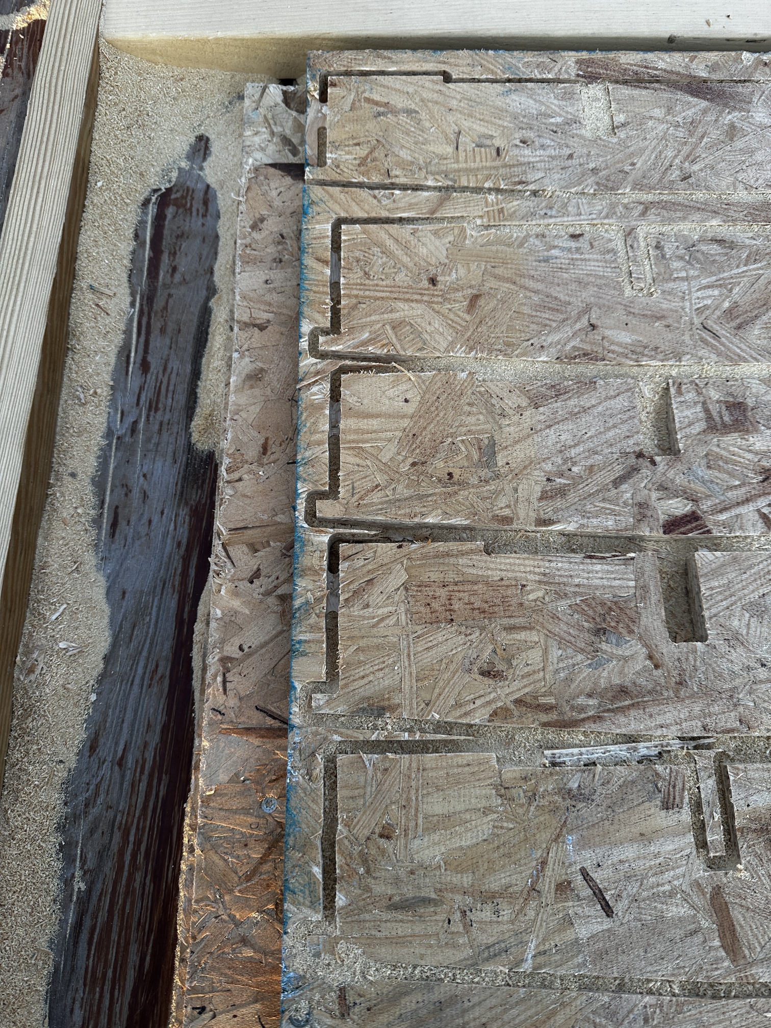

Hey everyone. I’m back after a hiatus. Working on cutting @DougJoseph parametric table so that I can finally finalize my final build. Lol
Running into two things.
#1 I’ve got this weird lead in issue. And I don’t know why it’s happening. I have a 30degree lead in and a plunge of 10mm/s. Seems to only do it on the lead in. There is a tab there as well but I don’t know. It’s not the same on every lead in. 1/4 in up cut bit running 4.5mm doc and 30mm/s if memory serves me.
#2 one side of my z axis almost “hops” on the way down only. Going up is smooth. No binding. But going down I guess maybe it would be called binding and therefore hopping? Any ideas on what to check?
Thanks in advance!
Happy to be cutting again at least!
Hmm. I don’t know. Maybe back off a bit on speed or depth of cut? Maybe it’s balking at hard spots in the material?
Ironically I stole the feeds and speeds I saw in one of your videos but toned down a bit. Only other thing I cant think of is maybe my work holding is a little lacking and its pulling the bit into the work enough?
The weird thing is that it only really does it in that spot. When it plunges again for a tab for instance a long the long straight edge it seems completely straight.
