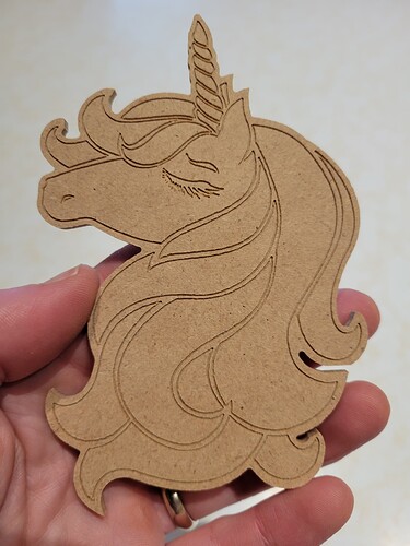

#3 - Unicorn
As a girl dad, my life is unicorns and rainbows. This was the first time I did a tool change. The outside was cut with an 1/8" endmill with a 1/16" endmill for a finishing pass (since the 1/8 was too big for a few spots) in 1/8 inch hardboard. The lines were engraved at 0.5mm deep with a 45 degree V bit.
Vector - Free FREE Unicorn SVG | Manadala Unicorn SVG Cut File for Cricut, Cameo Silhouette – Caluya Design
Great work and congrats on some perfect tool changes!
