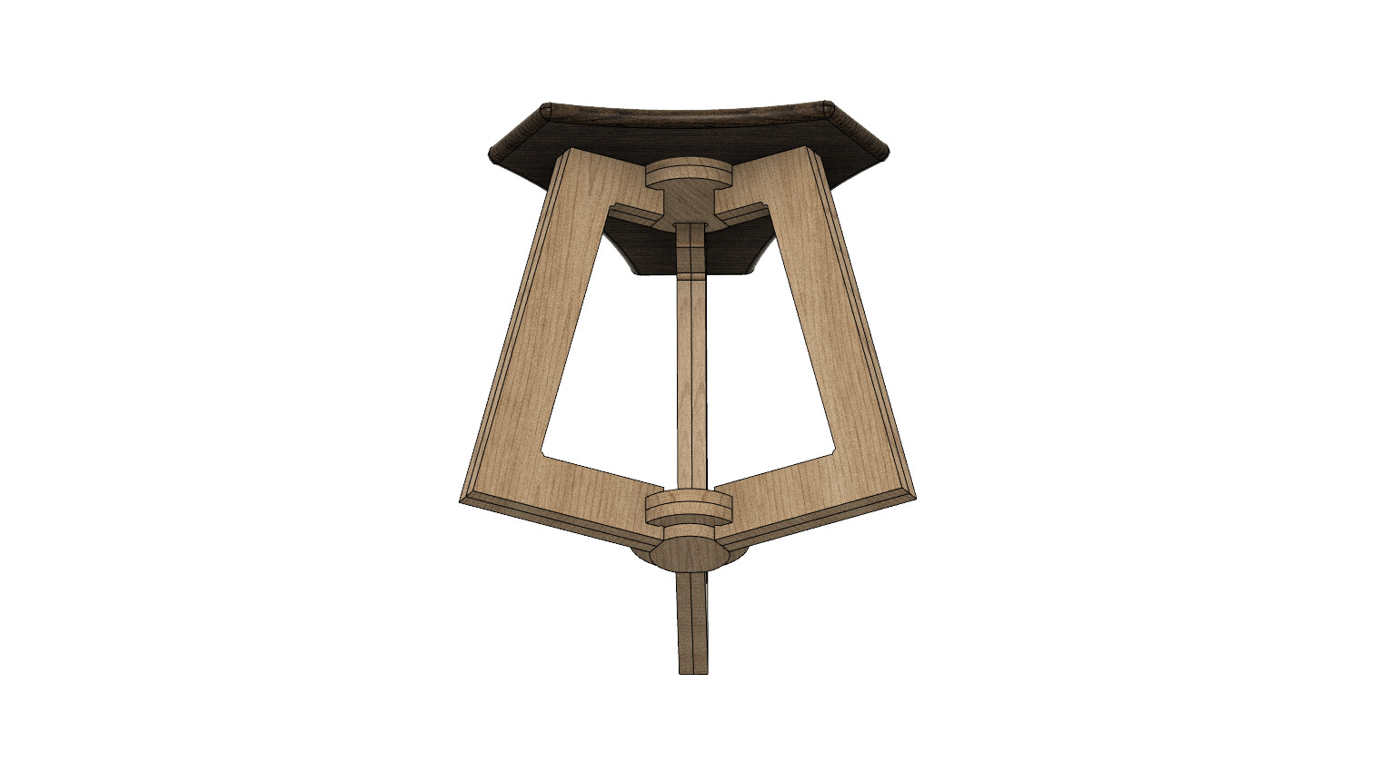

Not sure how CNC-able those legs are. Also not sure the bottom of the legs are wide enough for good stability. If you make them go out further, they might need additional support.

I agree with everything you mentioned. That was a quick and dirty rendering that I whipped up on the iPad while laying in bed to get a basic idea out there and the proportions are definitely wrong. My cnc table top sits 32” (800 mm) off the floor and I want to be able to roll up to it and work comfortably. Just off the top of my head, I think I want a 20-24” (500-600 mm) seat height including casters and probably a seat and leg diameter of 18-22” (450-550 mm) to fit that idea.

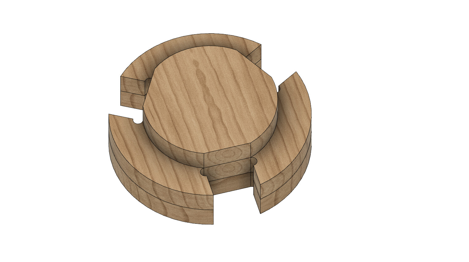

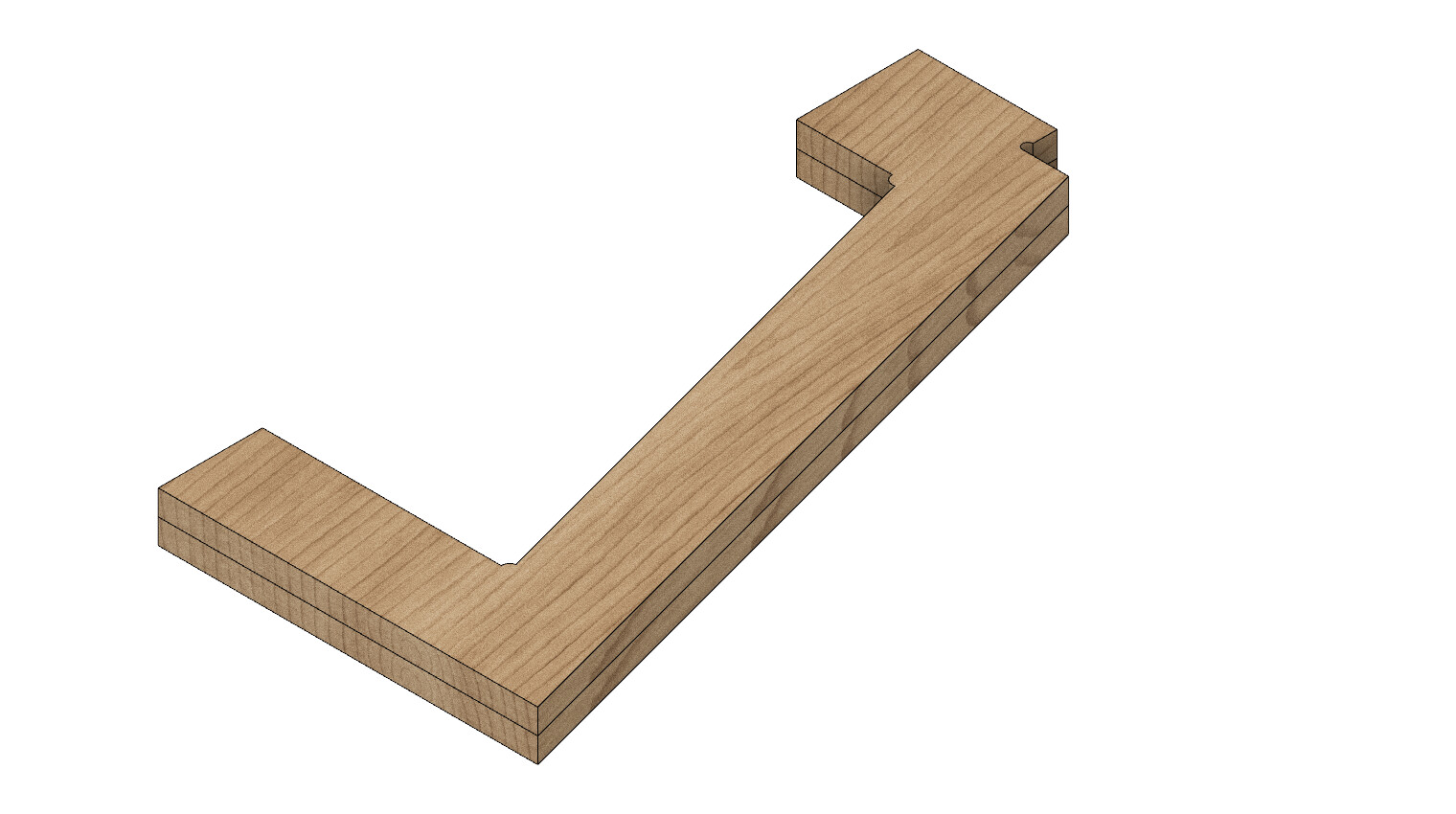

My plan on each of the legs was to cnc a 2 piece glued castle-ish joint that would then slot up into the seat flush with the seat surface. I’m debating changing the circular central column to something more fitting for a cnc as well while still maintaining the v1 aesthetic and a strong core. I’m a big guy, so I think the legs may require a second layer for thickness below the seat to add strength.

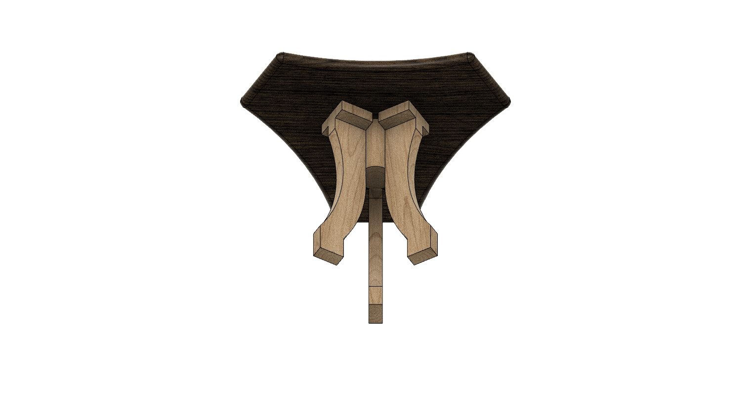

Alright, went with something a little less curvy and a little more geometric that I’m fairly certain will hold up over time, yet keeps with the v1 aesthetic and can be cut on the CNC. I threw in some Fusion 360 files in case anyone wants to look more closely or modify.
